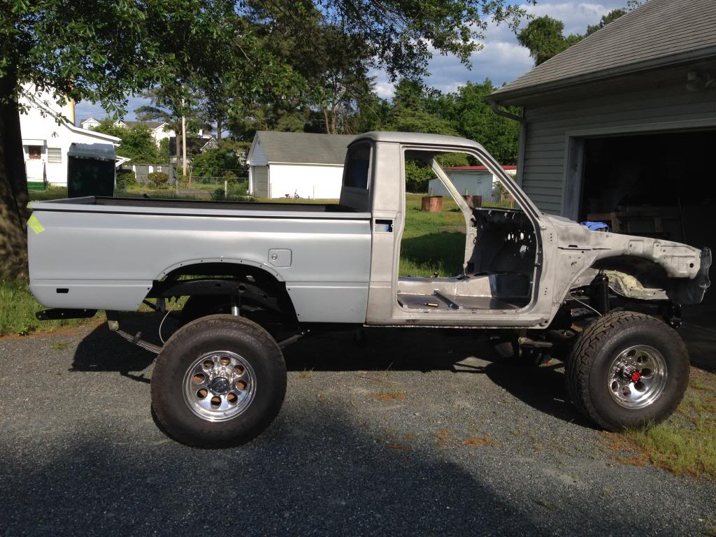

I know I don't have the fenders on in the photo below, but this should give you an idea of how much clearance you'll have with the OME lift. I have 31x10.5 tires under OME springs with +2" shackles and I have more than enough clearance - I may even drop down to +1" or stock length shackles:
33x12.5 tires should fit with no problem on a OME lift with no modifications. Moving the axle forward isn't going to do much for you as OME springs are for stock hanger and axle locations. I would recommend installing the springs on your stock shackle and hanger locations to see what you have first and then go from there if you don't have enough clearance.
