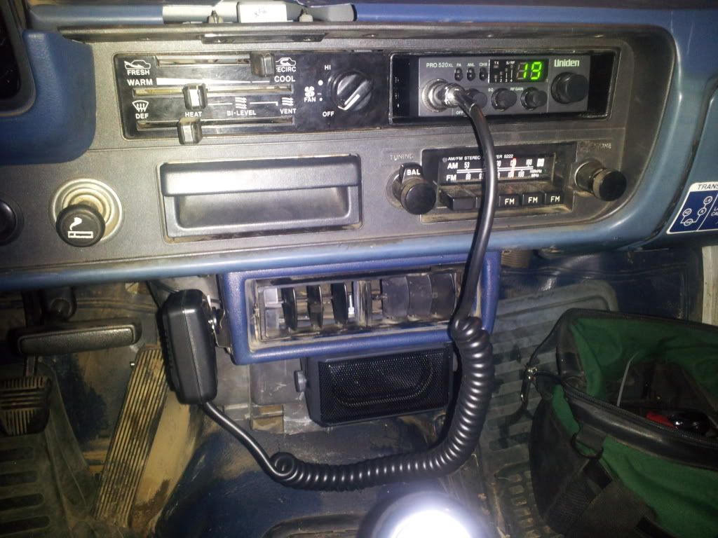

This is what I am running right now:
Its a Uniden 40-chanel radio with a hookup for a P.A. system. So far its a good little radio and Amazon has it for $55
Amazon.com: Uniden PRO520XL 40-Channel CB Radio: Car Electronics Amazon.com: Uniden PRO520XL 40-Channel CB Radio: Car Electronics

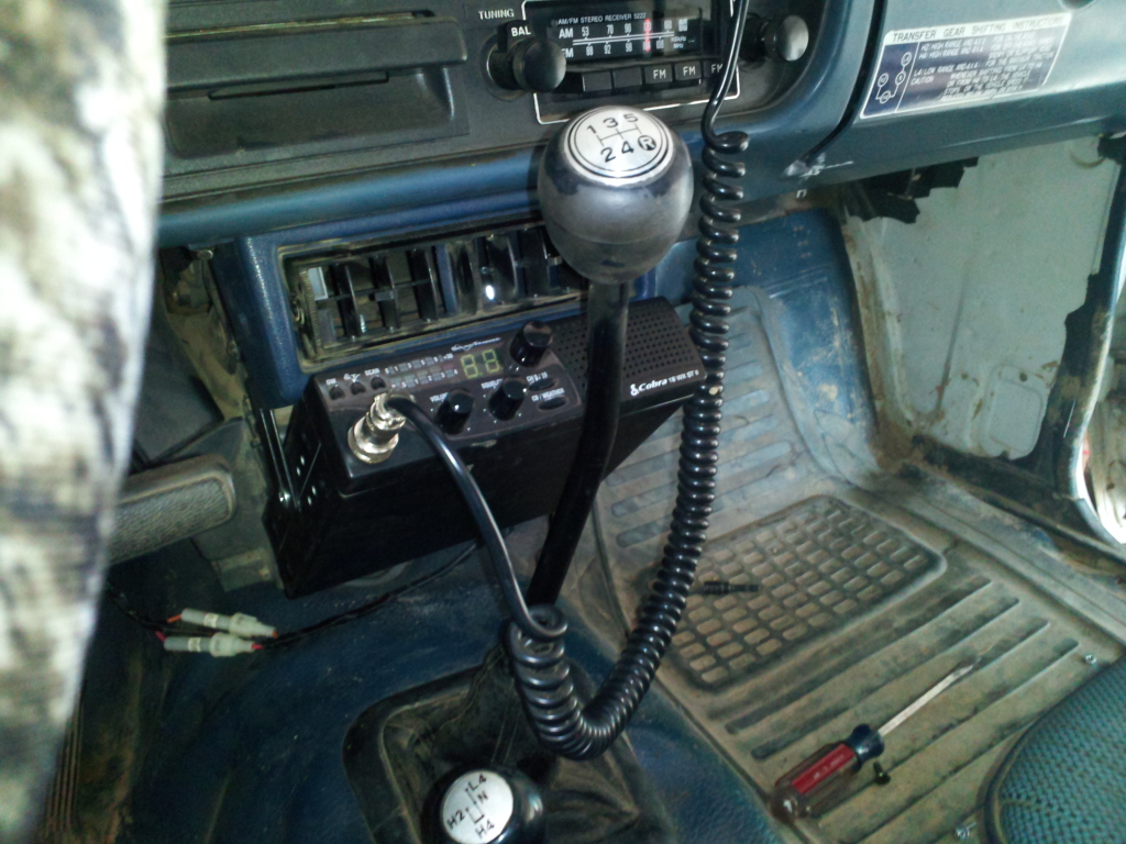

I also used to run a Cobra 40-channel with a weather band. Was also a good radio. In my opinion I would stick with a Cobra or a Uniden, they both make good radios.

You can get them from a simple radio up to a really fancy model. Its really your choice and Amazon is a great place to look all of them. Just make sure to get one with a knob to control RF gain. This helps to protect your radio against others who have an illegally modified high output radio.
As far as a cable to run in between the radio and antenna DO NOT BE CHEAP ON THIS. You will get what you pay for. Most places have these cheap black skinny cables. Yes they work but I would spend the extra to get a high grade cable. I run a K40 brand cable, its extra thick and weatherproof.
Now for an antenna I prefer a Firestik. Its a nice solid (not very flexible) antenna that is top loaded. That means the winding is at the top of the antenna to try and get it above the tallest part of the truck. They make a bottom leaded antenna (usually looks a canister mounted around the bottom) but they typically need to be mounted on top of a vehicle for best performance. I have also had one of these that was a whip style and it was a good antenna but the chrome on it rusted in less than a year so I went back a Firestik which won't rust.
They last thing I am going to ramble about is tuning the cb/antenna setup for maximum potential. You can either have a cb that is non adjustable and an adjustable antenna in which you adjust the tip on the antenna (changes the radio wavelength) to match up with the radio. However this requires a SWR tuner to do this. This is what I have right now. The other option is to get a higher end radio that has a built in SWR adjustment and it requires no special tuners. Its fairly simple to do. If you ever get into that I can help if you need it.
Hopefully I didn't overwhelm you with all this. Me and my friends have been running cb's for about 10 years so we got pretty good at it lol. Hope this helped.
