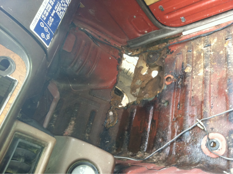

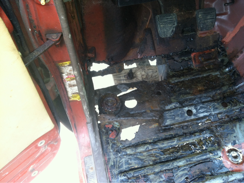

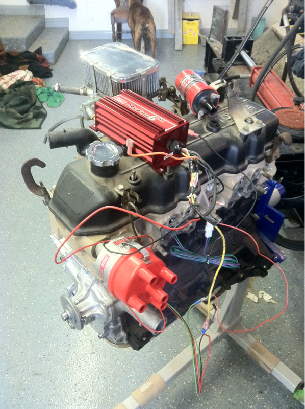

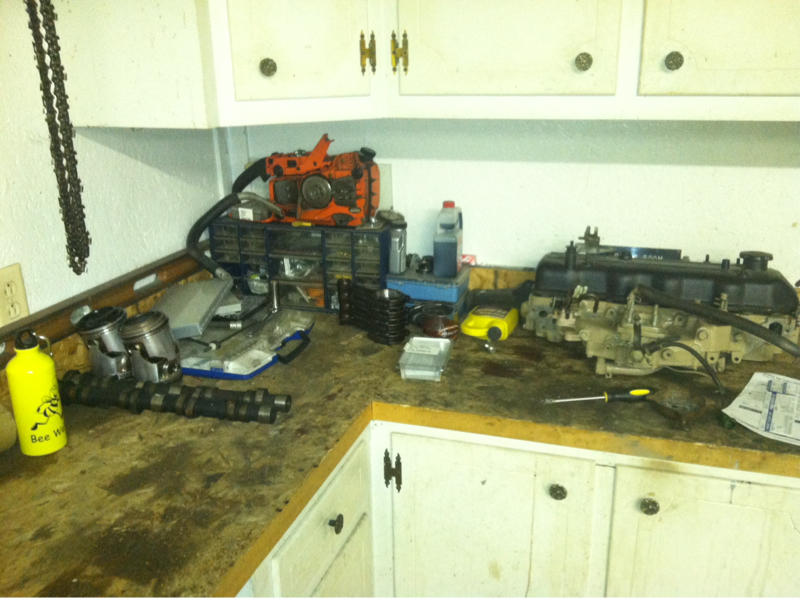

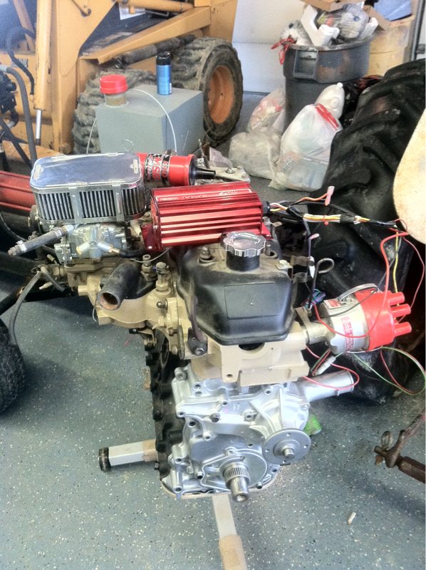

So I'm building an 83 long bed I have a innovations full length cage for a 4runner with a 79-83 main hoop dash bar and 12 body to frame supports Ingnition i have a mallory unilite a mallory hyfire 6al box an MSD red blaster coil a unilite filter and a resister As for the engine 83 22R bored to 92.5 scat h beam rods wiseco forged pistons 83 std crank head has been ported polished o/s stainless valves a lc pro torker cam + guides ect. A lc dual row timing set a lc timing gear All aluminum radiator All aluminum fuel cell 19 gal I will be getting fiberglass fenders and bed sides Any suggestions would be most appreciated

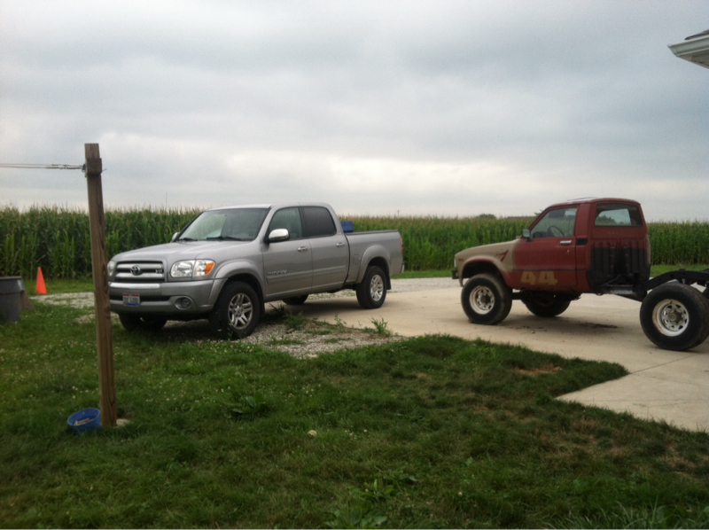

Your driveway looks like mine: Silver 2005 Tundra DC and a 1983 Pickup. If your wife has a 2008 Camry too, then I think you could be my long lost twin brother...

Other than that love my tundra I don't see any tractors or equipment in your pics

So I did a comp test today I'm at 11.2 ta 1 so either a new head needs to be found or mass piston work I have $1,800 to work with I was going to use it for rear cromo axles 5.29s and trail gear 4" rear kit but now I need to figure out what to do
I have so much time in the port job
Old Feb 17, 2014 | 02:52 PM
CamTom12's Avatar
Joined: May 2008
Posts: 523
11.2 should be fine on high-octane... The more important number is DCR. What's your cam put your DCR at? If I remember right, 9.5:1 is as high as you can go on pump gas.
