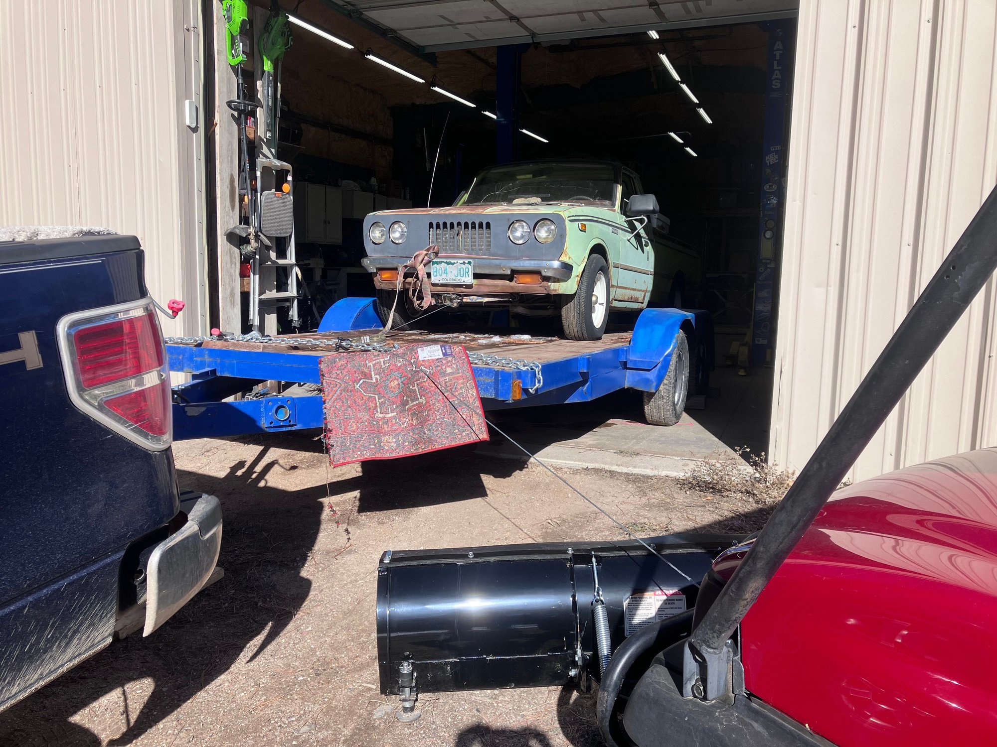

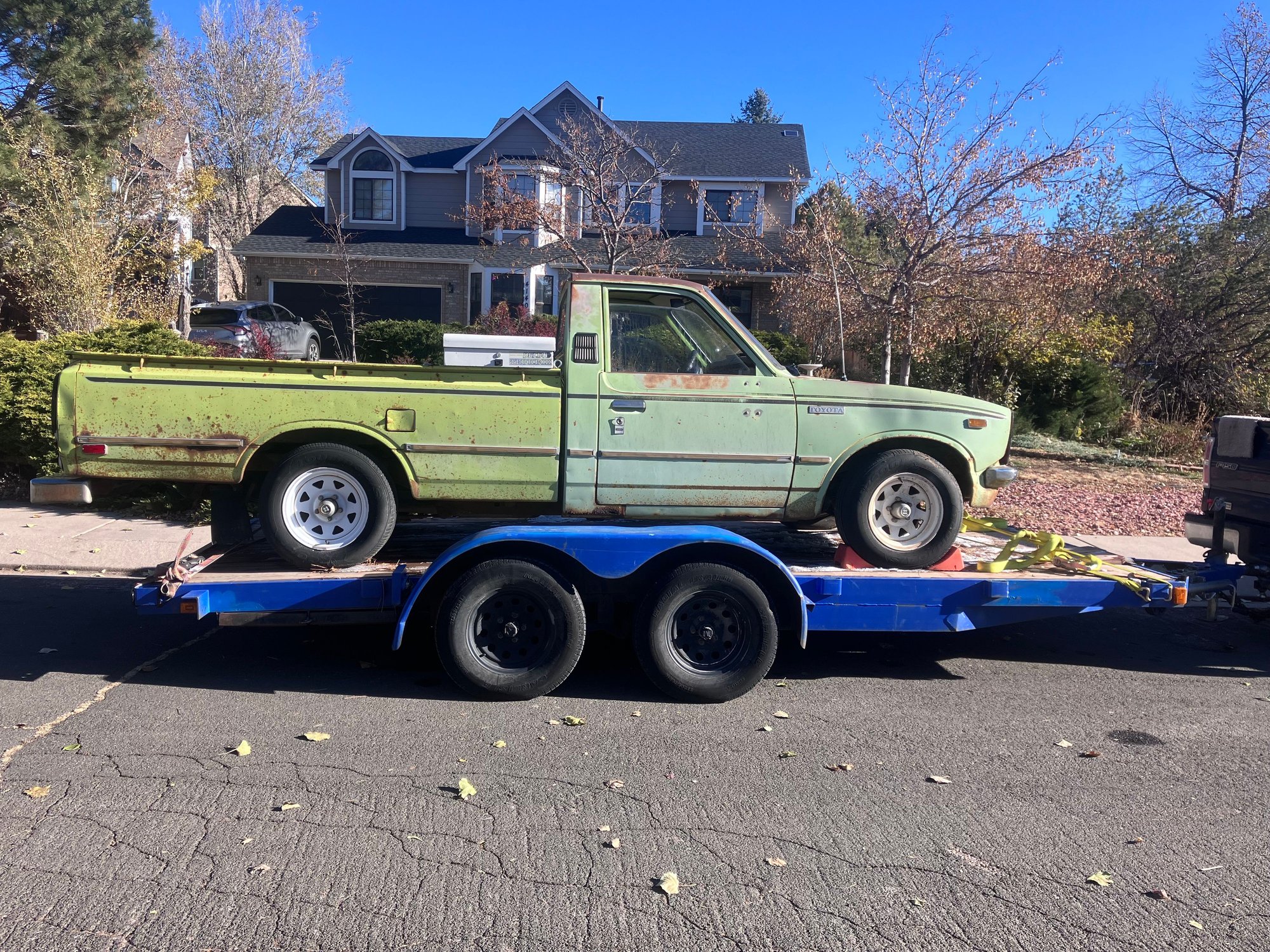

Howdy folks, picked up this classic as a nostalgia play. I had a '72 in high school as my first car. You never forget your first. :upsidedown:
I was specifically looking for a '78 because that's the year I was born, also, cars with four round headlights across the front are the best.
Found this one local to me and got it from a lady that remembered it as her first car in HS as well. Her dad owned it all the way back to '83 so was in the family a long time. You'd think that would mean it was in nice shape...nope, poor thing had not be driven in probably a decade and was for sure on it's way to the scrap heap. But with some help from a friend was able to get it loaded on a trailer and back to the shop.

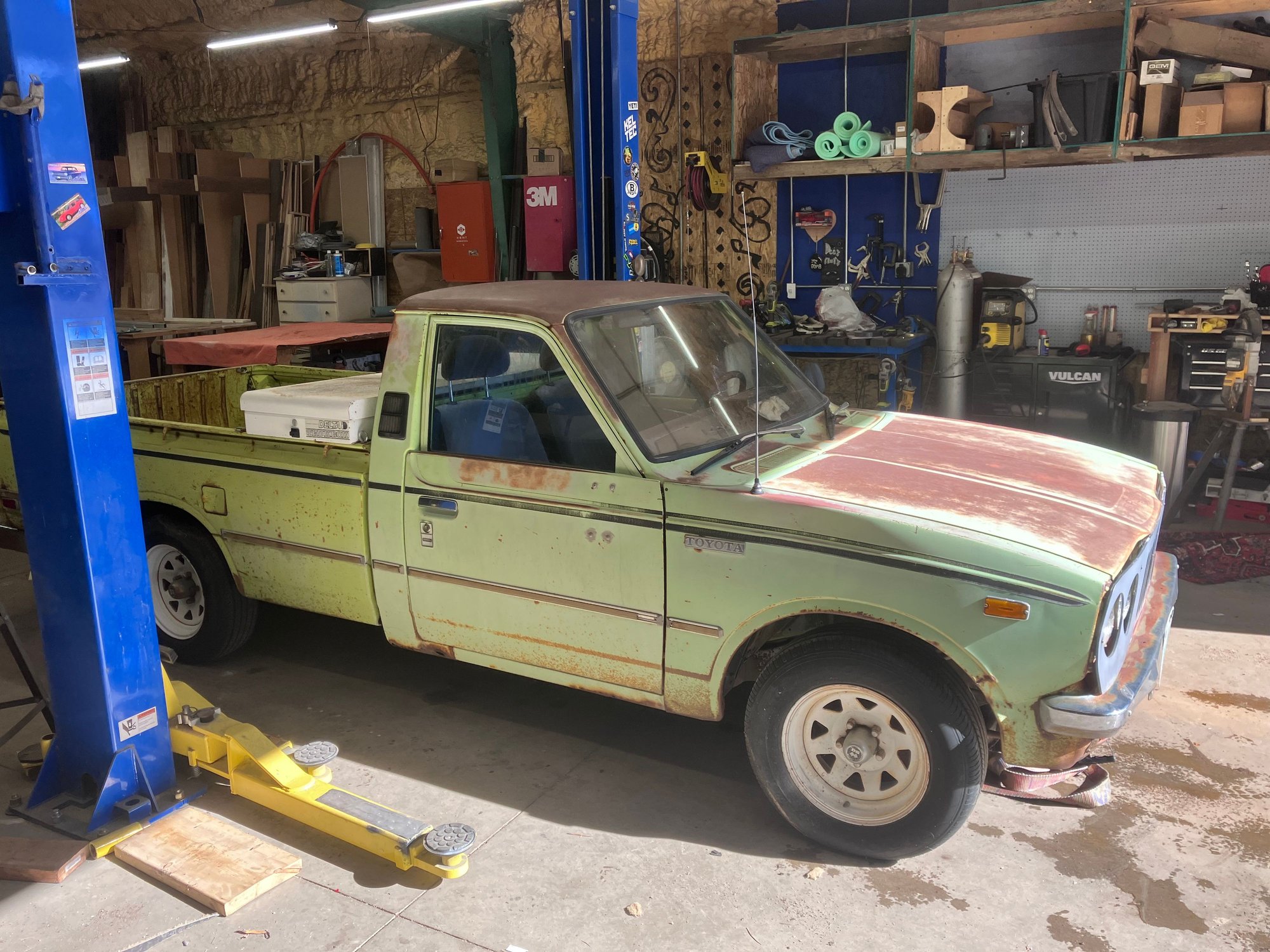

I learned from previous builds that it's just best to rip it all a part and see whatcha got when it's blown up. So wasted no time and tore it down to the basics.

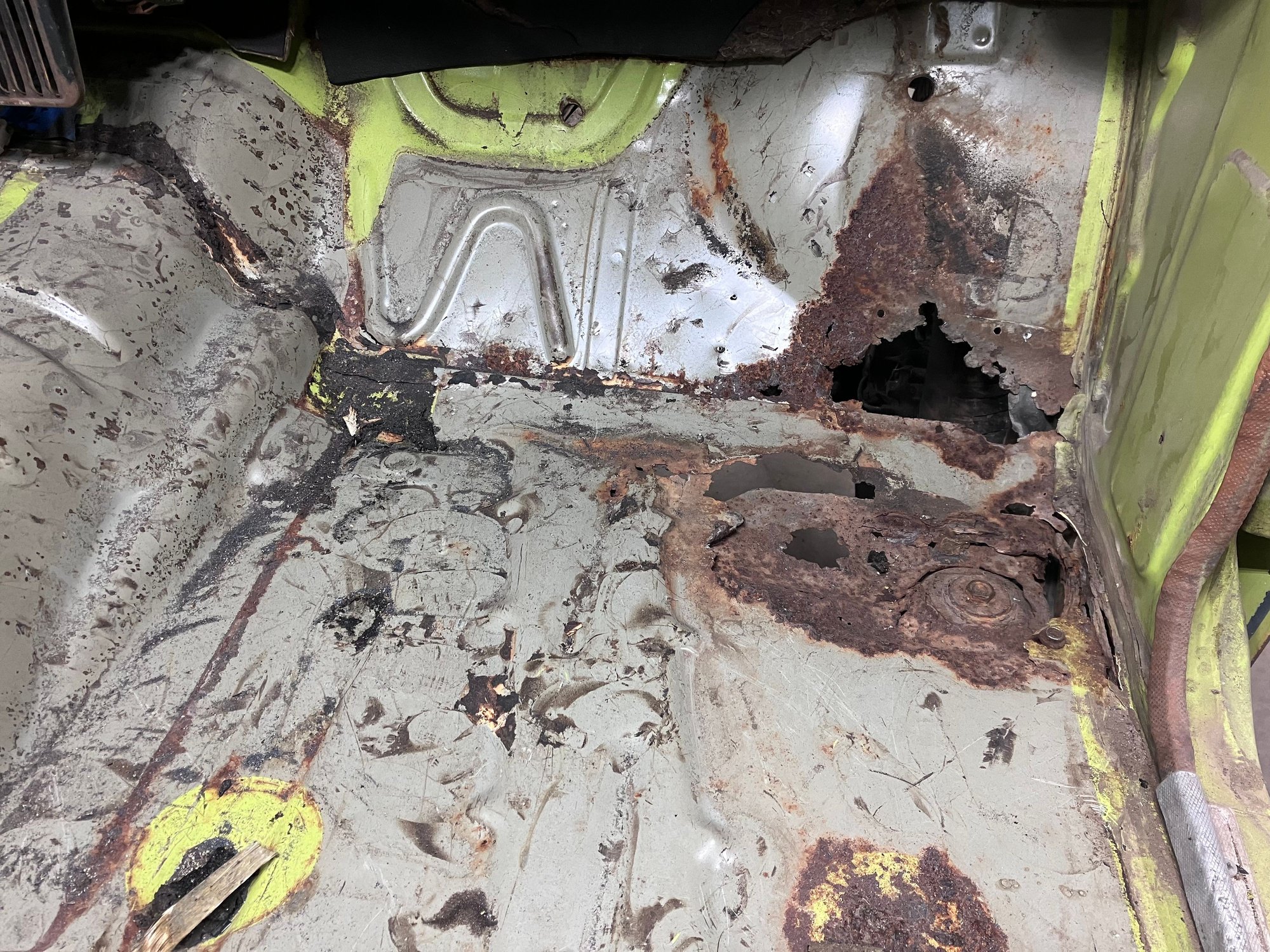

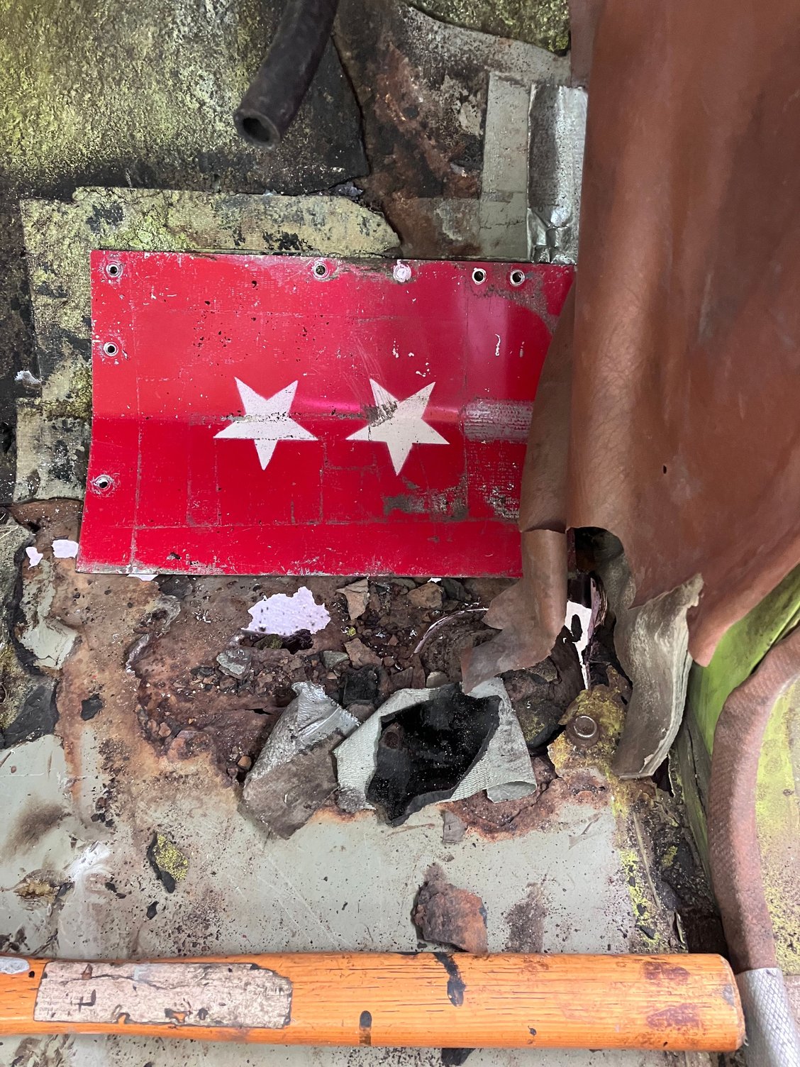

Got some fun souvenirs already. Folks sure do get creative with patch panels. Poor thing probably had two full rolls of duct tape on it.
So yeah, it's a rusty pile for sure but it's mine so I kept on tearing it up.

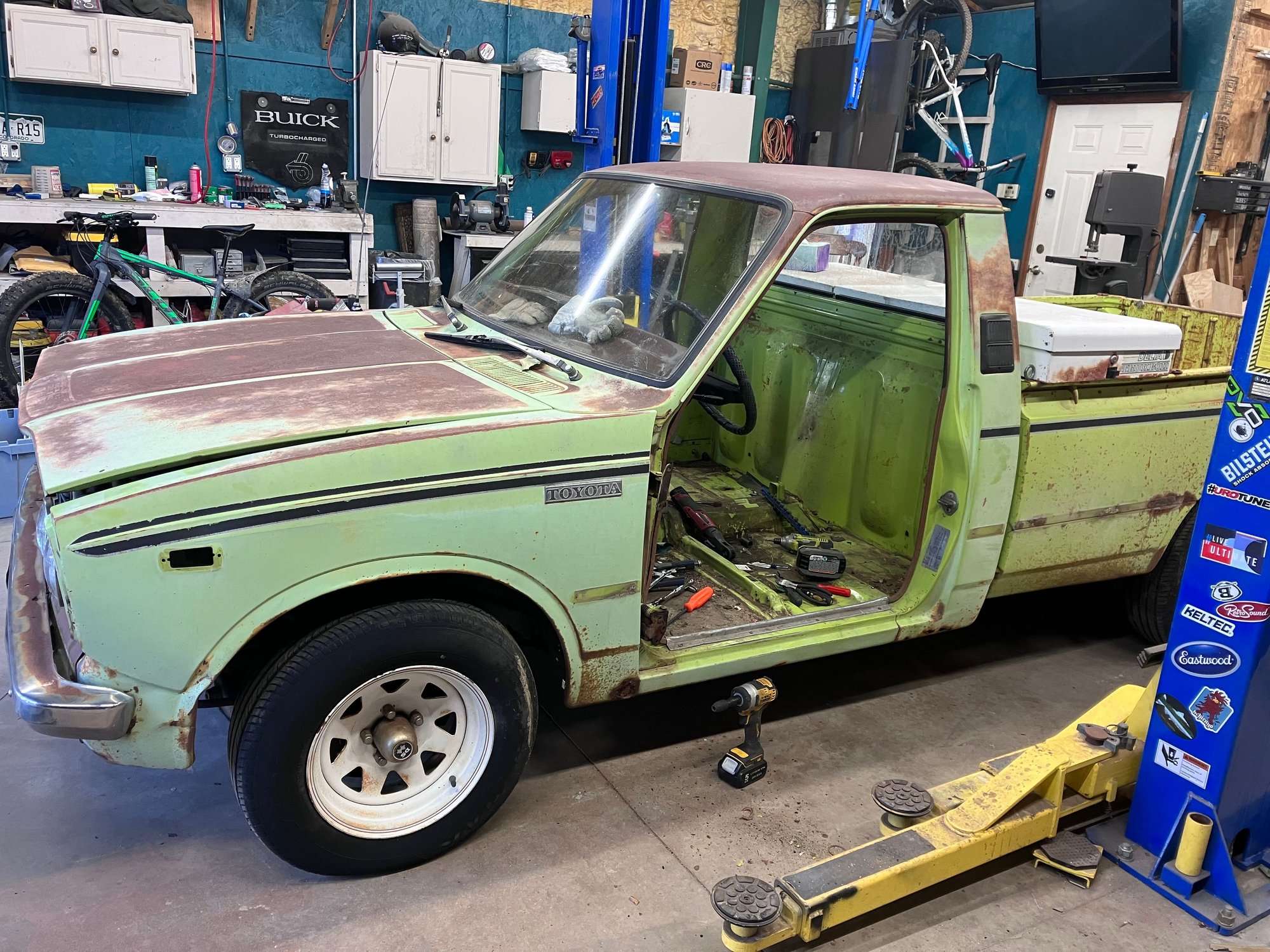

I've made a bunch of progress through the holidays because I took some time off. My day job is a keyboard jockey so in my free time I get as far from computers as I can.
Created a YouTube Playlist of my adventure...don't expect anything high quality. I suck at all the camera stuff and get caught up in working. The first few videos are especially awful. I don't care to edit anything and really only doing the videos because a friend put me up to it. Figure they will be funny to watch a decade from now.
Pretty much everything from when I got it until now has been patching rust. I think I've already laid more weld on the car than it had from factory. But it's been fun, I like the metal fab stuff and it's very rewarding to cut out some rot and be left with some new strong metal.
Plus as a keyboard jockey I like easter eggs. Trying to keep it fun.

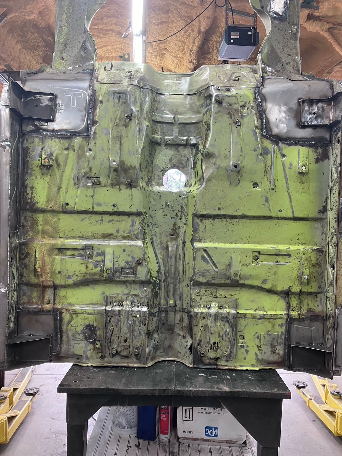

The YouTube playlist will likely see more action than this thread for a bit. So far I've done these patches:
  • Both footwells
  • Both center cab mounts
  • Both core supports
  • Both front cab mounts
  • Both rockers
  • Both cab corners
  • Driver's side front of rocker where the fender mounts
Have had to fab all the panels myself. Tried searching for RN28 patch panels and was really iffy on what is compatible with this '78 long bed. Footwells are fine because they are not visible but rockers and cab corners are tedious since they are seen. But overall it's been going well.

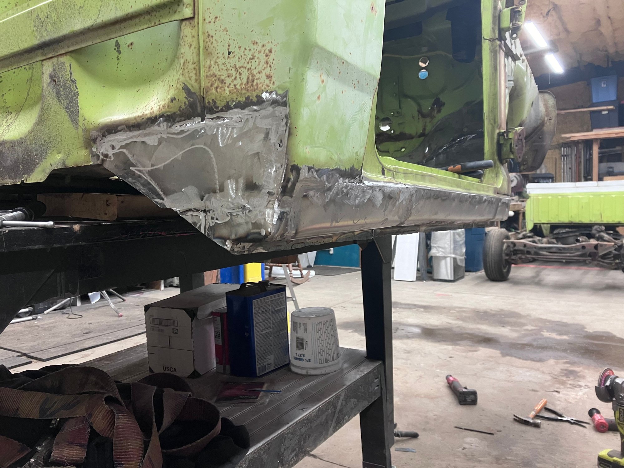

Finished up the passenger side rocker back to front. That makes both sides done which is cool.
Another video added to the playlist in my signature and here's a couple pics:

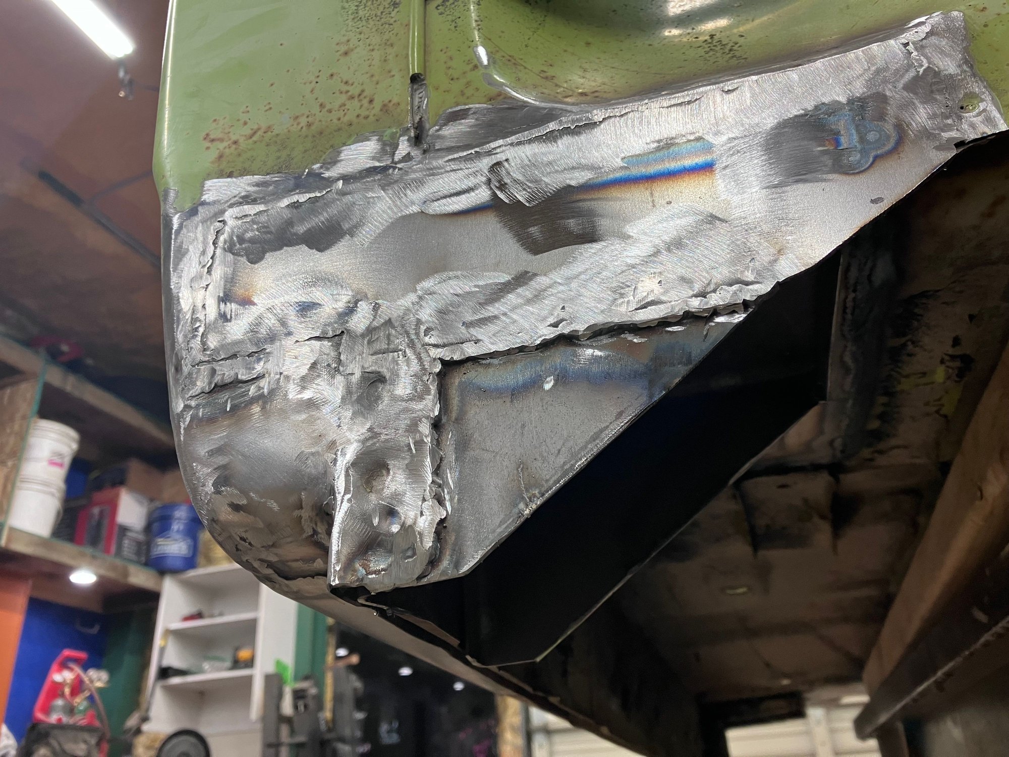

Got the Driver's side all buttoned up:

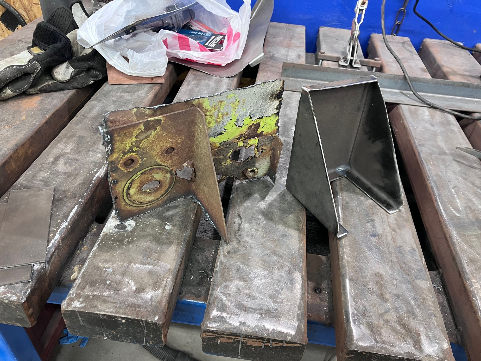

Had to make new brackets for the rear cab mount for both sides:

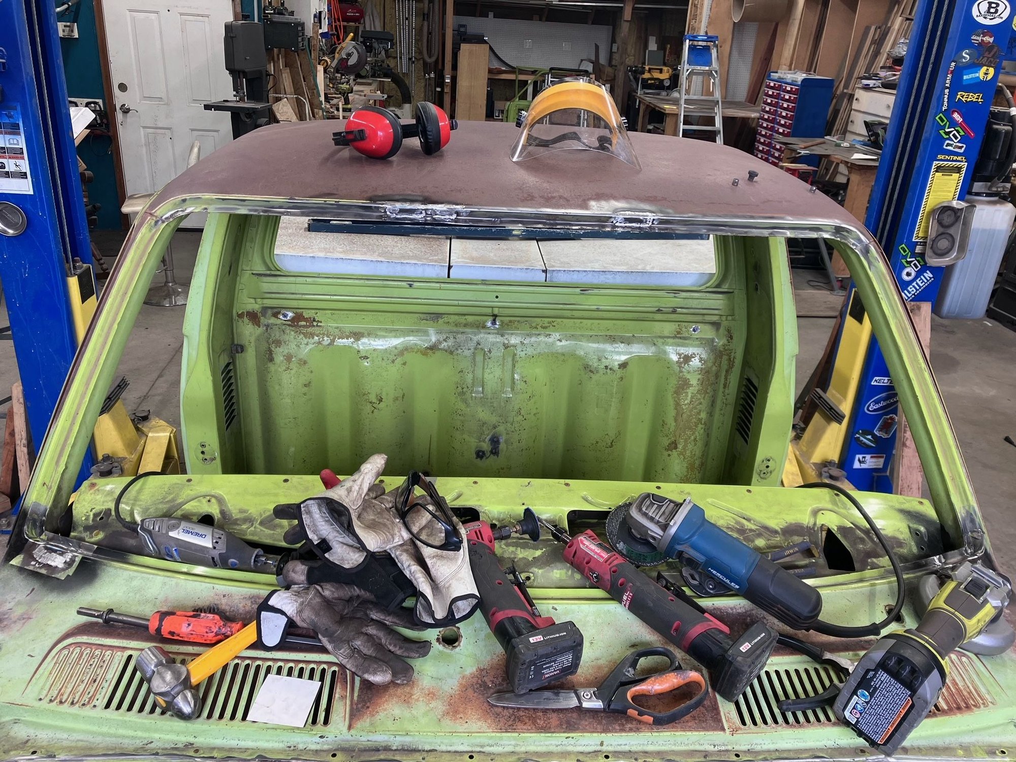

And of course found more rust around the windshield. Hit the whole thing with the wire wheel and ended up needing to do five more little patches. Getting nervous about sending this to blast...seems like every time I look at it I find more rot.

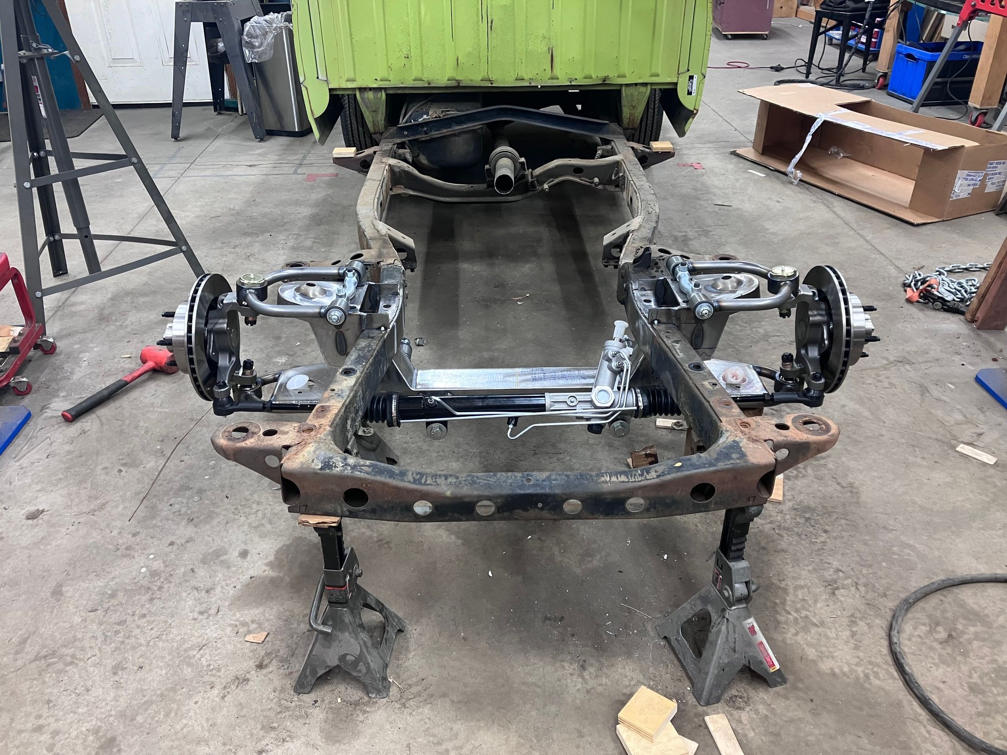

  • 1jz engine trans (plus a ton of $$$ on wiring and ECU stuff)
  • all kinds of other stuff

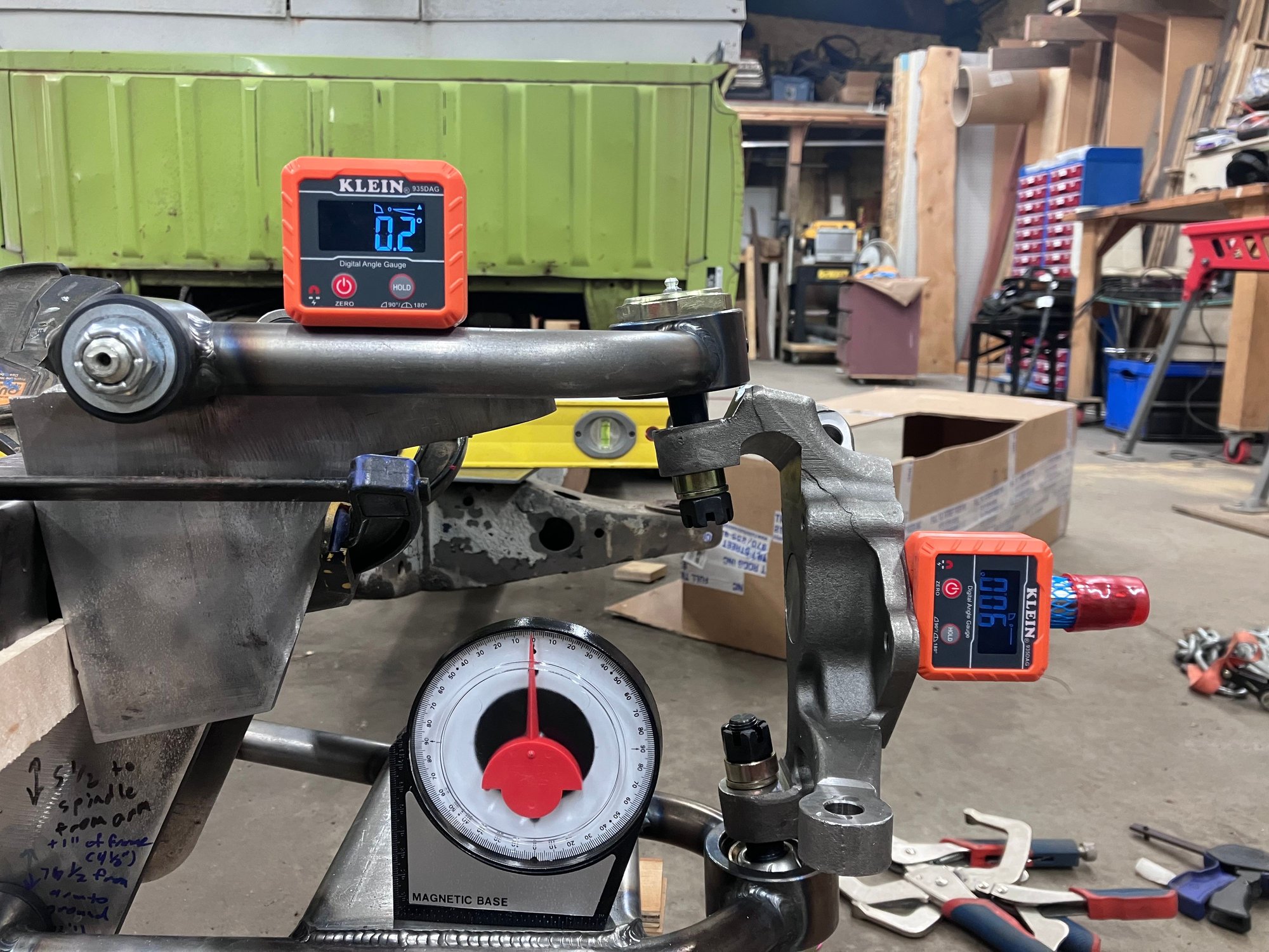

Got the Mustang 2 kit installed, working on such a narrow frame was tricky but satisfied with the results.
Took a bunch of time to square, level, plumb everything but looking good.
