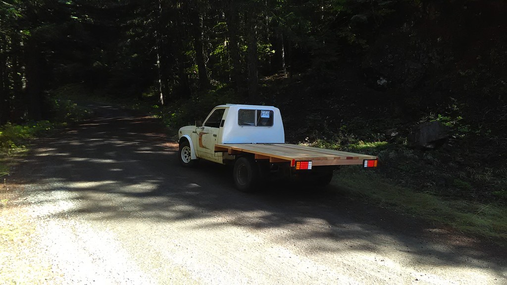

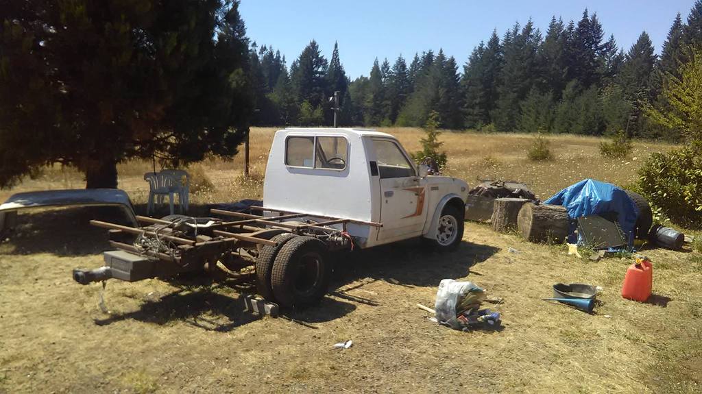

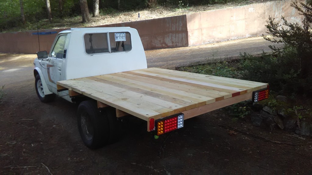

Thought I'd post here to show off my latest project.
This started out life as a 1978 Mirage Motorhome (well, if you want to split hairs it started out as a cab/chassis from toyota which was converted into a motorhome by mirage, but I digress). Me and a buddy picked it up together. The motorhome was pretty well garbage and the clutch slave was out. In addition some mice had taken to building a nest in the carburetor as it had been sitting at least 5 years.
We parted out and then scrapped was what left of the motorhome. Amazingly we were able to get the 20r fired up with little issue. Since we've done a multitude of things including:
Mechanical-
New Clutch Master and Slave Cylinder
Cleaned the entire fuel system, new fuel filter
Desmogged and replaced all the vac lines that were left
New Starter
Body-
Got a temporary solution in place to patch the rear of the cab of the roof
Cleaned and painted the rear frame section
6x8 Flatbed complete with new lighting in the rear
Interior-

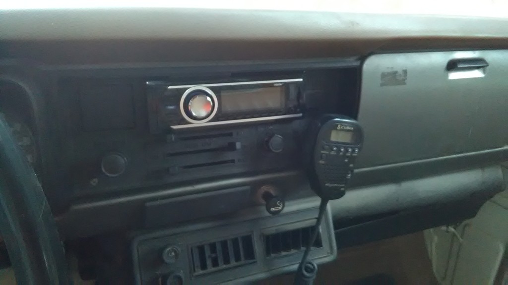

Custom seat out of a ford ranger
FM radio with bluetooth installed
Cobra CB Installed
Future Plans (In order of affordability/likeliehood they will get done)-
New Exhaust
Tires
Something more permanent for the cab
5-speed swap
4x4 Conversion with toyota 4wd front axle and actual dually rear axle
Engine Swap (Depending on other things)
And just a few pics of the progress so far

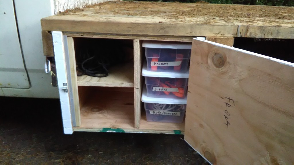

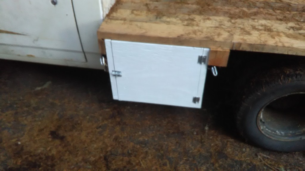

Well not much to report lately as the truck has been running well. Still need to retune the carburetor but I'm holding off until I fix up the cooling system. Right now the truck does not warm up all the way. Guessing either the t-stat is faulty or there is not one in there. Going to replace pretty much everything except the radiator.
In the meantime I did build a couple storage boxes to sit under the flatbed. There is just not enough room behind the seat to store everything so I thought this was a good solution. In the pictures they look a little lower than they actually are- they do not extend below the frame in fact they are about a good 2" above it. Came out good I think.

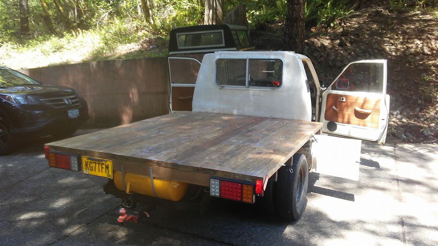

I did add a trailer hitch and modify the bed slightly. I cut it down to only 7'6" long from 8' so the hitch would extend beyond the back. It works much better this way IMO, there is less of the bed behind the last cross support, plus this way I don't have to use a hitch extension. If anybody is curious the hitch is off a 2004 Jeep Liberty and was almost perfect width. I did have to cut off about 3-4" of the hitch part that mounts to the frame as mine only has about 11" behind the leaf spring hangers. Oh and drill the holes in the fame Turned out good I think

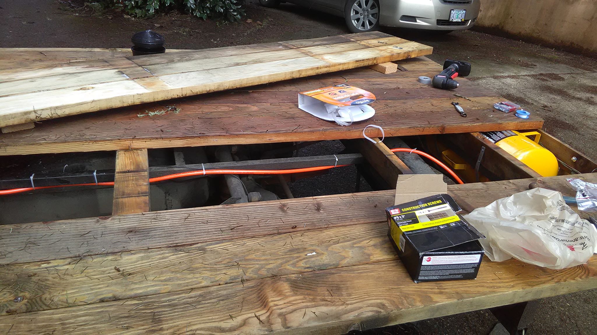

Been a while since I updated this thread but I have been slowly working on the old flatbed.
I added a 10 gallon tank for the OBA. I thought it would fit under the bed opposite of the gas tank, but turns out my eyes are not the best measurement tool So it had to go under the rear of the bed, which is alright, but takes up room I would have liked to put other things (like a spare tire, lol)
Here is how I routed the hose, and a shot of where the tank ended up. I always say work smarter not harder

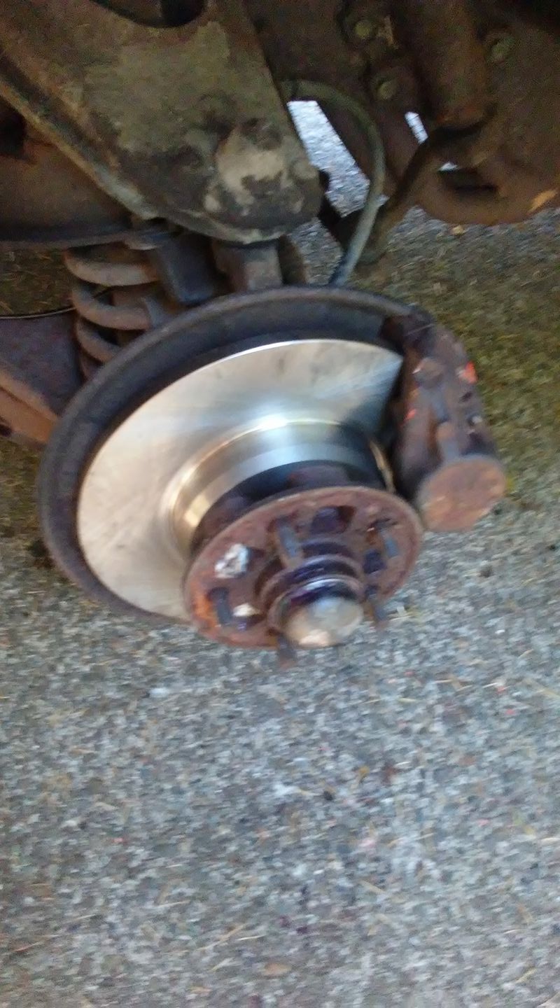

Once it dried out a little I did another couple projects- staining/sealing the flatbed and new brakes on the front. You can also see where the air tank sits a little better.

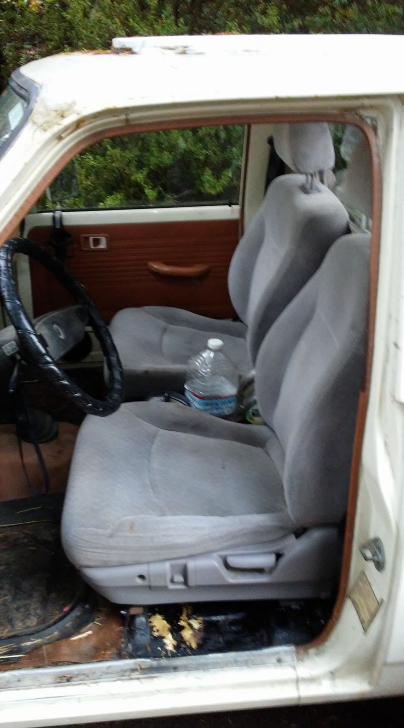

Alright and just one last update- finally got tired of the broken down ranger seat so got a couple of seats (for free) out of a 2000 honda accord. They weren't too bad to put in, and they are comfy. My only complaint is the seats are a little "big". Even all the way back it can be tricky getting in and out, and I don't think anybody taller than me (5'8") could drive comfortably. Of course, nobody else drives it anyway lol.
I've got some gauges on order so that will be the next project. This summer I'm thinking about giving it a coat of paint. I'm also looking for a smaller steering wheel to help the aforementioned seating issue.

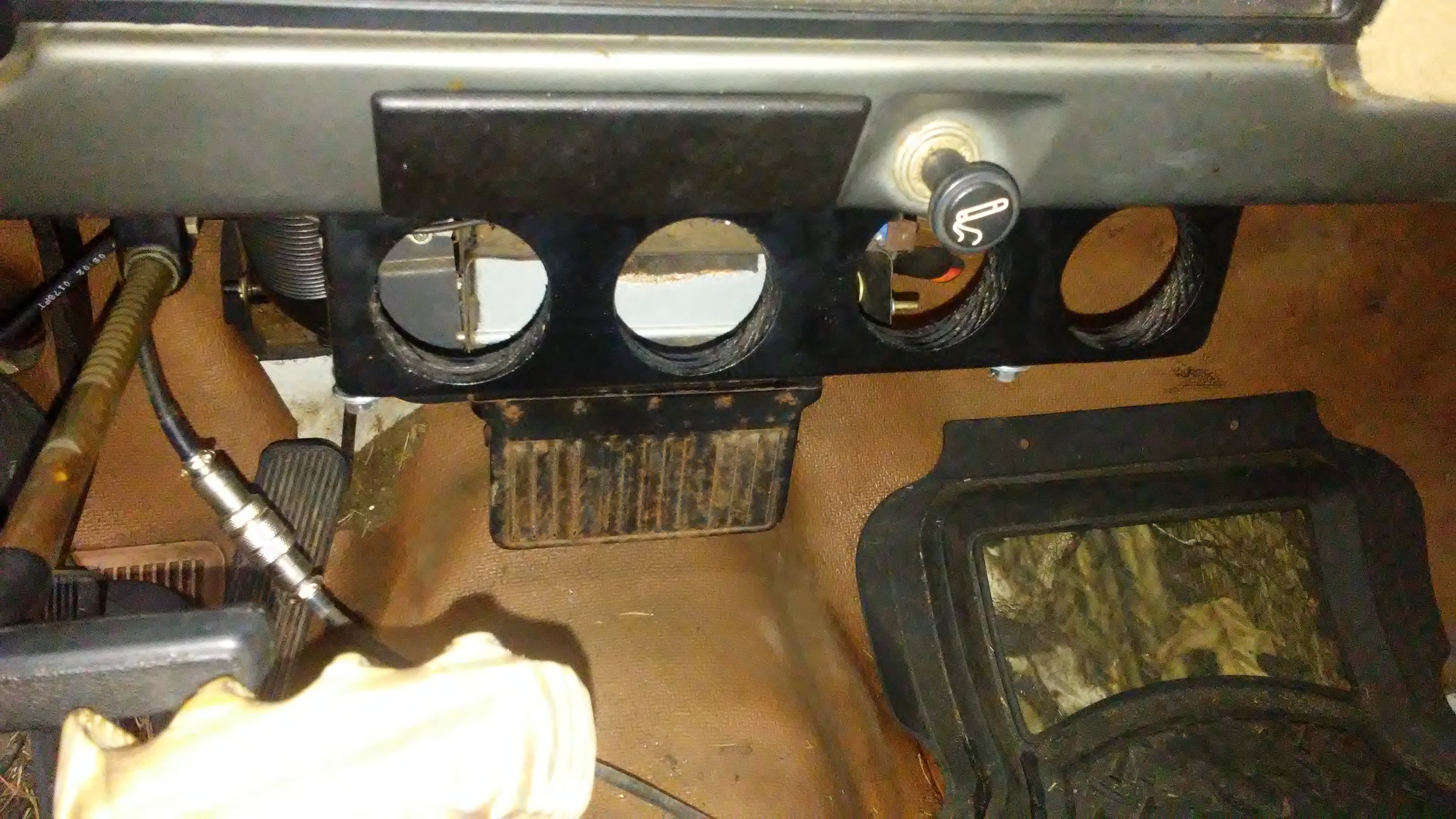

Another project completed today- Gauges.
After pricing out some of the common brand of gauges, I was shocked at the prices. $30-40 for each gauge. I found some decent looking chinese knock offs for sale on ebay and decided to give them a try. I got a tachometer, vacuum gauge, volt gauge, and oil pressure gauge. After pricing out the adapter to attach the gauge (and retain the stock idiot light circuit / needed for electric fuel pump) at nearly 30 dollars, I decided to use the oil pressure gauge for my OBA system instead.
Built a bezel out of some 1x3. Sanded/painted and attached to the under side of the dash with some sheet metal screws. Turned out nice I think, best place for gauges IMO as they are out of the way but still easy to see.
Here's the gauges all wired up in the bezel, all-in-all the connections I had were +, -, hose for vacuum, air pressure sender, and - side of coil for tach
And, the gauges installed. (Ignore the air pressure gauge in the second pic, it was taken before I connected the sender)
Overall I am pretty impressed with the gauges, especially for the price point. Most of them appear to be fairly accurate (the truck was just started and cold when picture taken hence the higher rpm / lower vacuum readings). One thing I do plan to change is the power source. I tapped onto the "gauge" circuit (seemed logical for gauges, lol), but then discovered the heater is also ran off that circuit. The only downside is when heater is on full blast I feel my voltage gauge is not giving an entirely accurate reading. I am likely going to either do a relay with a straight to battery source or switch over to the accessories circuit, which has less power draw (stereo and CB).
I also installed a lighted toggle switch for the OBA (previously was just attached to battery and used switch on the pressure switch to turn on/off), but no picture.
