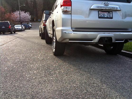

Just took the plunge and mounted 275/55-20 tires on my 20x7 inch wheels. I installed the Bridgestone Dueler H/L Alenza tires inflated to 32 psi. Firestone mounted these without even flinching over the fact that the tires suggested a wheel width of at least 7.5 inches.
Seems to handle just fine. All of the clearances are fine, as well. Love the look over the narrow oem tires. Couldn't handle any longer the look of such a large vehicle on such narrow tires.
Wish toyota would have put a wider wheel on in the 1st place in anticipation of plus sizing.
Attached Thumbnails Wider tires on 2010 Limited?-img_0121.jpg   Wider tires on 2010 Limited?-img_0122.jpg   Wider tires on 2010 Limited?-img_0123.jpg

More images:
Attached Thumbnails Wider tires on 2010 Limited?-img_0127.jpg   Wider tires on 2010 Limited?-img_0129.jpg   Wider tires on 2010 Limited?-img_0130.jpg

That looks like a very good fit.

Amazingly, they do fit quite well. They do seem to bulge a bit more than I would like being on the narrow rim, but to me it's worth the compromise.

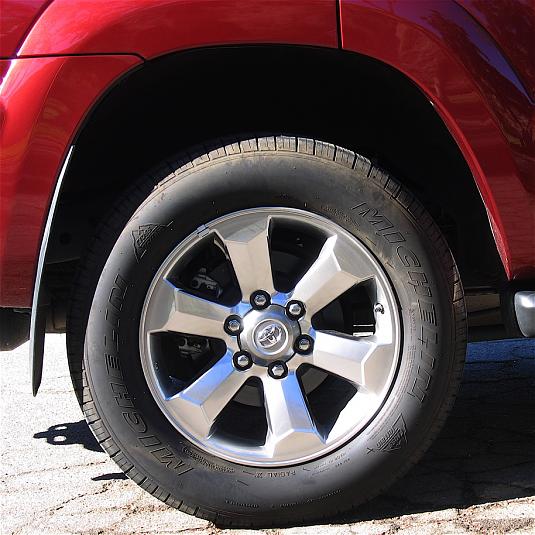

the limited rims are only 7 inches wide, thus limiting how big tire you can put. unfortunately there is no 265/60/20 tire yet, but ive seen some tire manufacters say MIN rim width is 7inches for the 275 tire.
Another option is using the 18x 7.5 inch 6 spoke rim from the 4th generation and putting 275/65/18 tires on. From ive read, this will not cause rubbing issues. This will be my setup..here is the gorgeous rim
