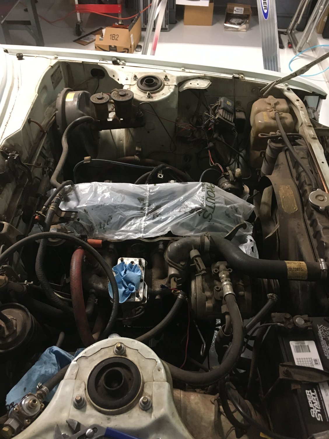

Valve cover and carb off for cleaning. This thing came with a weber 32/32 (not a 36mm secondary) and it ran so rich that fuel was coming out of the exhaust. I had to put a stock carb on and remove three nonfunctional electric fuel pumps and replace them with a stock in-tank one. bleh.

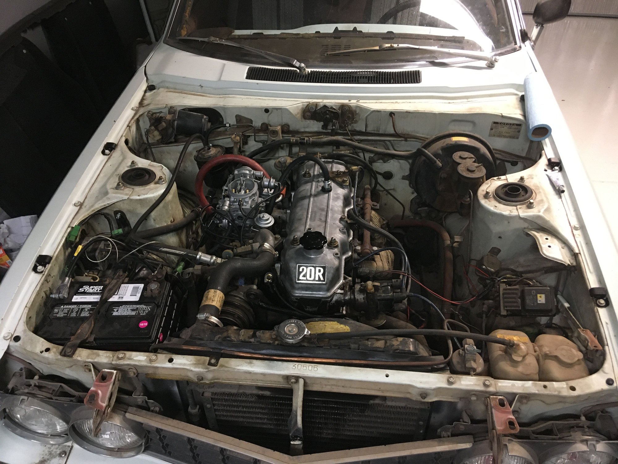

Just got the new carb on. Needs some serious tuning before its driveable again. Notice the half installed smog crap near the battery. Its all I could find on ebay so I'm going to try to make it work...
