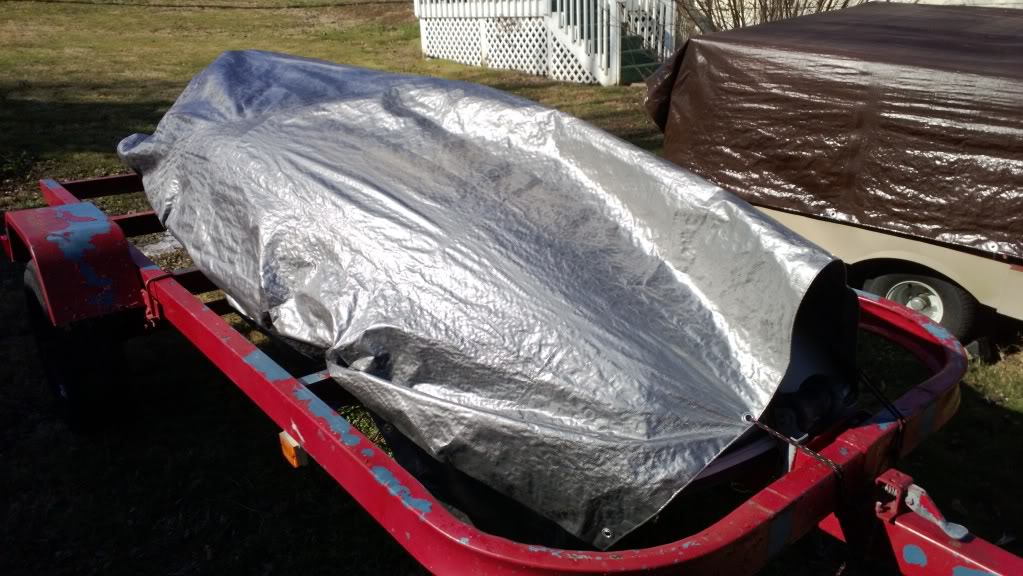

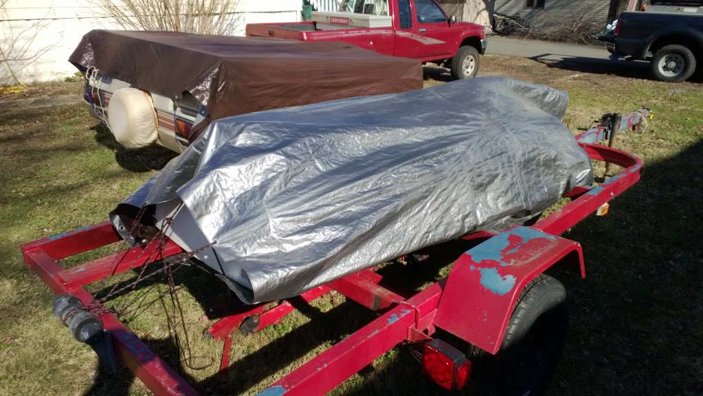

flipped the boat today, and looked at the sail. damn that thing is heavy, and also a pain to move by myself

i'll wait for a warmer weekend to glass the holes. the gel-coat is cracked, but nothing serious. just a lot of sanding and painting in my future

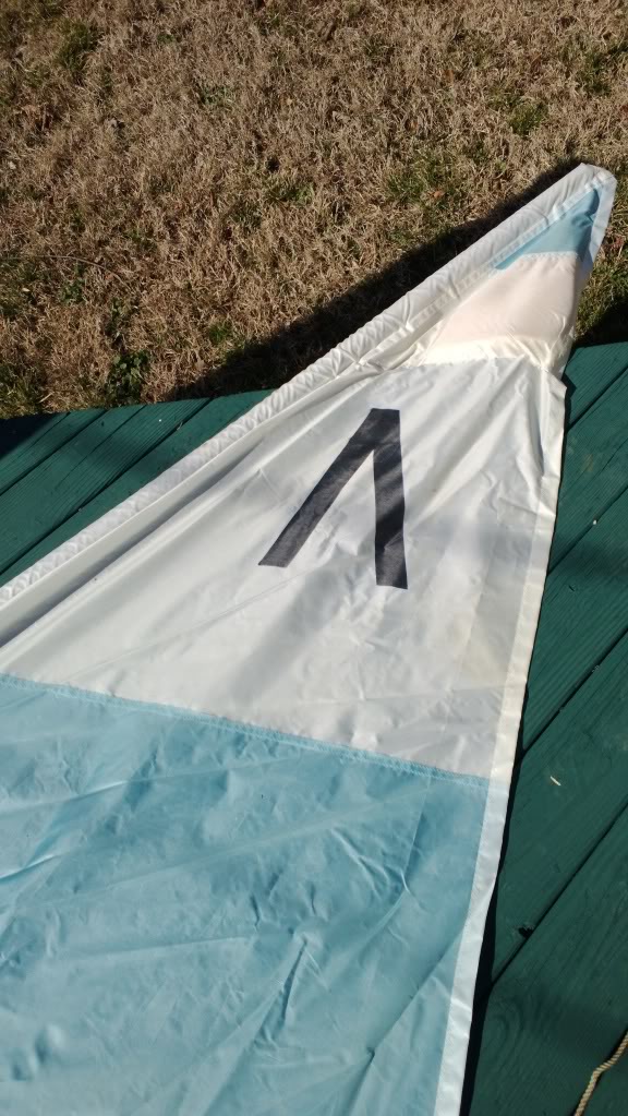

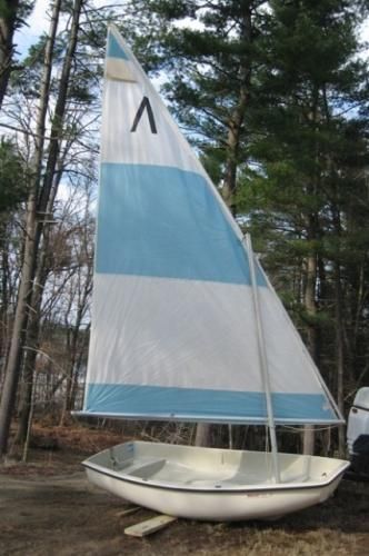

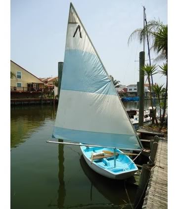

also, the sail is from a sunfish, not the original one. it's pretty big.
and i found some pics online of the boat with the sail. anyone know what the lambda means? Λ

Those pictures from the net are of two different boats so I think you have the correct sail. The looseness is to allow it to catch wind. Wm. Mills made all the canvas and cushions for the early MA made Whalers. The are still in business and they are very pricey. If your Squall is pre 1973 it is supposed to have the blue interior and white exterior. If it's newer it's a light tannish color, I can't remember it's name.

so with the sail, you're saying that style of sail was made for both the sunfish and squall? as per the parts diagram, it looks like it came with a |\ shape instead of the /\ that i have now. dunno...

Why do you think it's from Sunfish? IIRC a Sunfish has sort of an oval mast that is about 4" at the widest part. I can't really tell from the internet but it looks like your mast is round and about 2". Is the sail cut for a wider mast? Based on the pics from the intenet it looks like your sail is identical to the other Squalls. There might be a possibility that your mast and boom came from another model of boat. In the 1970's there tons of wanna-be Sunfishes that sold for about $120. The one we have for the kids has a 45sq ft. lateen sail. I've never seen a Squall in person so I couldn't say. You might try to google Mills and see if they still sell those sails. I know they wanted over $300 for a BW cover I got from a place in MI for $124. Mine was USA made too. Brrr. It seems too cold to work on boats right now but I guess you have to if you want to have a full season with it. You really have to keep the water out of the boat because the foam will absorb it plus the freeze/thaw is bad for the fiberglass. Next year flip it over for the winter. The wood thwart seat you have will look great with some sanding and varnish. I keep my wood parts in the house.

the only reason i think it's from a sunfish is that's what i saw pics of on the google. but i'm no expert, and i know i have a lot more to learn.

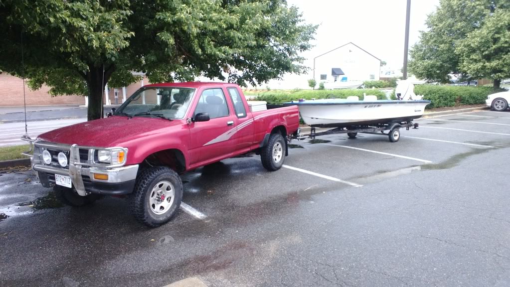

aaaaaaaaand it's gone. all of it. it's all gone.
i traded up in the world...
