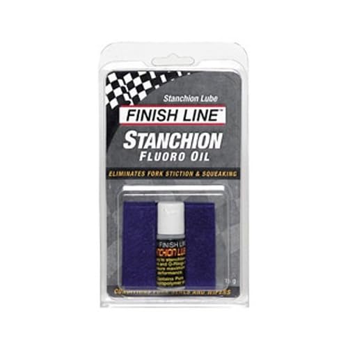

Fork squeak cured
Finish Line Stanchion Fluoro Oil Bike Lube
http://www.finishlineusa.com/product...chion-lube.htm
http://www.amazon.com/Finish-Line-St...1158233&sr=8-1
Stopped in at lunch today at my LBS and picked up the new Bike and Mountain Bike Action magazines, and of course the lube above.
This did the trick.
The stuff is very slippery.
I put some on the pad it came with and wiped the stanchions, and also dribbled some down the tube and around the plastic seals at the top of the forks.
Then I set my shock to easy and then compressed it with my arms and chest down several times and worked it in real good.
Took it for a quick spin around the block.
Noise eliminated.
This stuff works.
You can see the compression line too several inches up the tubes on how far I was able to compress them down.
Bob, this does not leave a coat of sticky grease either like maybe that Judy Butter did for you.
It is a very light film.
You might try it and see how you like it.

Corey, glad your fork fixed work. Judy Butter is working out better with the thinnest film possible.
