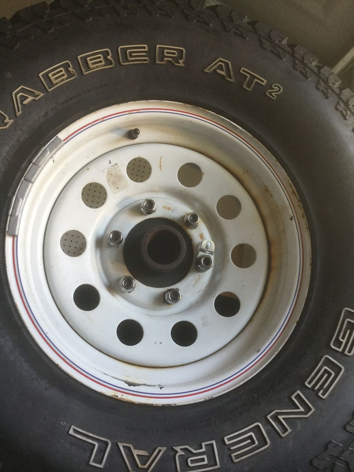

Sep 12, 2020 | 05:56 AM
  • Vehicle: 1979 3 Gen N30 4x4 Deluxe 20R
  • Brand/Style: unknown, no makers mark anywhere
  • Material: Steel
  • Size: 15x9 (I think - measured it myself)
  • Lug Pattern: 6x5.5” (140mm)
  • Offset: -1.5” (38mm)
  • Backspacing: 3.5” (89mm)
  • Center Bore: 4.25” (110mm)
  • Spacers: none
  • Tires: 31x10.5R15
  • Clearance Issues: none
  • Technical Notes: 2” lift
I have 4 running (kinda split-rim style) wheels of anonymous make - but I reckon they look pretty good on Rusty Bob. Problem is I have the spare on a “trailer” rim and I want to know if I need to track down a steel wheel that will carry the load/speed better? Or am I ok with it? But finding a replacement for this configuration (above) is wearing me out... Seriously I’ve looked everywhere! HELP!
