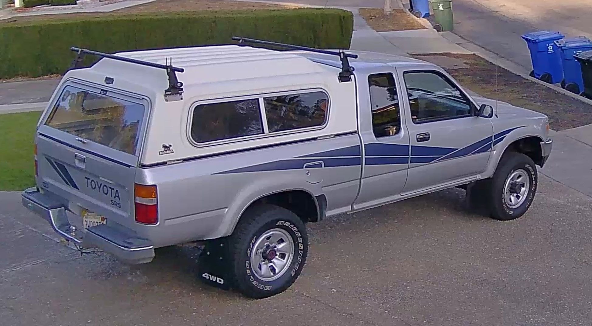

Hey all,
I have an 89 Pickup Xtracab 4x4 SR5 V6 5spd
It's got 225/75R15 tires on it now. I don't know what the wheels are but I believe they are OEM stock.
Can I just put 31x10.5r15 on the stock wheels or do I need to buy new wheels?
Any idea what the width of these wheels are?
Thanks!

31s qill fit fine. The stock wheels should be 8" wide.
