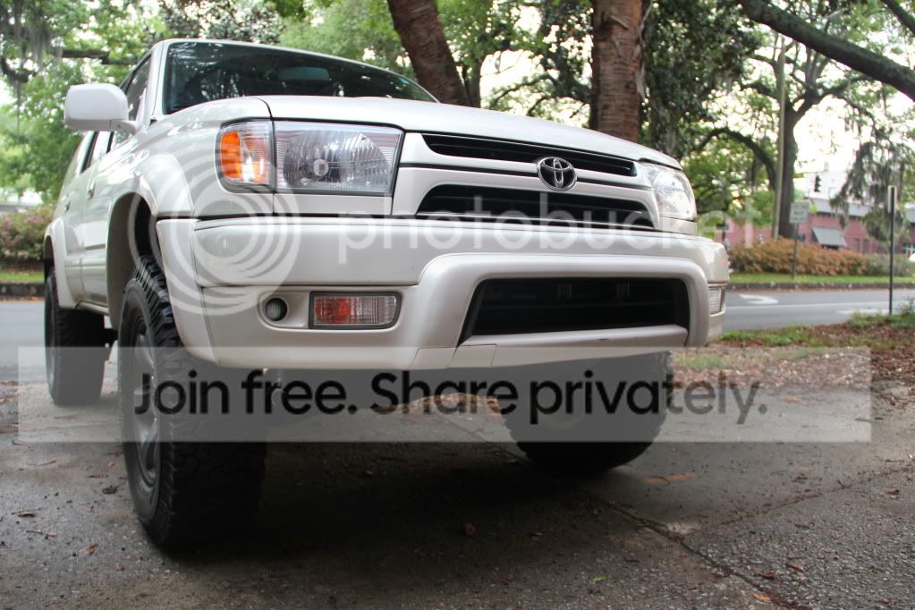

I am picking up my Sequoia wheels today. If I'm doing the math correctly on the Sequoia wheels vs my current 5-spoke alloys, the additional 1/2" of rim width on the Sequoias will put the wheel and tire 1/4" closer to the top of the A-arm than my current stock wheels. (My 5-spokes are 4-5/8" backspacing and 7" wide and the Sequoias are 4-7/8" backspacing and 7.5" wide). Since you already have these wheels installed, I would measure the distance between the tire and the upper A-arm and see how much room you have for additional tire width. I hate how my factory wheels are tucked into the wheelwells, so I plan to add some 1.25" Spidertrax spacers to bring the wheels out and in-line with the body/flare. It will also put more distance between the wheel/tire and the A-arm. I know you said you didn't want wheel spacers, so I would measure carefully before you select your tire size or you might be buying spacers to make them fit. Aftermarket UCA's are pricey and not necessary with spacers.
I need just a little more tire height and width in my wheelwells to make it look right and the 275/70 is exactly what I need.
Here is a photo of my truck with the stock wheels--notice how tucked-in the wheels/tires are? A 1.25" spacer with the Sequoia wheel's additional 1/4" of backspacing will move the wheel out exactly 1" from where it sits in this picture:
And here's how they sit with the 1.25" spacer (someone else's pic):
Just something to think about.

Your truck looks fantastic friend. Nice! Plus a Supercharger I am jealous. I drove V8 Chevy/GMC trucks since 16 until 30, nothing but 350s and 4 speed and 5 speeds, with one auto in the mix. I am used to way more guts. Im my 30s I got a Grand Cherokee High Output V8 that hauled ass, and then got into Jeep TJs which can wheel circles around full size rigs in tight trails and rocks, but they feel like slugs. I have 33s on an 05 Rubicon and regeared to 4.88 and still feels gutless to me ha. The 4runner is a 5 speed and previous owner said it had rare 4:30 (usually come in autos) with the rear locker. Its not horrific, but its not ballsy by any means. Id kill for a supercharger! hah
You got me thinking, maybe I should do the wheel spacers for reasons you mentioned. If so then should I just go with the 285s? What is your reasoning with wheel spacers for the 275s? Although I am itching, I called Sears today, none in stock but they put me on hold and called a Cooper warehouse which they said have them?! Wonder why no one else can get them for me right now and says 6 week backorder. I really want to try them, especially if I can get them for $200 like some of the online places list them. BUT I get your point, and I wouldnt mind the tires coming out a little more, although mine do seem to stick out further than yours. Not sure if I can post pics like you can but I will go try right now.
