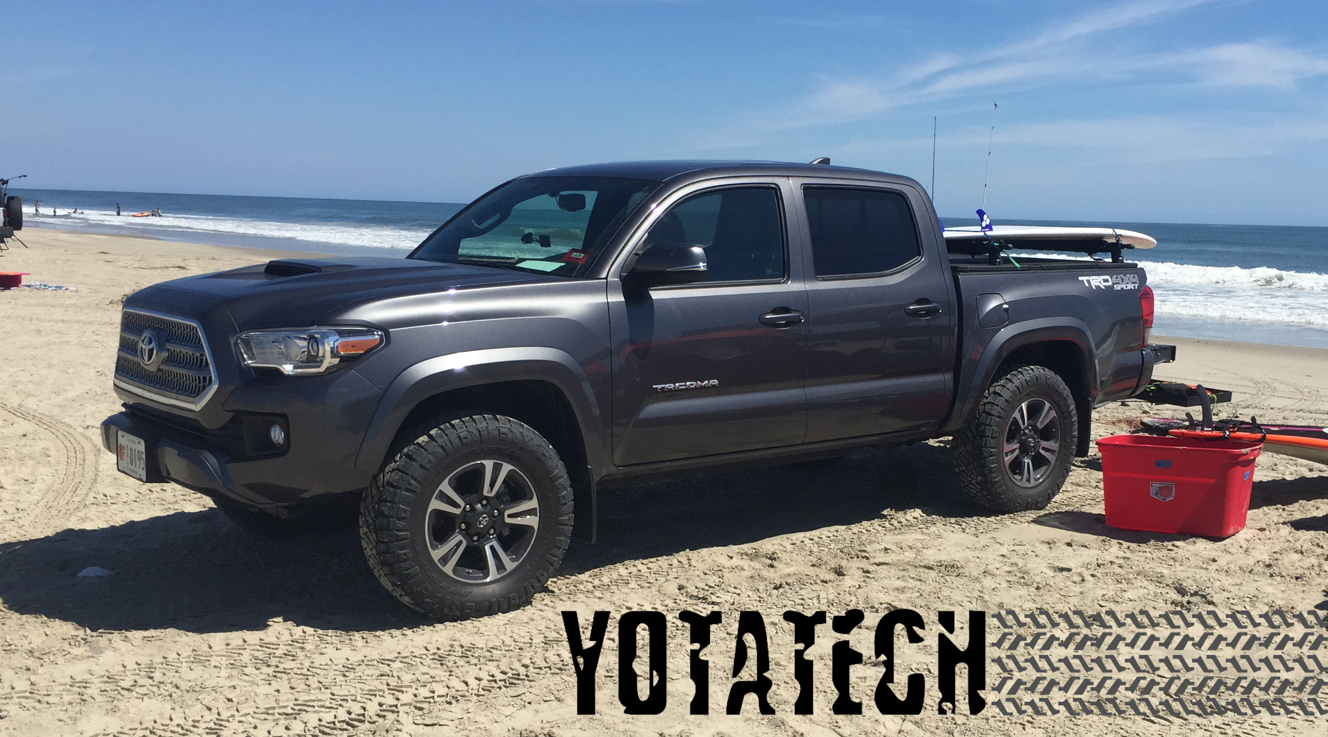

Here's one more shot of my truck at the beach with the Ridge Grapplers. They definitely make my truck look more aggressive!
