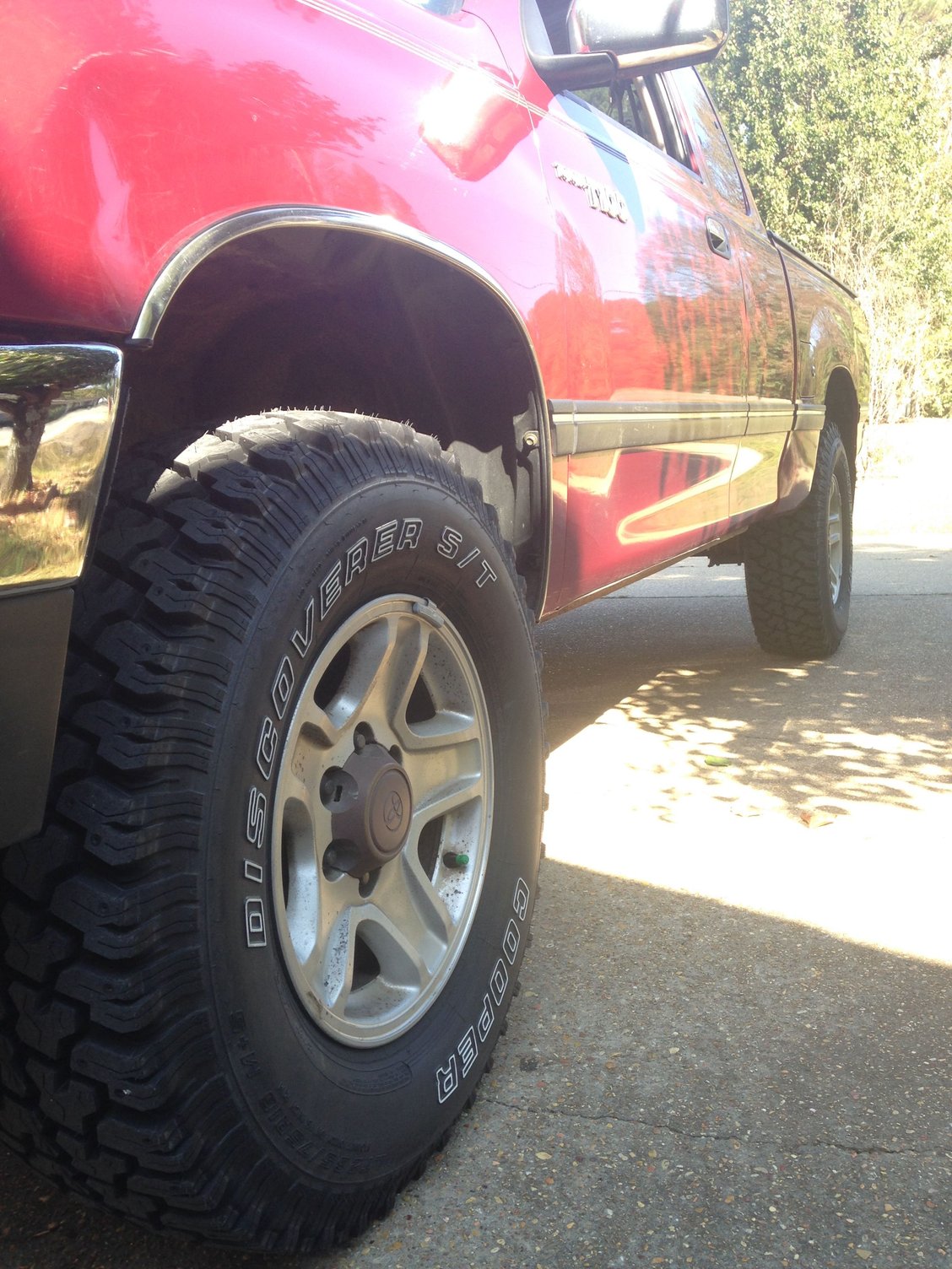

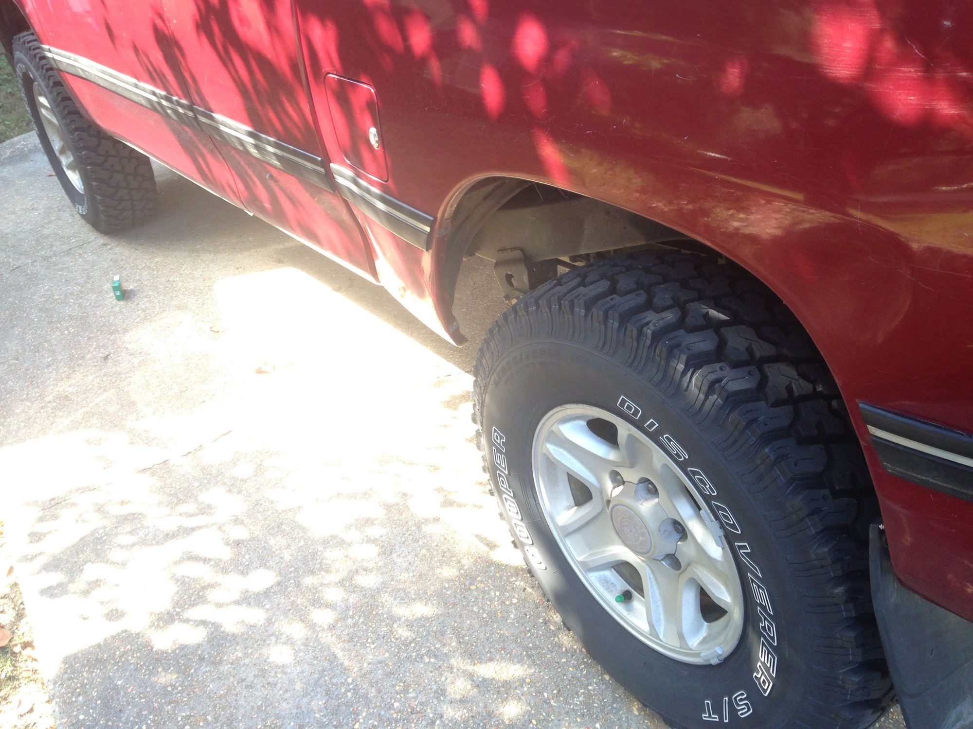

Hey guys update, I went with another set of 265/75/16's! I got some Cooper Discoverer S/T's, and from looking at them in person I'm about 90% sure the 285's would fit if I trim the valence under the bumper. Also removed the ugly running boards and chrome trim around the fenders, I'm pleased with how much nicer it looks.
Pics:
285's would cut it close in the rear, but I'm pretty sure I could have fit them if I removed the mud flaps
good side pic of the truck with the running boards off

It looked like an old man truck with those running boards. Good call. The Coopers look great. I hope my 4th gen gets some soon.
