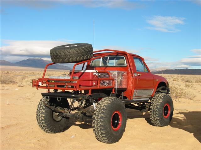

Interco IROK 39.5x13.50 tires
just installed a new set of 39.50x13.50x15 IROK tires
on a set of ALLIED 15x10 2.5" backspaced beadlock wheels on
my 1983 Toyota.I have tried many size tires over the years from 31" to 37" and these tires are the best for all around traction.
mud,snow and hard core rock crawling.Just my 2 cents...
here's a pic of my rig...

That is a great flatbed design. Awesome rig!!!

Nice fab work on the roll bar and flat bed cage.
Your trucks looks tight, does that monster see pavement much?
What do you drive for your primary vehicle?

trail only rig
glad you enjoyed my rig....it was my daily driver for many years.
It currently has 153,000 on the odometer and I was the original
owner.over the years it has turned into what you see here.
recent additions such as a fj80 high pinion /detroit locked front
diff/v-6 spooled rear,hydraulic ram assist steering,jp eater dual
case w/4.0 frt gear set,140:1 crawl ratio.38 weber carb and next
weeks project a 3 link coil suspension in the rear.truck works
very well in all types of terrian/conditions.My daily driver is now
a Dodge 3500 4x4 cummins dually which also pulls my Toy up to
the Rubicon and the Sierra's in the summer.due to Calif tough
smog laws I decided to green sticker it just drive it off road only.
maybe a occasional drive around the block.It still drives nice and
last year I even drove to the all pro jamboree in Johnson valley.
about 550 miles each way...anyway..glad you enjoyed my baby.

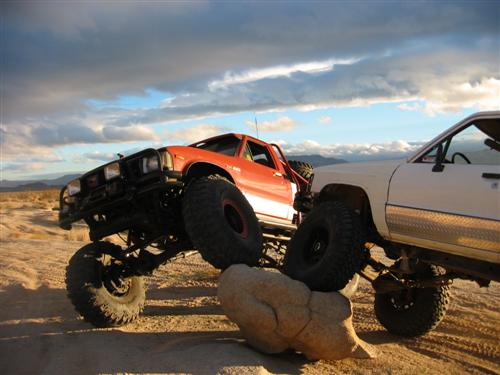

another pic
Johnson valley New years day 2004...me and another Toy

Your truck looks mean, keep up the good work
