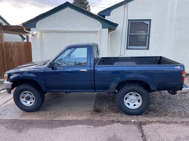

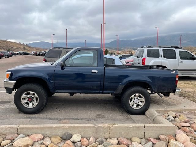

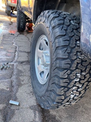

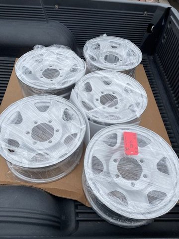

Had the tires mounted at my local tire shop. They didn't blink an eye when I brought in both the rims and the rubber and just asked them to mount, balance and install. IMO, the 31X10.5R15 BFG KO2's with 15X6 steelies look good on the truck. Better than the original, tarnished alloy 15X7 rims. There's minimal bulge or ballooning of the sidewalls and they handle fine on the road. I'll keep an eye on uneven wear and adjust pressure or rotate as necessary. Thanks to all for the assist!
Old rims (15X7)
New rims (15X6)
Post sandblasting and powder coating.
31X10.5R15 BFG KO2 mounted on 15X6 steel rims.

Thanks! I pulled the center caps on the rear tires. Looks better. The asymmetric look was bugging me.
