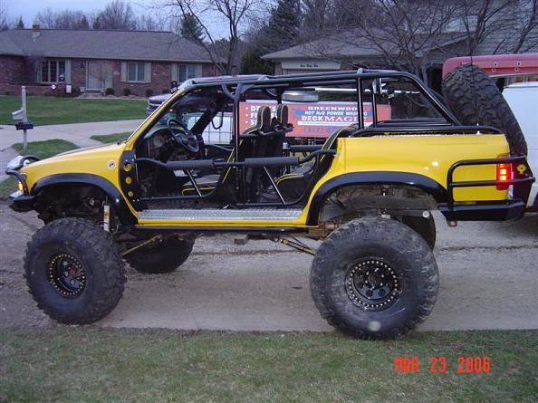

Question Can any ID these wheels?
I found this on wildyoats i have been looking for some whels with hole + sim.beadlock.Also recommendations on width for 1gen 4runner with body lift(fOR NOW).i HAVE 33X12.5X15 ON 10" wheels now but like the little bit skinner look as well.
Thanks for any advise

Made by Mickey Thomson
Made by Eaton
Ones aluminum, ones steel. Both simulated.

That is an interesting 2nd gen.

Thanks Guys that is what I love about this site!!!(Quick answers)I thought that truck is pretty sick as well but lots of $$$$$.

To me...
looks like a real 32 bolt beadlock

they look like cragar soft 8s with beadlooks added
http://store.summitracing.com/egnsea...5&autoview=sku
if you wanna go skinnier, do the 33x10.5's on 15x8s. otherwise 12.5s on 15x10s are good match.
i'd recommend the skinnier based on GVWR of our truck, but if you like the fat look, 12.5 is your size.
OR you can play with your backspacing. ex: going with a 3.5 backspace on a 15x8 will give you 4.5" on the outside, basically making the tire stick out past the fender a little bit more.
my avatar shows 31x10.5 on 15x9s, backspaced 4". so i have 5" on the outer side and they look good, just 2" past the fender edge.

Do you have anymore info on the YELLOW 4runner?
