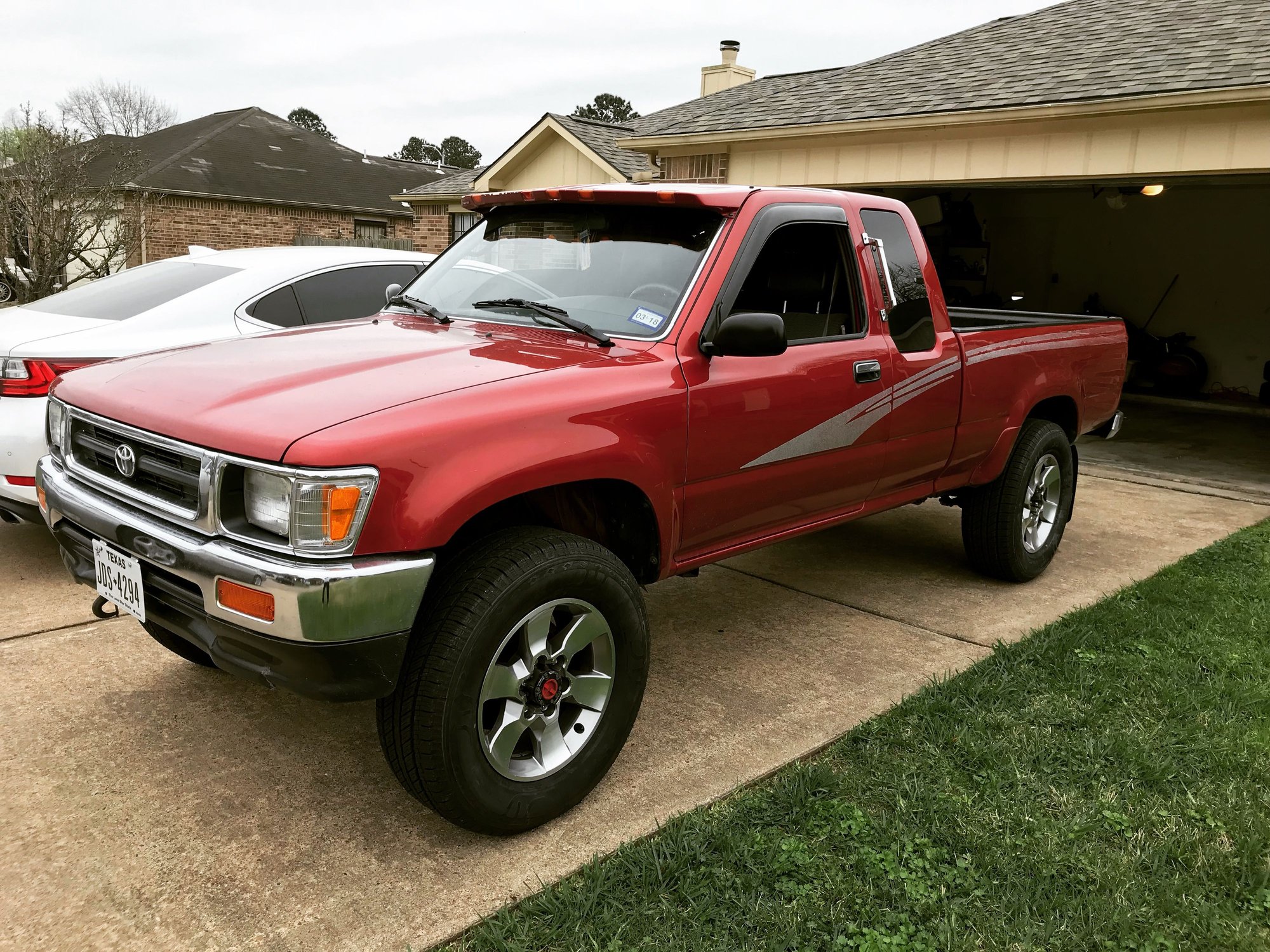

I just mounted these 17” wheels from a 2012 4Runner on my 93 deluxe. I mounted some street oriented suv tires, 265/65/17. Fits good. I wish it had more offset, I would like if they stuck out more
