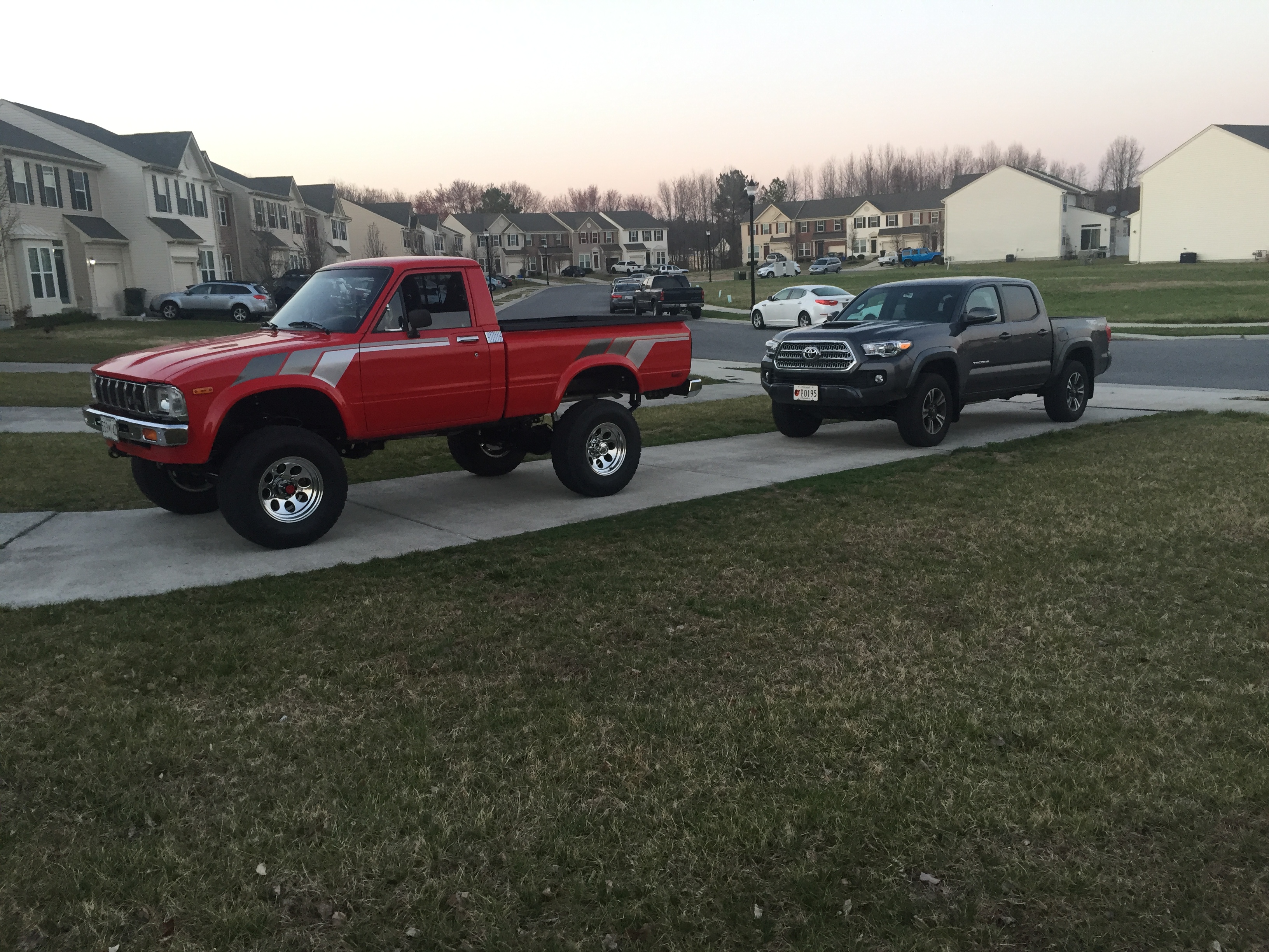

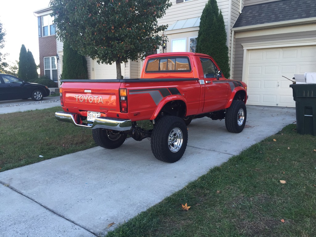

On my 83 shortbed I have Old Man Emu front and rear springs, Bilstein 5125 shocks and Trail Gear shackles. The OME springs supposedly provide 2" of lift but from the pictures I have seen of original stock height Pickups I'm thinking that the springs may be closer to 3" of actual lift. I originally went with 5.5" Trail Gear Shackles, but it seemed a little high for 31" tires (I was in the same boat as you - I wanted it to look like the tires belonged on the truck). Stock shackle length is 3.5" so 5.5" shackles would yield about 1" of actual lift. To drop it down and level the truck a bit I modified the Trail Gear shackles to 4" in the rear and 4.5" in the front.
To further complicate the equation, I went with Bilstein 5125 shocks. Since they are a pressurized gas shock, they want to rebound and "rest" at full extension as opposed to hydraulic shocks which will rest at any point in their travel and act as a dampener. Given this fact, the Bilsteins I used actually add a slight lift to the suspension as they push upward on the truck. I have removed the shocks and discovered that the shocks that I used account for just under 1/2" of lift at rest.
So all that being said (assuming the OME specs of 2" for the springs), I have about 3" of total lift in the front and 2.75" of total lift in the rear. But like I said, I think the OME springs are closer to 3" of lift so I typically tell people that I have 3" to 4" in the front and 2.75" to 3.75" in the rear. Springs, shackles and shocks were collectively well under $1,000 shipped. I shopped it out a bit for good deals, but that's pretty cheap for a complete quality suspension.
I run 31x10.5 Faulken Wildpeak A/T tires on 15"x8" Ion aluminum wheels and I think the height is rather appropriate for the tires. If anything, I could could drop down to stock length shackles or hydro shocks and be a little better. Pictures are below - you can be the judge.
As far as ride comfort goes, there aren't any better riding bolt-on stock length springs out there. My truck rides great on and off road. Again, if I wanted to soften it up a bit, I could always switch over to hydro shocks and lose some of the stiffness that that gas shocks provide.
