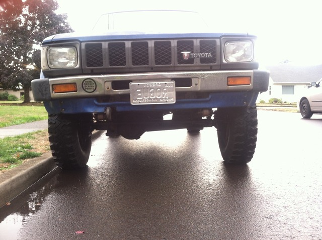

I have been looking for a set of tires that are narrower for easier steering, plus I really like the look and don't like the look of wider tires. There might be other good reasons for narrow such as fuel economy, not sure. I'm set on tall and narrow.

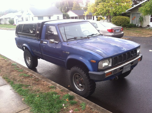

Now I've ordered a pair for now since my front BFG AT tires are really bald and one has a slow leak 10-15psi a day. They are these STA Super Traxions, which seemed to meet all my needs.

I'm curious to see how my 1982 straight axle pickup will respond to this type of tire. They're set to arrive tomorrow, and I'm planning on having them mounted in the front because my bald BFGs are scary and require daily air in one. With all the nagative things everyone's been saying about B.P. construction, I'm a little anxious I'll wobble right off the damn road or something. People are nort making them sound pleasant, and I'm still hoping it's not the end of the world or my $326 for the pair.

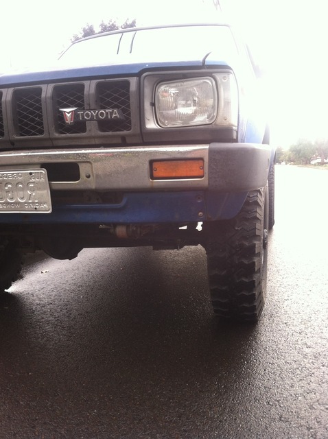

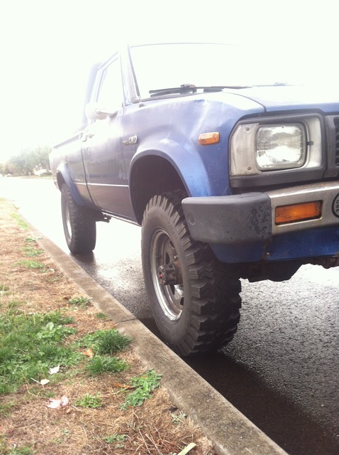

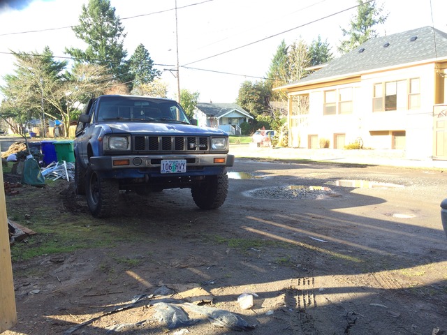

They are not as bad as everyone was talking about bias ply tires to be. I only noticed a small high frequency vibration for the last 15mph of deceleration, and a little of that at high speeds. I got it up to 60 which is the fastest I like to go most of the time, and they handled fine, tracked straight, and turned really easily in the parking lot compared to the bald BFG AT 10.50s. And these are only aired up to 35 of the 60 PSI they are able to be inflated to!

I've still only got two on the front, and having no power steering, they make a huge difference in steerability over any other commonly available width of tire.
I'm still on the fence about whether to retrofit power steering because I found it really hard to take the alternator out of a truck in the junkyard that had it, but for now the narrow tires are a great substitute.
They ride a little harder and offer a little less suspension, but my friend who drives a '79 daily said it was hard to tell the difference between the two when he was riding passenger in my '82. He runs Dunlop Radial Rover A/Ts on his.
