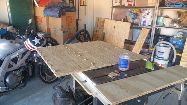

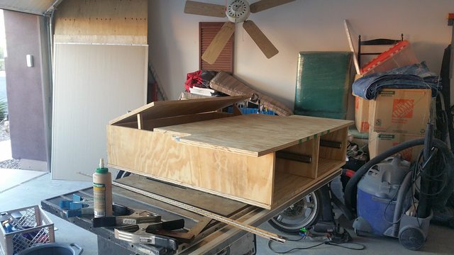

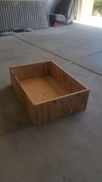

Below you can see the base of the box. Everything is 3/4" ply. I used biscuits in the hopes of making this thing sturdy.

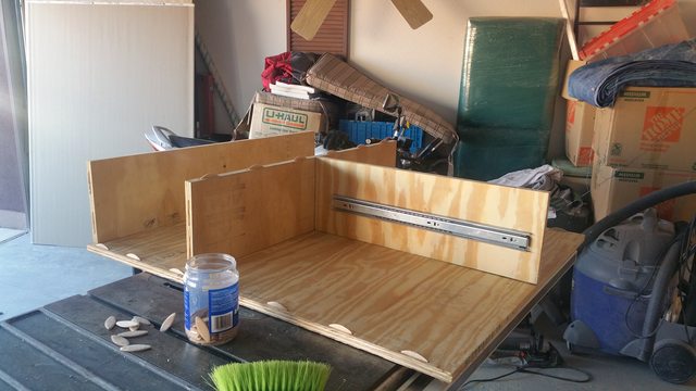

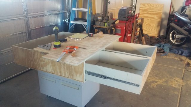

The uprights going in. I used 22" full extension sliders. The drawers will be 24" deep. The drawer sections are 25" deep.
All of the uprights in place now. As you can see the rear section does not have biscuits because that portion of the lid will be hinged to reveal the storage in the front section of the box.

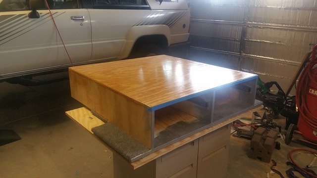

Here is a shot with the lid on. The wide section is the rear of the truck right at the tailgate.

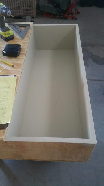

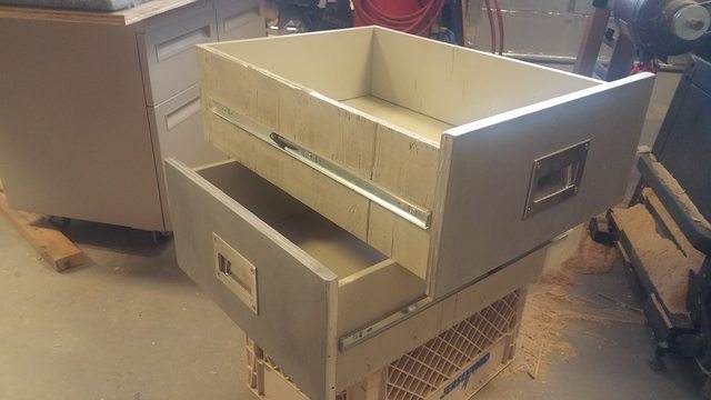

I didn't get enough photos of this process. It was a giant pain in the ass. Each drawers was custom sized to fit in one of the drawer sections of the frame. Rabbet joints and a floating bottom. This is 1/2" ply. Not very good stuff. Filled some of the voids with epoxy afterwards. If you thought Ikea was furniture was a pain, try making your own.

The drawers fit! After a little bit of trimming and shimming but they fit! Slide pretty well too. Each drawer should be able to hold 100lbs. I doubt ill ever have that much stuff in them.

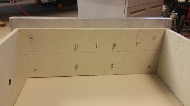

You can see the floating bottom in this one. SS screw hold the face to the drawer. SS bolt with acorn nuts hold the handle on. Had to grind the bolts so they would fit.

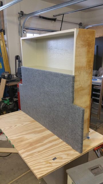

This is technically the front of the box. I decided early on to use the coordinate system of the car for the coordinate system of the box. Anyways its all painted.

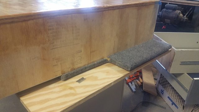

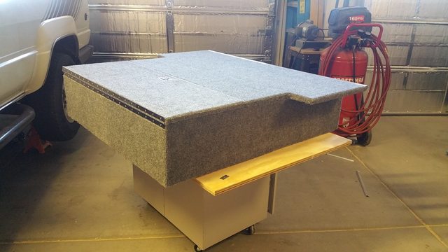

Indoor/outdoor carpet glued on. This process was mess but ultimately pretty easy. You can also see the clear coat on the bottom.
There were a few bare spots after the initial wrapping because of geometry. Those got patched later. worry not.

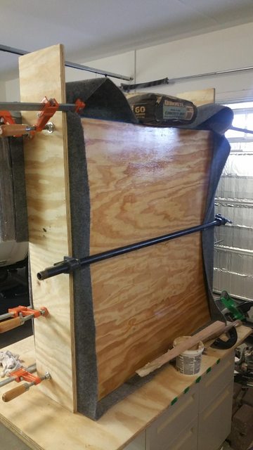

The carpet adhesive needs to be under pressure to set. That what the bucket said at least.
Glued the carpet on the sides. Used plastic wrap to protect the good carpet from the glue. I thought that was pretty smart.

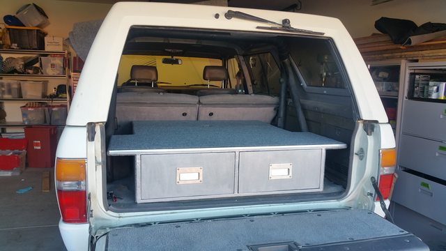

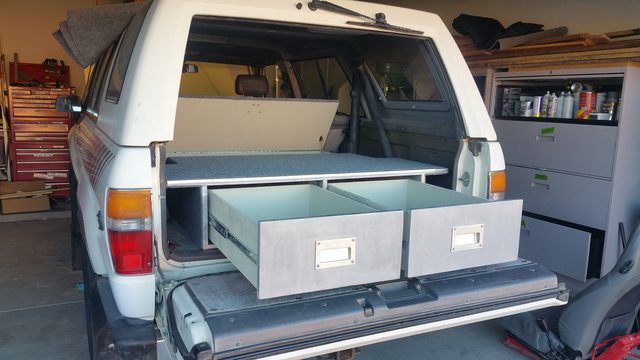

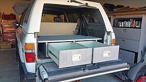

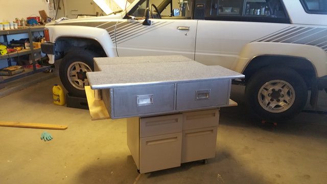

There it is. Drawers are in. Hatch is attached. Hatch lever is on. A got an aluminum guard thing on the front.
You can see the hatch support and piano hinge on the back. Everything works great.

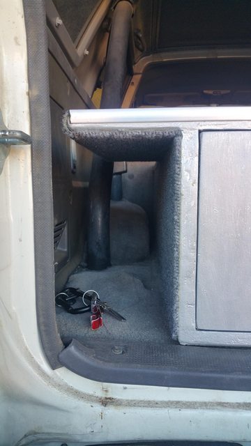

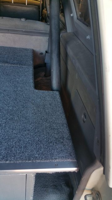

There is still enough room to get into the little storage boxes on the side. You can see the guard and carpet pretty well.

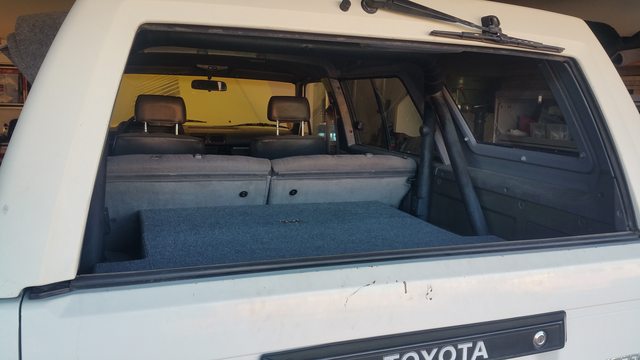

I tried to make the most of the space. The width of the wide section is just small enough to make it inside the back. It narrows at the roll bar/wheel well. The rest of the platform is narrow enough to make it between the wheel wells.

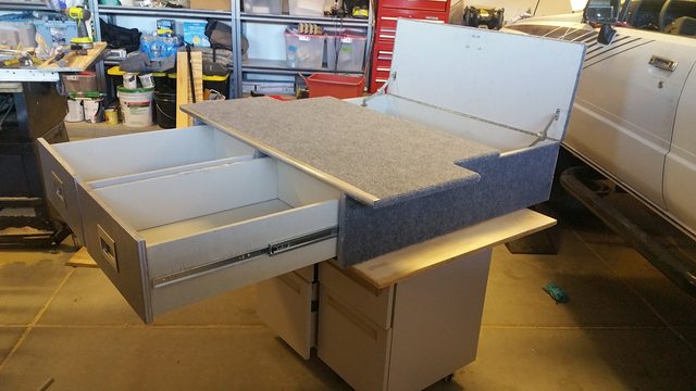

Hatch open. Drawers open. Im happy with the results.
Turned out great. I need to add a ledger strip to support the hatch when it is closed. I also need to add rings to the sides to secure the box to the frame via turnbuckles. Once that is all done I'll probably put together some dimensioned drawings for the assembly and parts.
