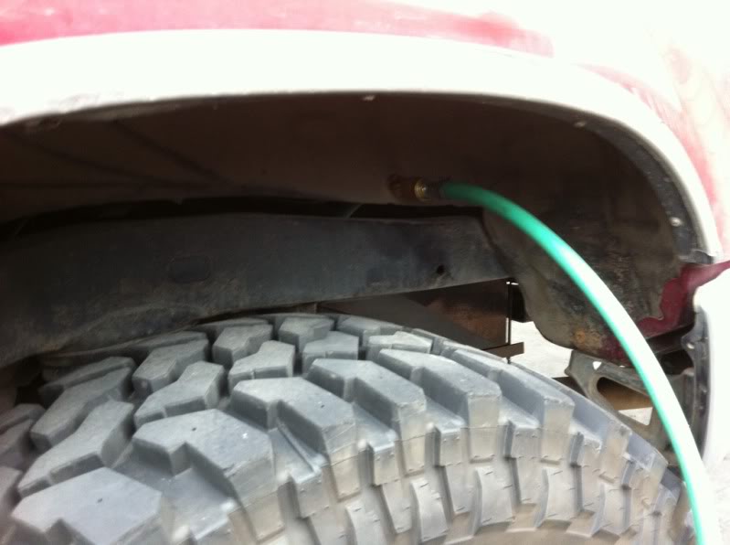

Step 5 - You will also need to find somewhere on the front bumper to mount the shower side. I chose the hole on the bumper where the valance use to go. I enlarged the hole so another male connector fit in it. I then repeated the sandwich maneuver from the back bumper. If you use the same spot I did, you'll need a flip up license plate. 2 small hinges work well for this.

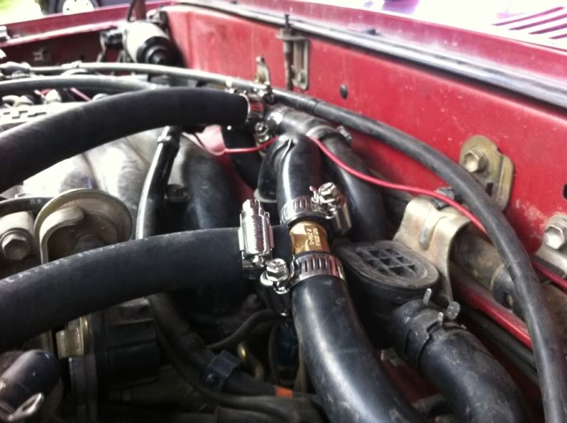

Step 8 – We need heat captain. You will be tapping into the heater hose going into the cabin. If you are not comfortable, read up on it. Find the 2 hoses going into the heater core, splice in the 3/4” tee fittings. The “tee” portion will go to the FPHE. Try to create opposite flow in the FPHE (if water goes top to bottom antifreeze should go bottom to top) Take the non tee end and hook it straight to the FPHE, it should fit over the threads, no problems. Remember, hose clamp everything.

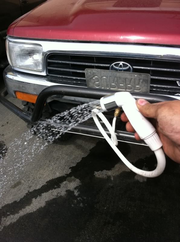

A 20mile, 10pm bike ride... followed by a hot shower

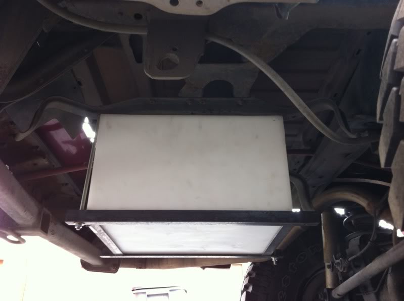

So I my "custom" tank for the shower came in today.... sorta.
Apparently the tank builder can't read dimensions or can't measure... not sure which. It was WAYYYYYYYYY off. So, I went the next best route and used one of his "standard" tanks. 9 gallons of water is now happily under my 4runner. Not to mention I got to use the welder, which is always a fun time.

I used the stock spare tire steel for the upper mounts. They are plenty strong, and the tank weighs 72lbs full.

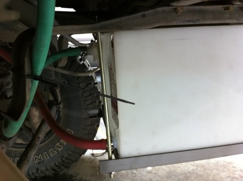

Green is FILL, Red is PUMP, and in the back you can see 2 clear lines, one is the tank vent and one is my rear diff vent.
