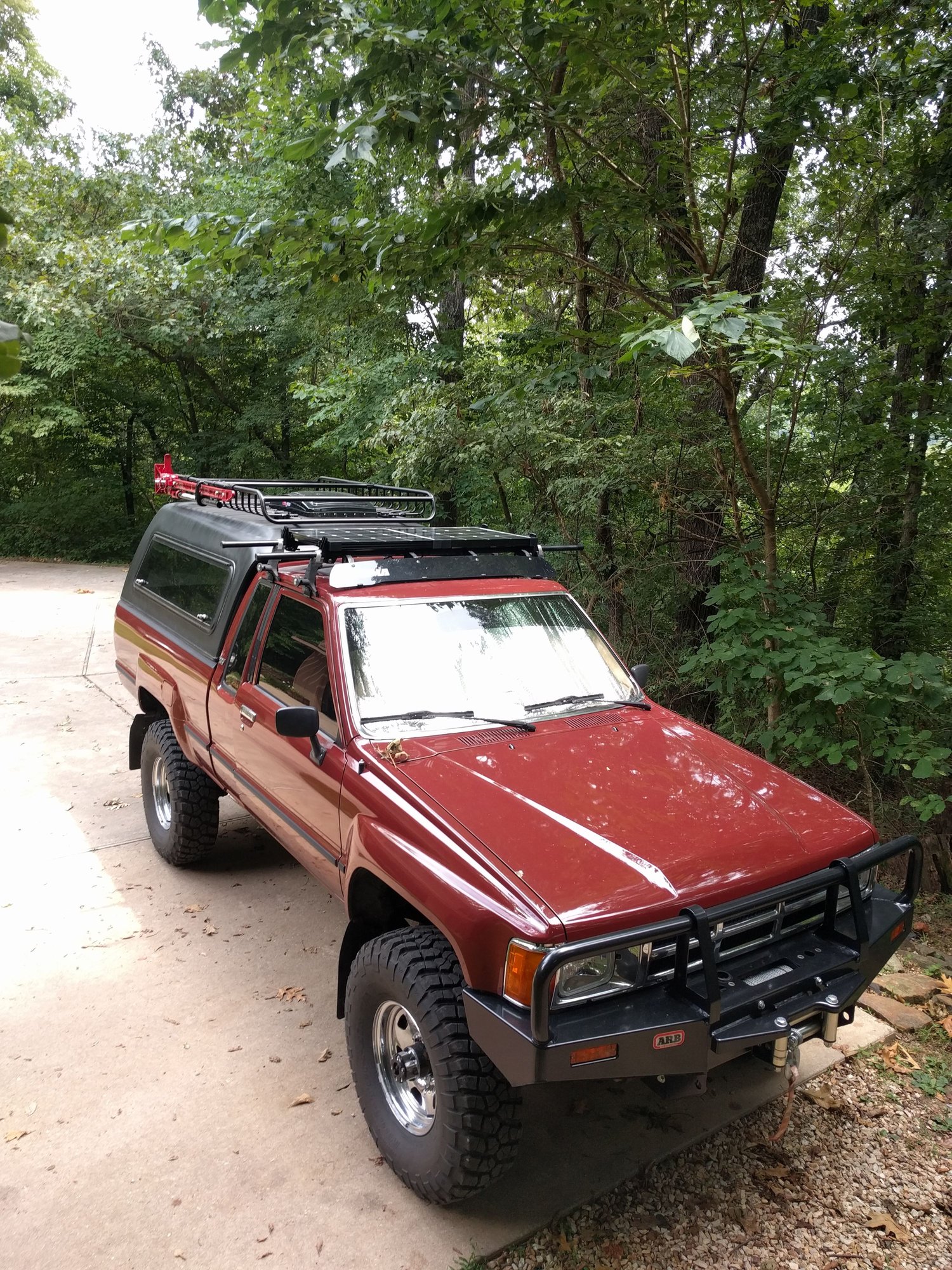

Hi-lift and Solar panel (mostly) mounted.

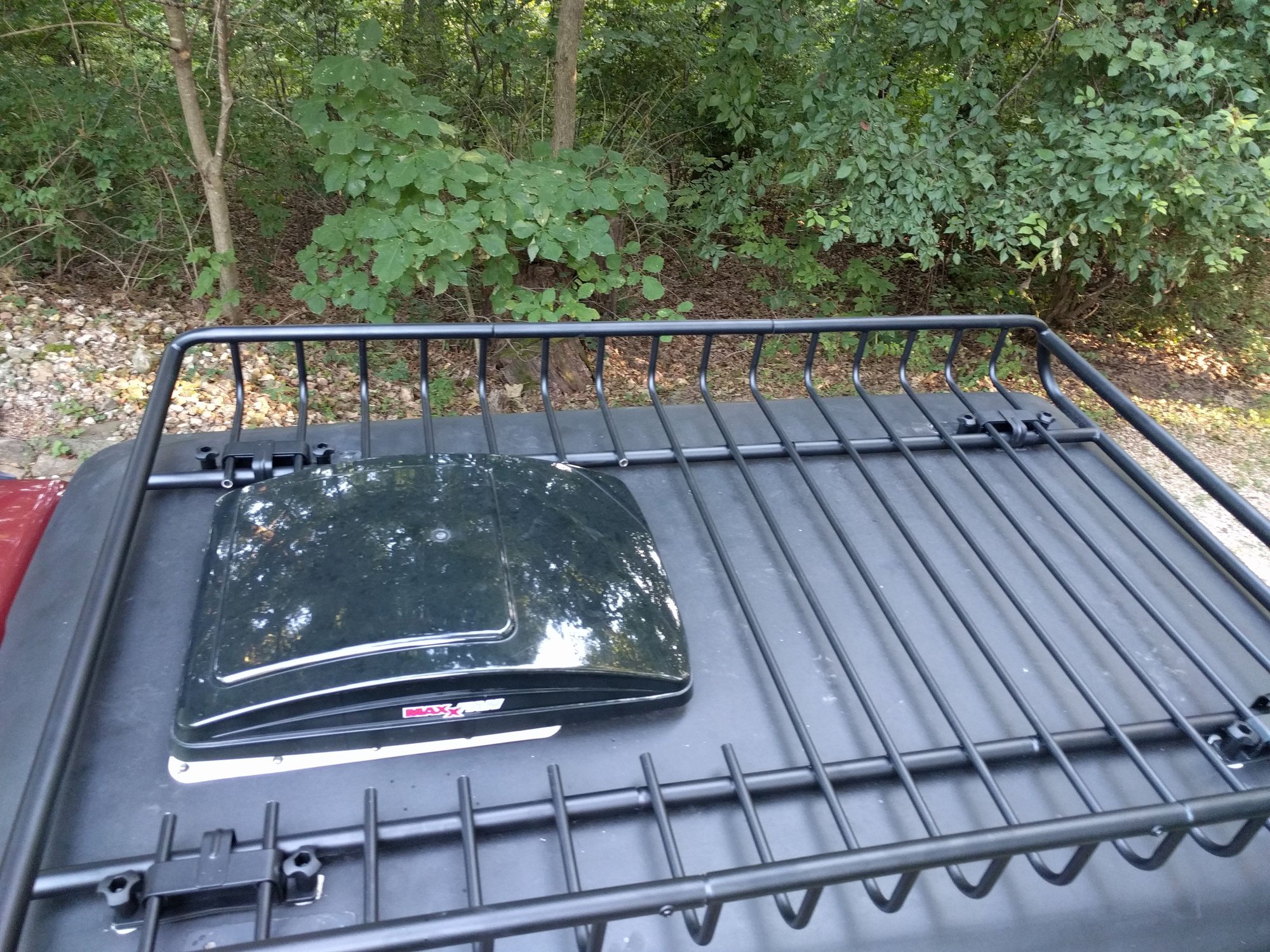

Well, I got it pretty much done now.
ARB awning mounted to the rear of the Yakima Loadwarrior with Fourtrek mounts.
Also got the RoadShower (4) mounted inside the basket which really worked out because the mounting hardware is so close to the shell that you have to use a box wrench to get it on (would take someone 35 minutes to take it off - good theft deterent) and it also blocks the mounting hardware for the basket (more theft deterent). Plus it works awesome, just fill, air up with the compressor, and you have a fully functional shower and sink-sprayer.
Got the fridge power ran and 12v plug mounted on the hitch (pics to come with the wiring update, or video). I also tied in the truck 12v and Solar and so far seems a success - have a watts-up on order to test total input, but my calculations tell me with truck-DC I'm getting max input of 280watts. Will be curious to see what the watts-up shows. Taking the first shake-down trip next weekend, fingers crossed!
