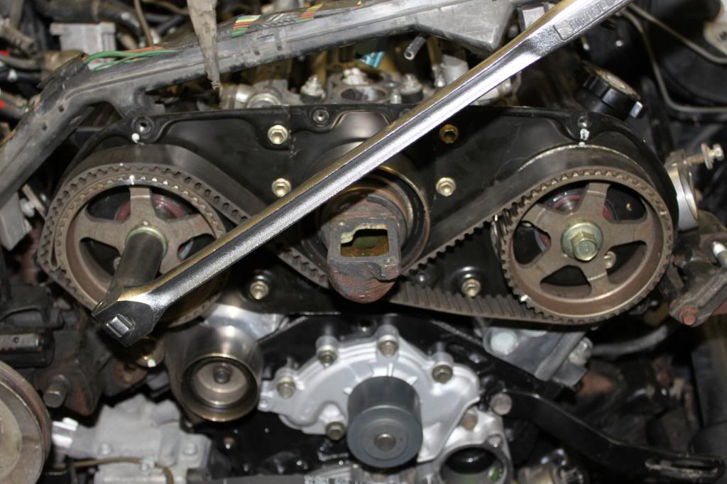

Take the old belt (not the new belt!) and anchor it around some fixed object that is strong enough to take the force. In this picture, that would be the pulley on the right. Then wrap it around the pulley to be removed (on the left) as seen in the picture.
Attach your breaker bar, and turn counter-clockwise. This will tighten the belt around the pulley to be removed. The harder you torque, the more you increase the force smashing the belt against the pulley (see below). Assuming all goes well, the first thing to break loose will be the bolt. Obviously, you don't want to run the belt around, through, or by anything that is likely to break.

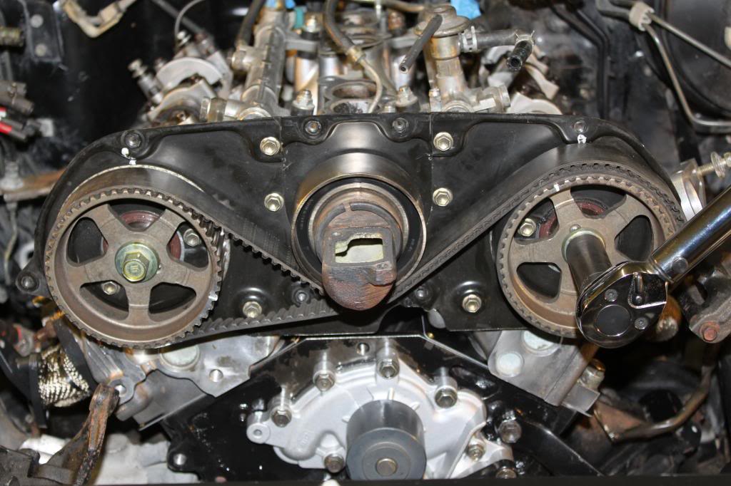

Then reverse the belt and repeat to remove the second pulley (if you have one to remove).

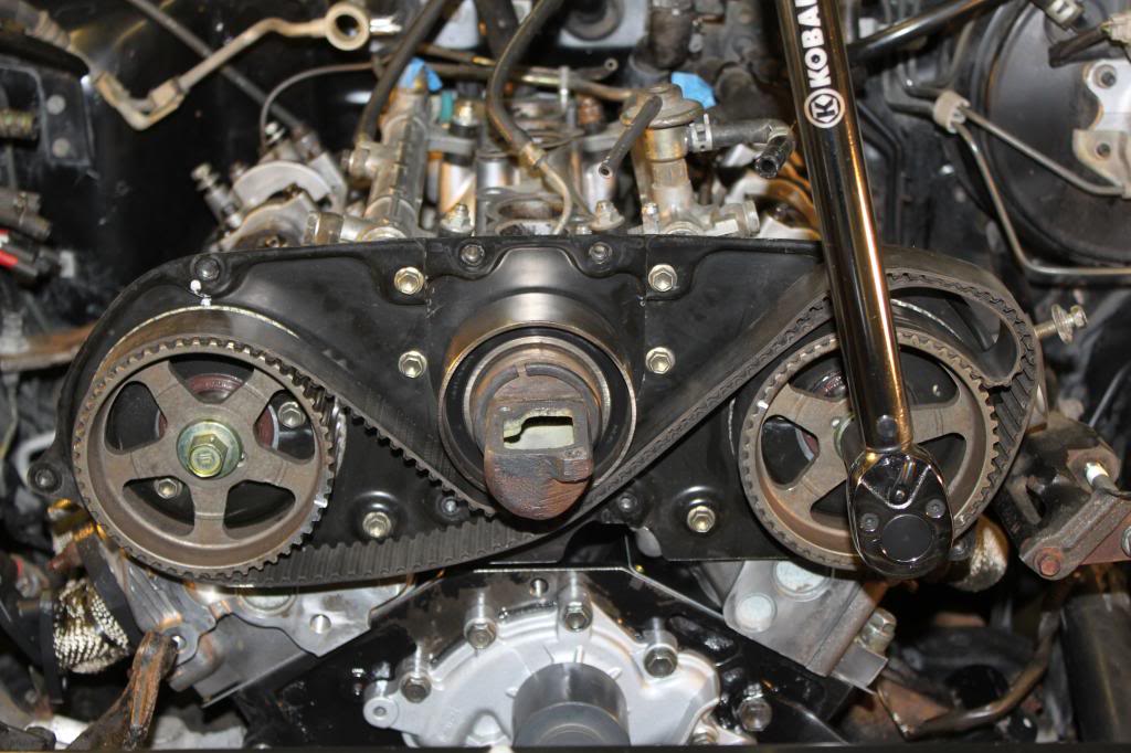

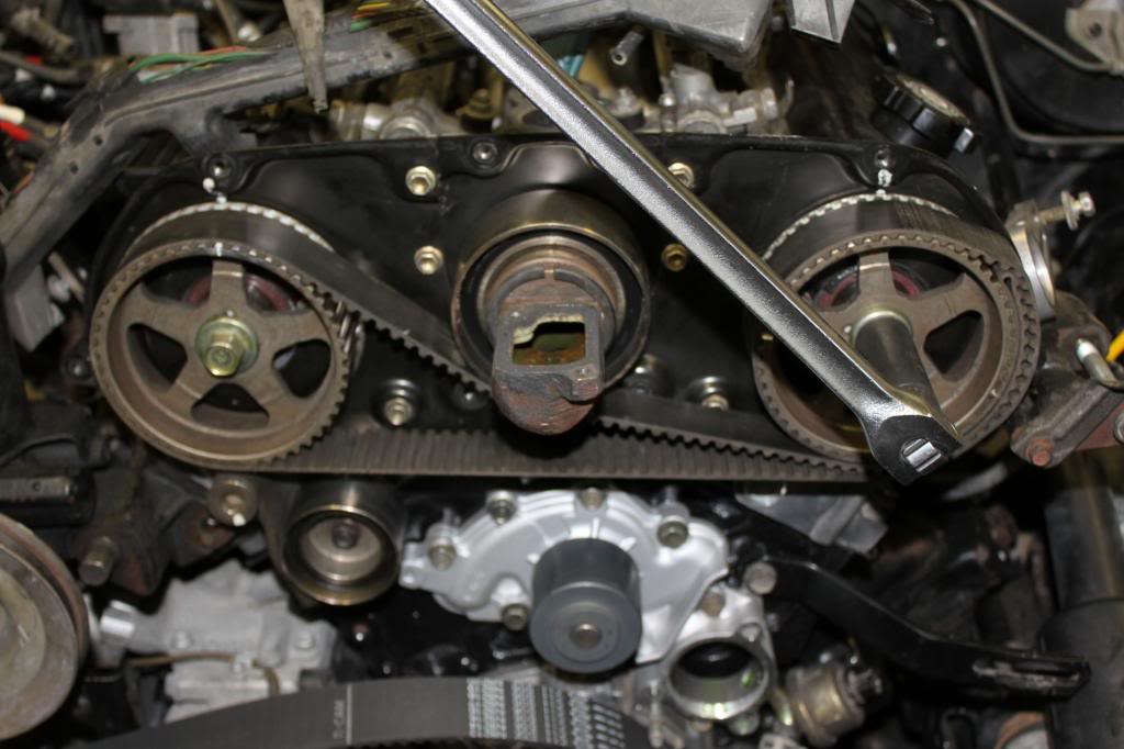

To tighten the bolts, reverse the process. Set up...
...and torque away (but only to the specified value :- ).
