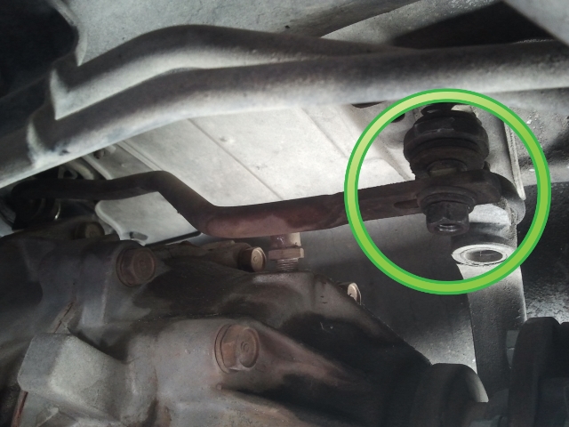

1. From under your 4runner, on the drivers side of transmission, Remove the 12mm nut,lock washer and flat washer from tranfer case shifter rod.

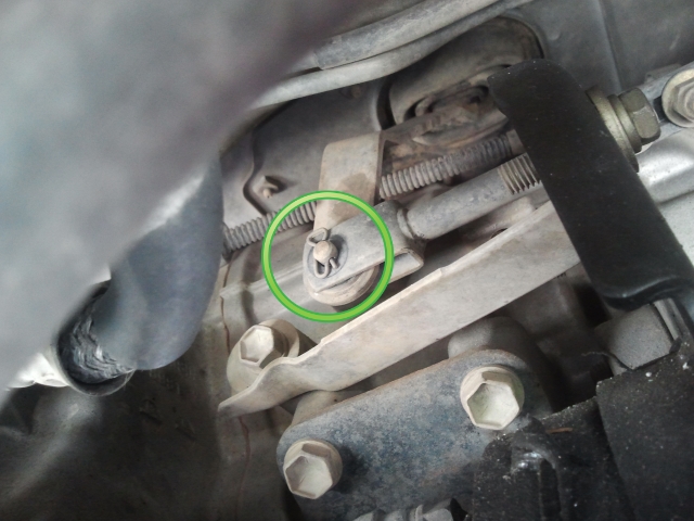

2. From under your 4runner, on the passenger side of transmission, remove the retaining clip from the trans shifter lever with needle nose pliers and remove pin.

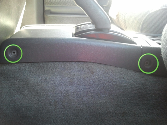

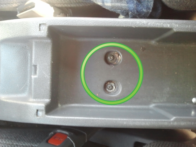

3. Remove the 6 philips screws on the center and shifter console. 2 on each side and 2 in the storage compartment.

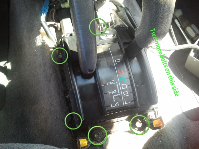

5. Using the 10mm socket and extention, remove the 7 bolts securing the shifter assembly to the floor. 2 bolts on the left, bottom, right, and one on the top.

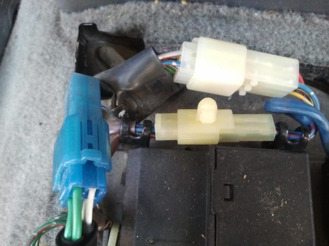

6. Carefully disconnect the large white, and the blue connectors using a small screwdriver to relaese the lock.

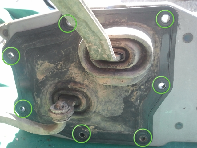

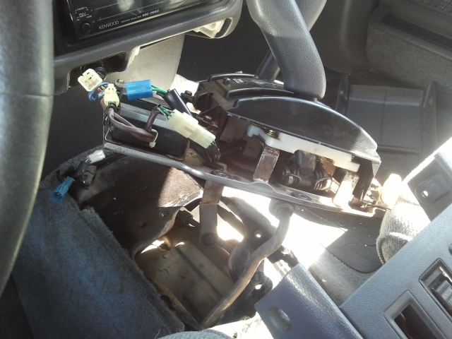

7. Carefully pry up the shifter assembly from the floor. It will probably want to stick a little bit. There is a rubber gasket/boot that is attatched to the bottom of the assembly. Pull the shifter assembly straight up and rotate it about 90 degrees counterclockwise in order for the shift linkages to clear the opening.

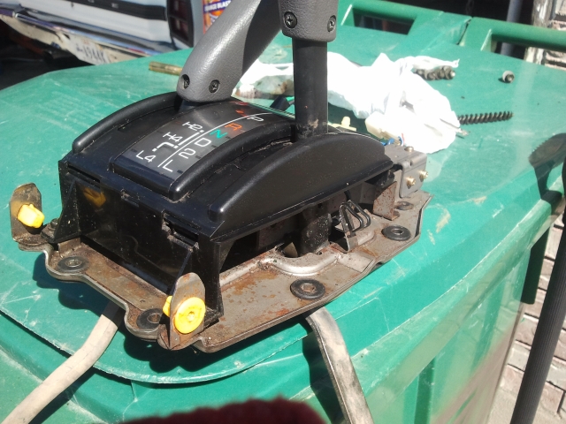

8. The shift assembly is out!

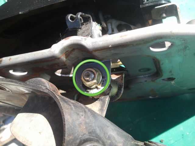

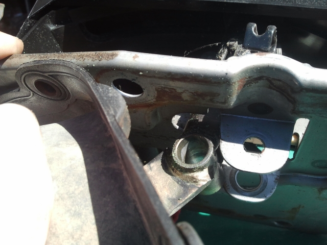

11. Remove the 12mm nut and push out the pivot bolt. Slide the shift arm out of the bracket and clean the pivot hole of whatever (if anything) is left of the old bushings.

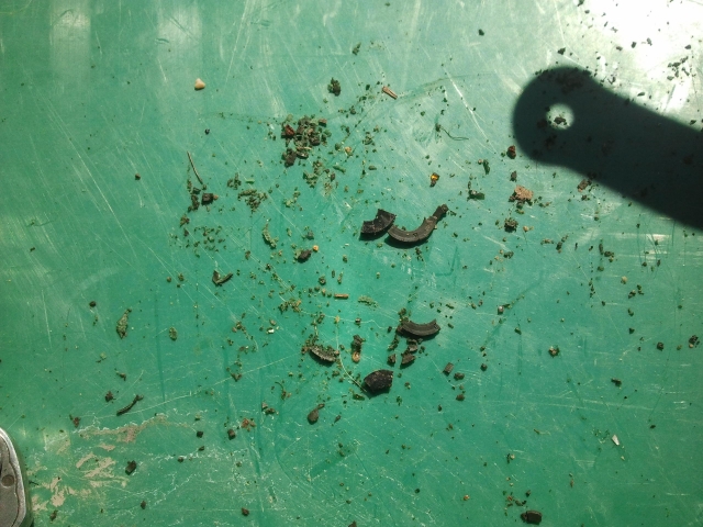

This is what was left of mine.....

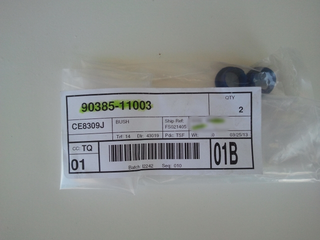

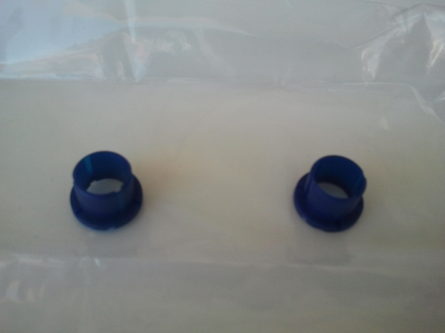

New $3.03 bushings!
12. Push new bushings into the shift arm, slide the arm into the bracket, make sure the bushing and hole line up nice and push the pivot bolt in. Tighten the nut.
