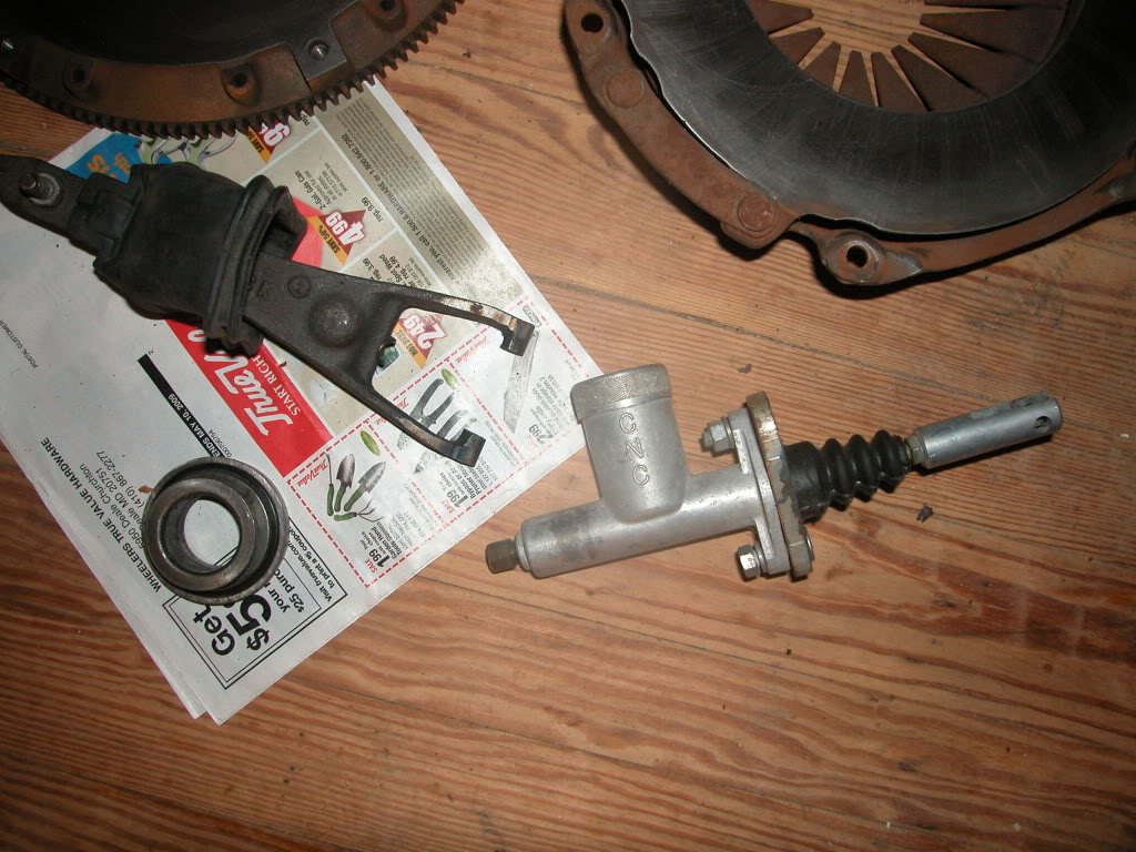

Originally Posted by TNRabbit
Has anyone done a GM LS1 engine swap? I figure since the aluminum block weighs about 48% of the iron block, there could be substantial weight savings...
What is the difference in weight between the 3.0 3VZE and the LS1? Where can I get a bell housing adapted for the R150 manual transmission? Can you use the 3VZE clutch/flywheel? What kind of engine mounts did you use?
Also considering the Lexus 1UZ-FE swap....
Hey Rabbit I have a full set up to toy v6 5 speed for a 153 tooth flywheel but you can get a starter front gear piece to go to the 160 flywheel if interested.
