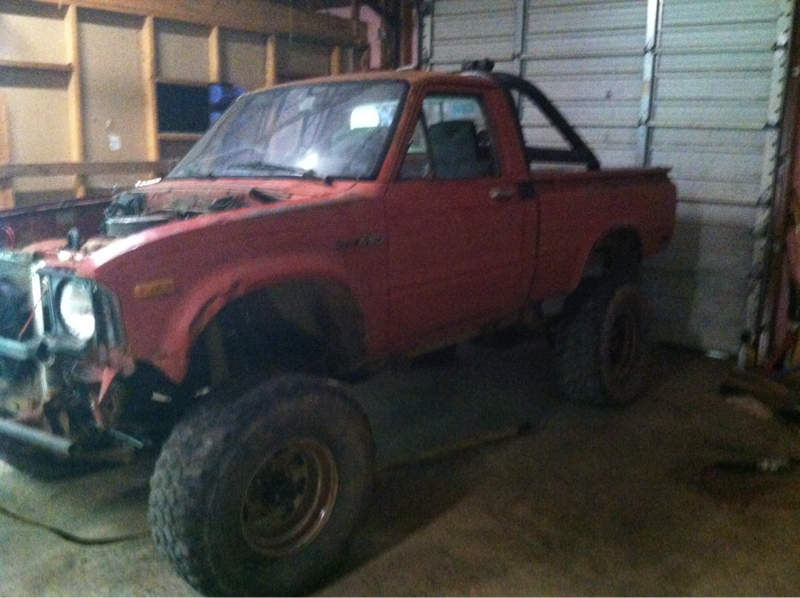

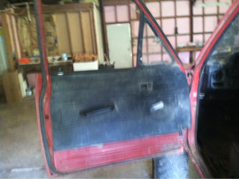

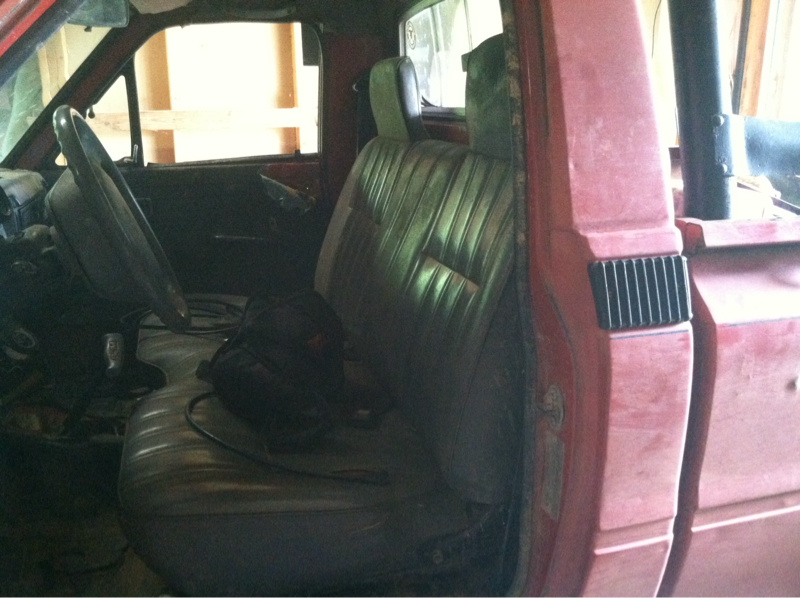

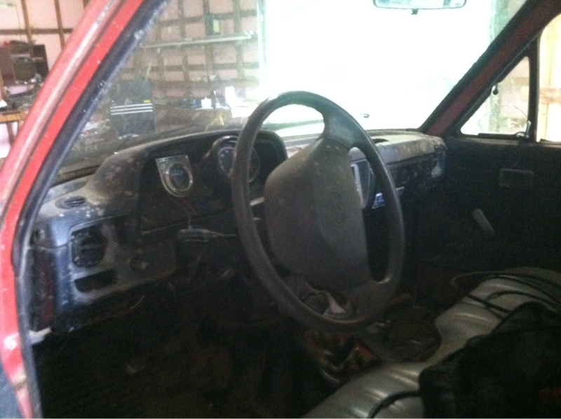

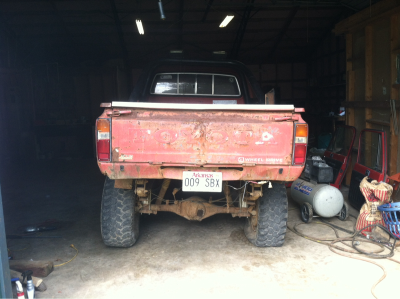

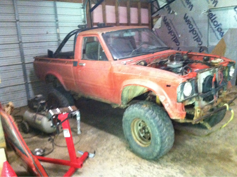

Well it has a lot more rust than I originally thought kinda debating on what to do
