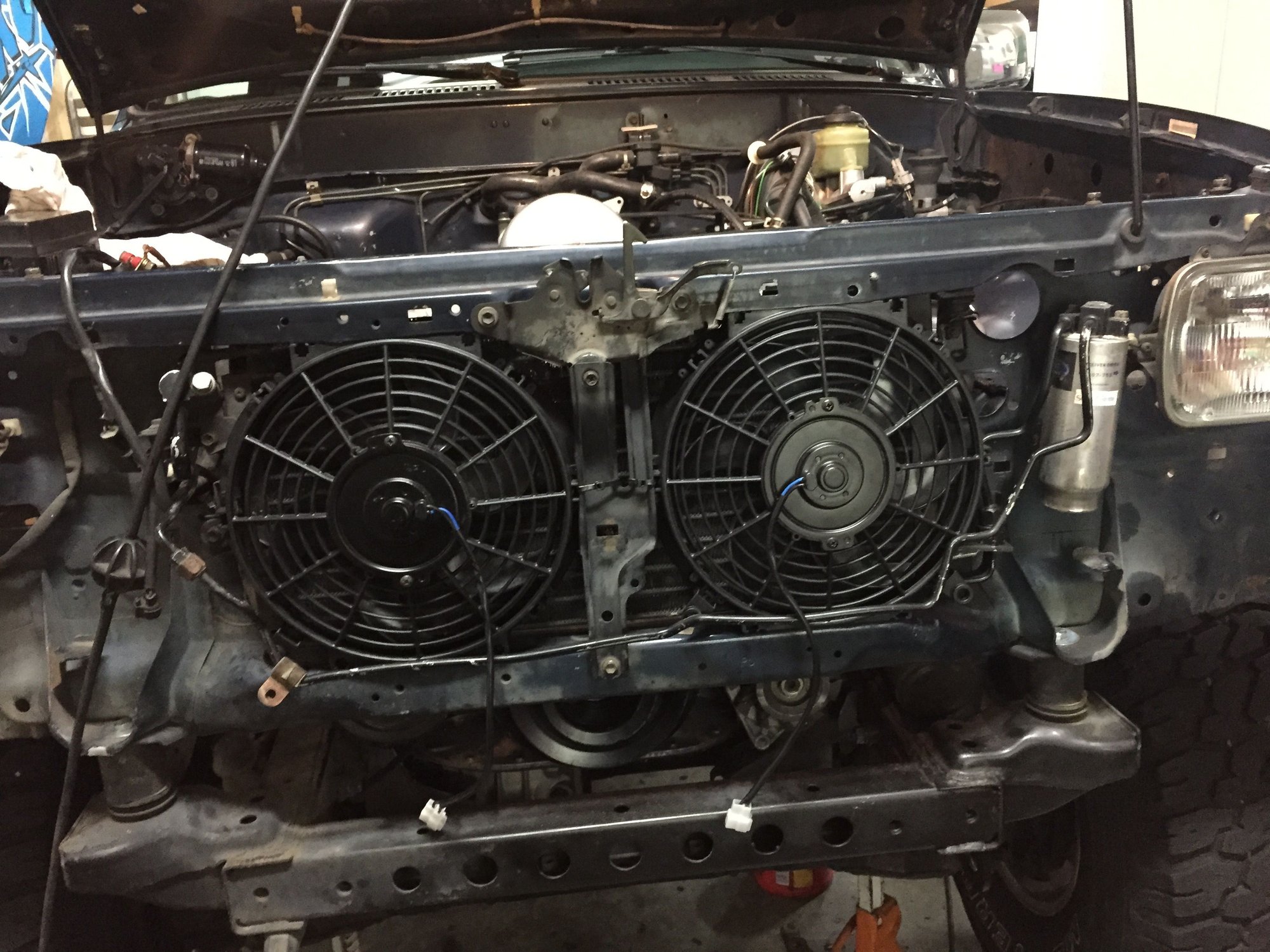

From my understanding the glow plug control module has a timer that will automatically cut power. I plan on hooking it up to a 12v key on wire that I cut from the ECU and have no use for. Hopefully it all checks out. Today Im going to pick up a couple 10" pusher fans to mount in front of the A/C cooler and hopefully it will cool the radiator enough too.

The only recommendation I can give on electric fans is going with the Taurus fan. The key to an electric fan is the sensor and the wiring. The fan is only as good as the wiring feeding it. Most sensors just stick into the cooling fins of the radiator. They typically only last a couple years. You will get what you pay for when it comes to the fan sensors.

My two 12" fans seem to move enough air, engine had no problem staying cool for test run today in 90 degrees only 1 fan kicked on.

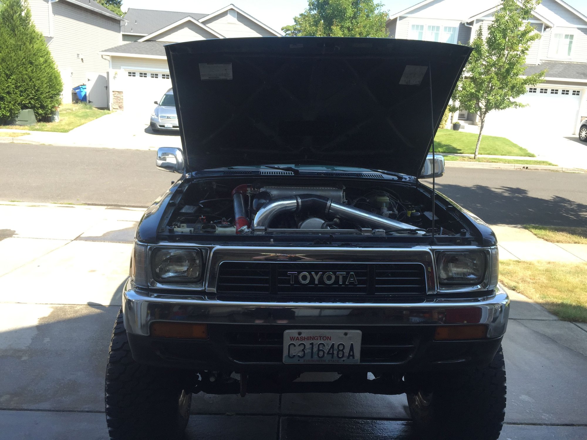

Been working on the truck here in there lately. Yesterday i got a huge chunk of it done. Basically all i have left is oil cooler lines and mounting the cooler. I also have to run hoses and wiring. I ended up cutting the oil pickup tube and rotating it and cut the pan quite a bit more than how i got it, have no idea what they were thinking.. I mounted the radiator and it looks like its meant to go there from the factory as well as the intercooler and cooling fans.
Intercooler cut out. I bought a hood scoop to cover it.
Radiator mounted with rubber in between the clamps top and bottom.
Right intercooler bracket bolted to the throttle cable mount.
Left Intercooler bracket as well as a the milled intake inlet.
A/C bracket i made.

I have a M pump on order through dieselmeken and hoping for 200 ish hp. One problem i am having is cooling. Normal driving it never gets hot but when i hit long hills towing or loaded down my temps skyrocket. I know half my battle is my fans not pushing nearly enough air so thats the first approach to fix the problem. We'll see where that takes me.

I have the summit radiator as well which I know isn't the problem. I bought a top of the line thermostat and tested it so I'm good there. I'm 99% sure the radiator isn't getting enough air after looking at the grill and feeling the fans barely moving air. Thanks for the compliments!!
