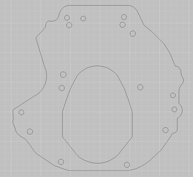

That is one of the biggest things that I have noticed with regards to those who currently are offer these conversions is how poor their customer service is. Initially I was going to use a TDswap kit but after failing to come in contact I decided to make my own. Here is a picture to show I'm not just blowing steam.

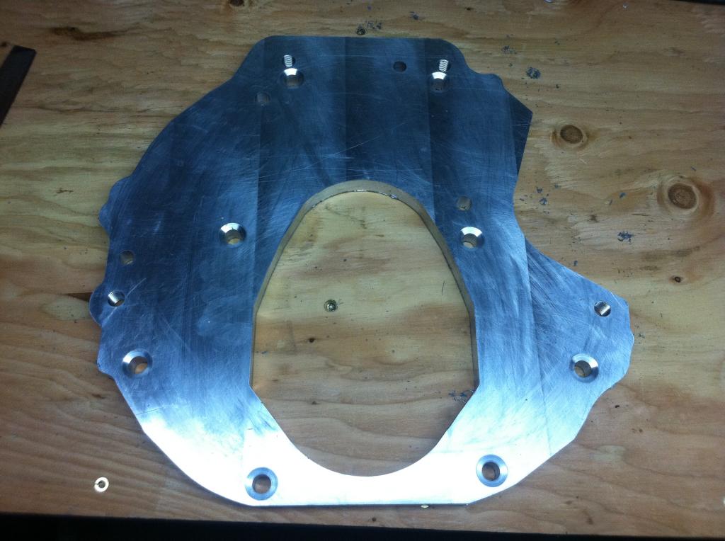

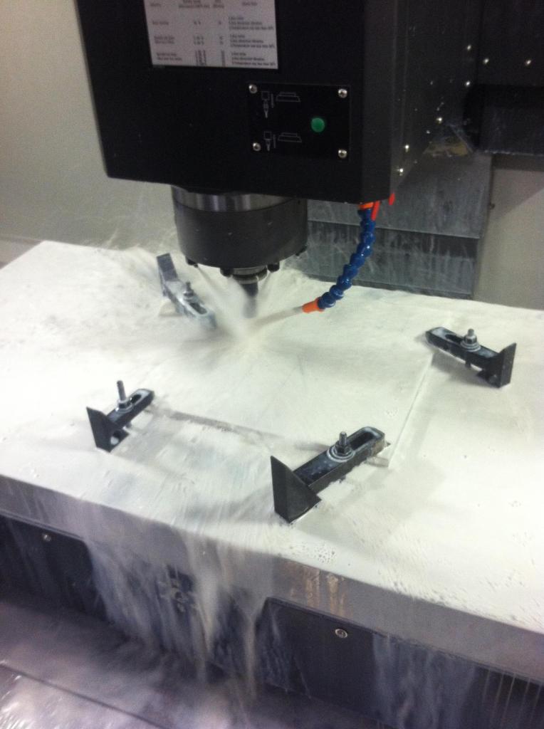

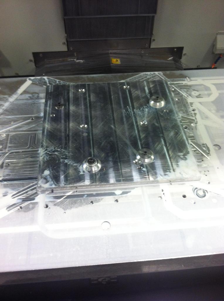

Hey I stayed after work today and worked at a free machine to try out the first plate with a piece of 6061 that was laying around.
Subplate envelope
Action shot
Clamps off
Finished prototype
