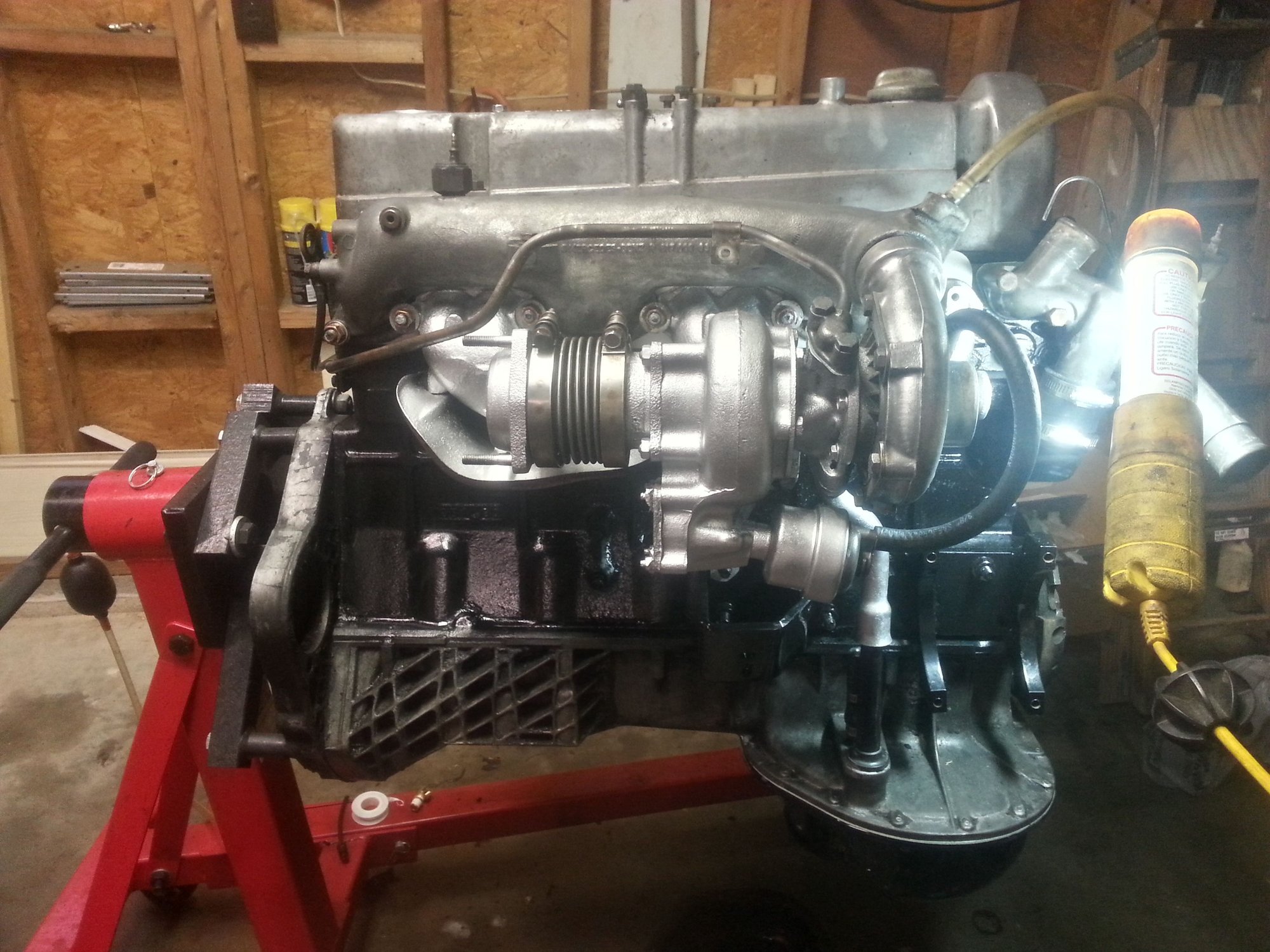

Now a bit about the donor motor. It came from a 1978 300SD. I had the seller do a compression check before I bought it, which checked out. If these motors have good compression, there is not a whole lot else to go wrong.
I immediately set about cleaning up the motor (lots of Gunk!).

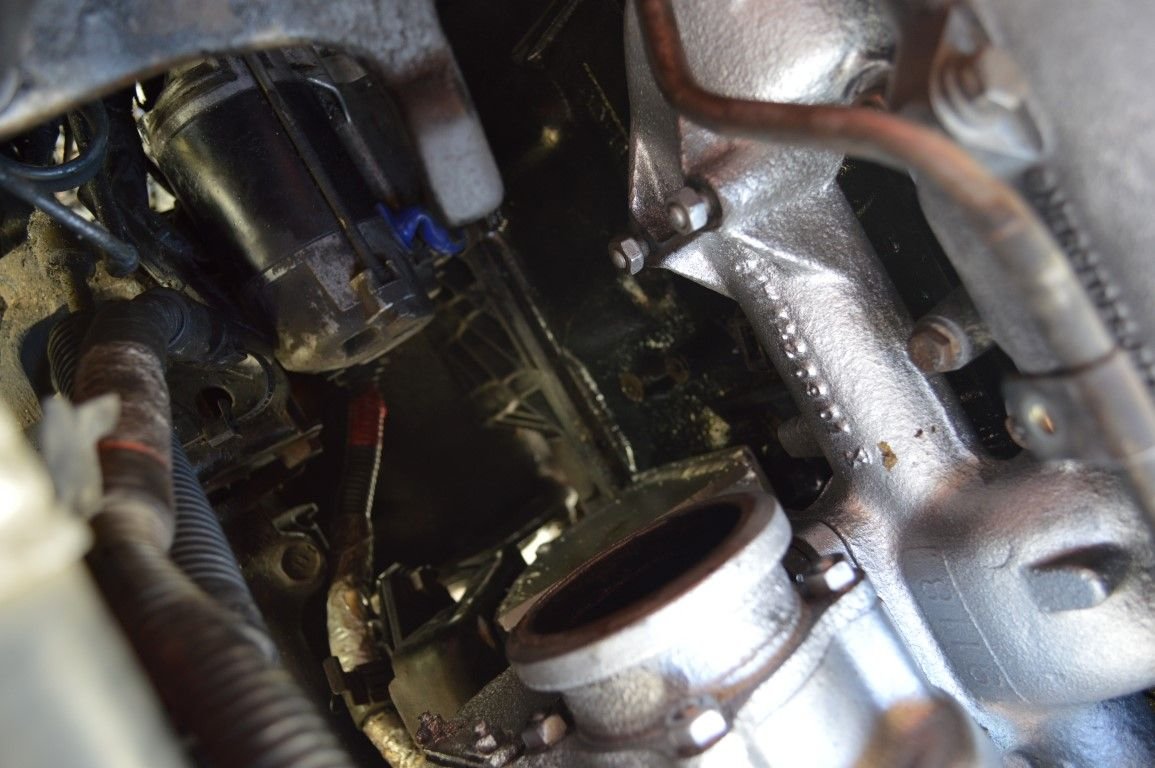

I spent some time doing a proper tune - cleaned exhaust turbine, overhauled and balanced injectors to +/- 50 psi with new Monarch nozzles from Germany, adjusted valve lash, checked timing chain for wear, replaced fuel lines, and replaced front crank seal. I also re-sealed the power steering pump. I wanted to eliminate possible oil leaks that tend to pop up with these motors, so I cleaned and resurfaced oil filter housing mount, turbo return line gaskets, supply line gaskets, and surfaced the valve cover.
Contrary to some opinions, the 617 has plenty of power for small trucks and 4runners even with oversize tires IF it is properly tuned and maintained. My 300SD has more than enough get-up and go to pass uphill on the highway at 75 without downshifting, and weighs about the same as the truck. Most Mercedes I have dealt with whose owner's complained of low power were simply out of adjustment in some way. The good news is they are very easy to work on. A proper tune means balanced injectors, valve lash adjusted properly, timing chain wear within allowable specs, ALDA operating properly and set to compensate for internal pump wear, wastegate set properly, etc.
before
At this point I also installed various small parts I had bought from TDswaps including brackets to allow me to switch AC compressor and alternator, as well as move power steering pump backward. Again, these could be fabricated very easily, but my work schedule forces me to chose money over time often. I also installed a "clearanced" oil pan - more on that later.
