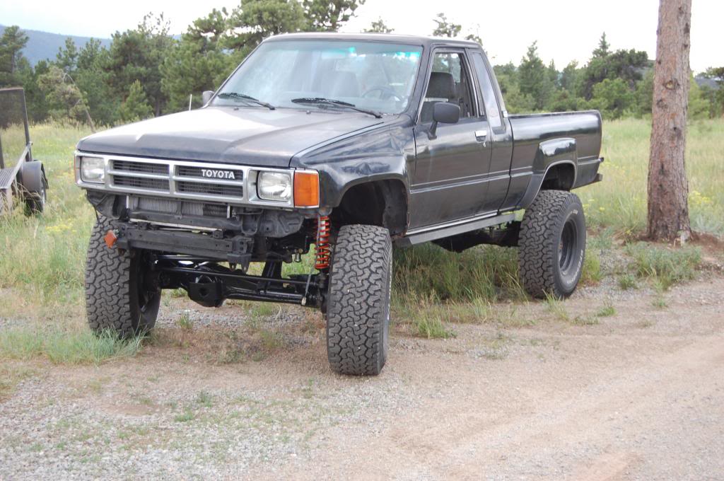

Well, I just finished it up a few days ago, so maybe I can actually get some video now!
Oh, and the transmission situation seems to be working great so far.

Update: I'm at 10k miles on this swap and the motor and transmission are doing awesome. I daily drive this truck about 19 miles one way and about 2000' climb in elevation in the last 8 miles on the way home, so it gets driven fairly hard every day.

I don't have any more pictures. Its been staying cool so far though. It does fine in stopped traffic even when its really hot out. The highest temps I see are going up long hills (like every day on the way home). Even then, it only gets to around 200 at the top, sometimes up to 220 if its a really hot day. I have a fan controller that doesn't kick on until 195 though (turns off at 175), so it always hovers around 180-195, which is about right for this motor.
PM me if you want to grab a beer and talk 7m trucks/compare swaps some day. I'm always up for that.
Also, as a general update, I'm at 17k on the swap, still going strong and smooth. I still haven't ever gotten around to throwing an intercooler on. Too many other more fun projects to work on.

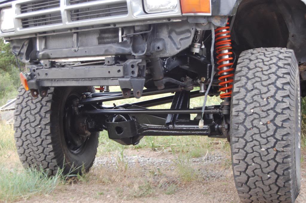

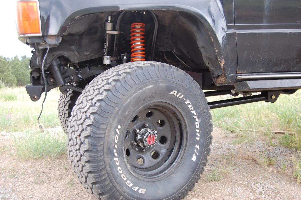

did you buy the stage 1 3-link kit or did you picece some of it together yourself? i really like how it all turned out! sorry i haven't called you to grab a beer yet, i keep thinking things will slow down and i'll have some free time on the weekends but it hasn't happened yet. I will definitely hit you up soon though
Old Oct 8, 2014 | 09:43 AM
  #95
egesledder's Avatar
Posts: 145
From: Boulder, CO
I got the tubeless kit from him, then also bought the shocks/bump stops later on. He wasn't selling the shock mounts when I bought my kit, that would have been nice to have. I saved a little on material and shipping by sourcing the tubing locally and welding in the threaded inserts myself.
I will also say that I think his shock valving is not stiff enough. I know everyone has their personal preferences, but the valving is REALLY soft. I guess my truck is also probably a lot heavier than a 22r truggy, so whatever. My next modification for the suspension will be disassembling the shocks and changing the valving.

The 3-link is pretty nice on the road. Its much more predictable than any leaf spring will ever be in the corners, especially if there are bumps/pot holes. I think an anti-sway bar and some stiffer damping would make it just about perfect. I'm sure linking the rear and valving it properly would help too, but I really don't mind how these chevy springs ride with stiffer 5100 bilsteins.
