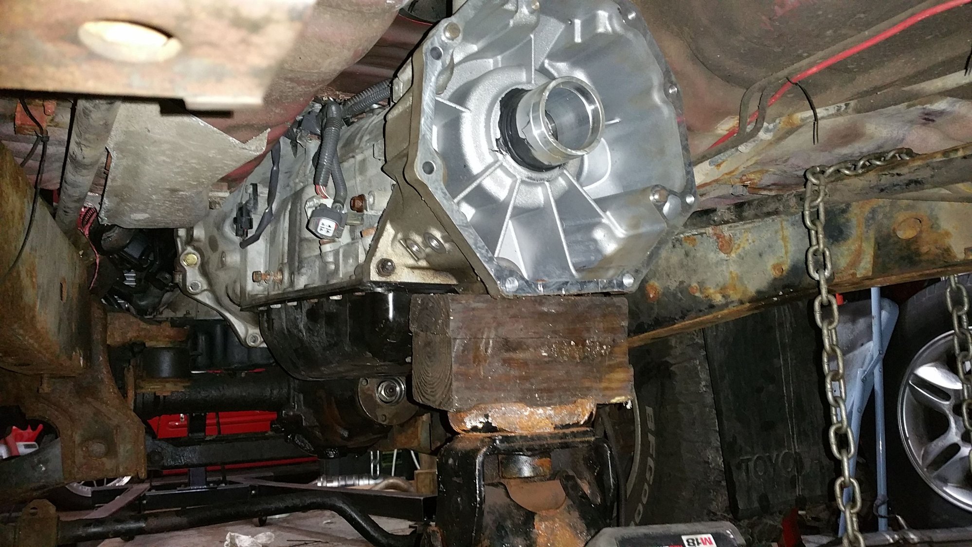

heat wraped the exhaust and reinstalled it back in, and should be the last time it comes out.
radiator to motor clearance, had to modified to radiator core support
i'm using 06 tundra auto transmission and to keep it passenger side drop I'm using low range adapter kit and a 1987 pickup transfercase

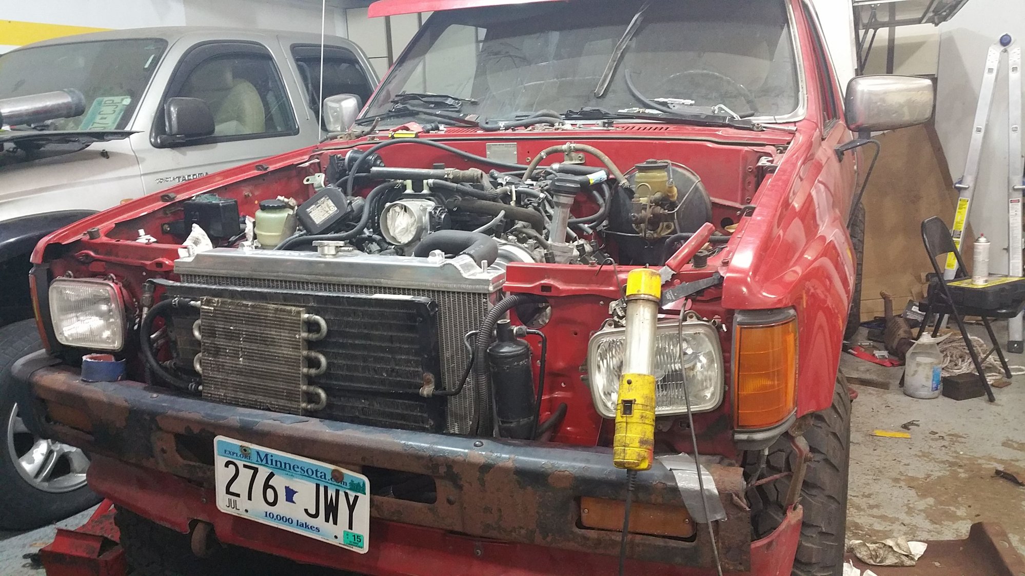

here is some updates. Had to redo to radiator so that i can run fans on the inside and have room in the front for a/c and transmission cooler.
looks like it hits but it over laps

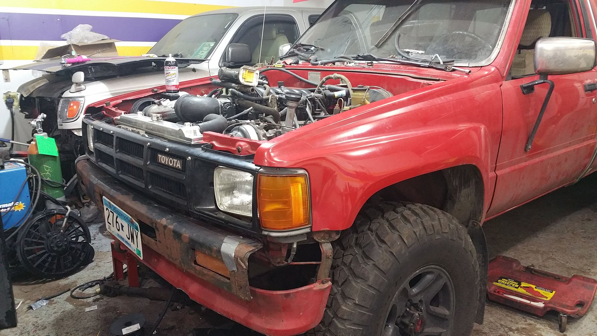

Going to be using the 05 sequoia cluster and started on wiring.
Got exhaust done

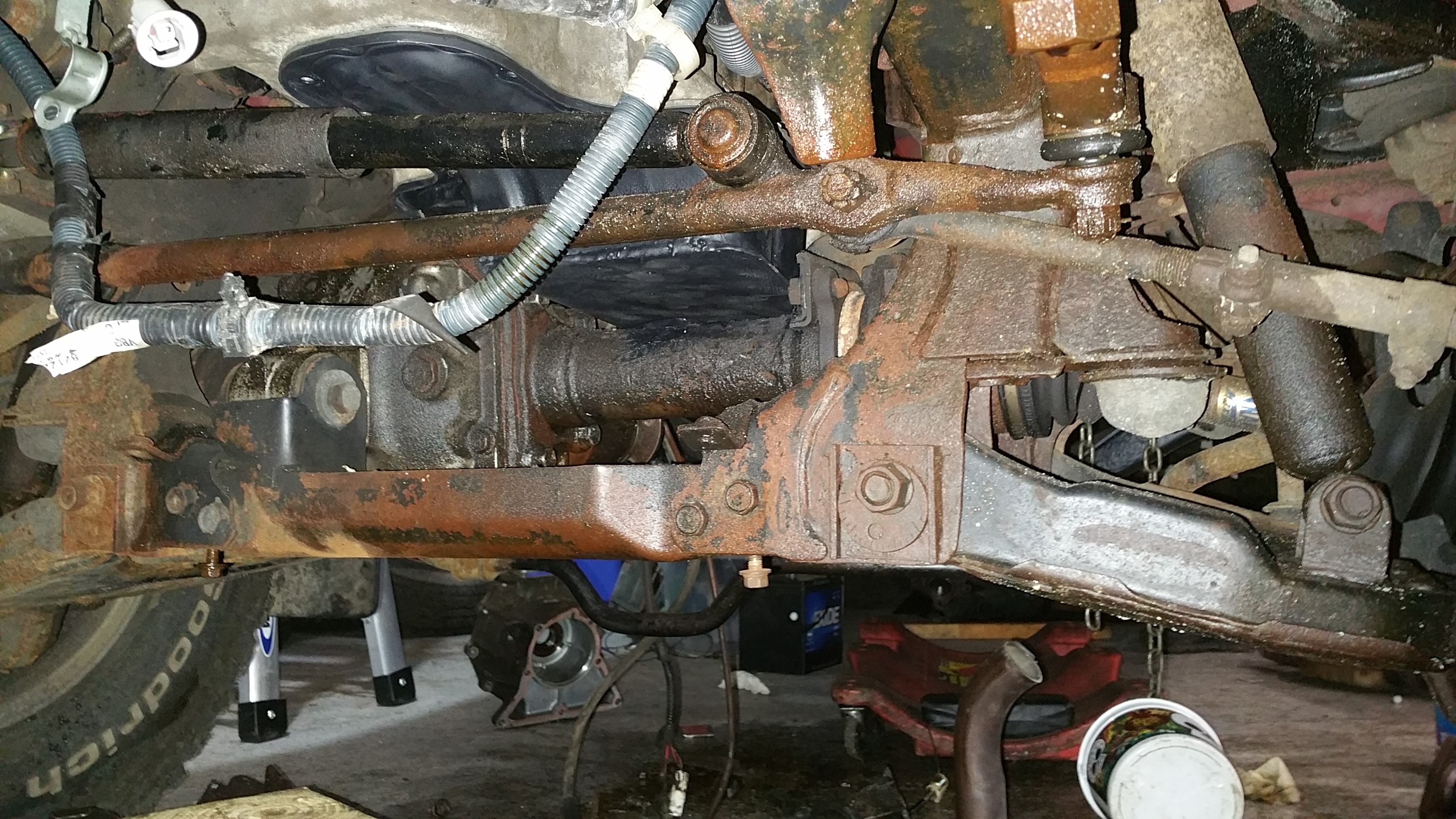

front driveshaft on had pound to transmission pan a little to clear it
i about 90% done. Hopefully start some time this week will try to get a video of it started up
What i need left is a steering with column shifter,shifter cable,and bench seat. My truck was originally manual and am converting to auto. I been looking for awhile now with no luck. Let me know if anyone has these parts.

Finally started it.. The wire was a mess but got though it. will post videos later
