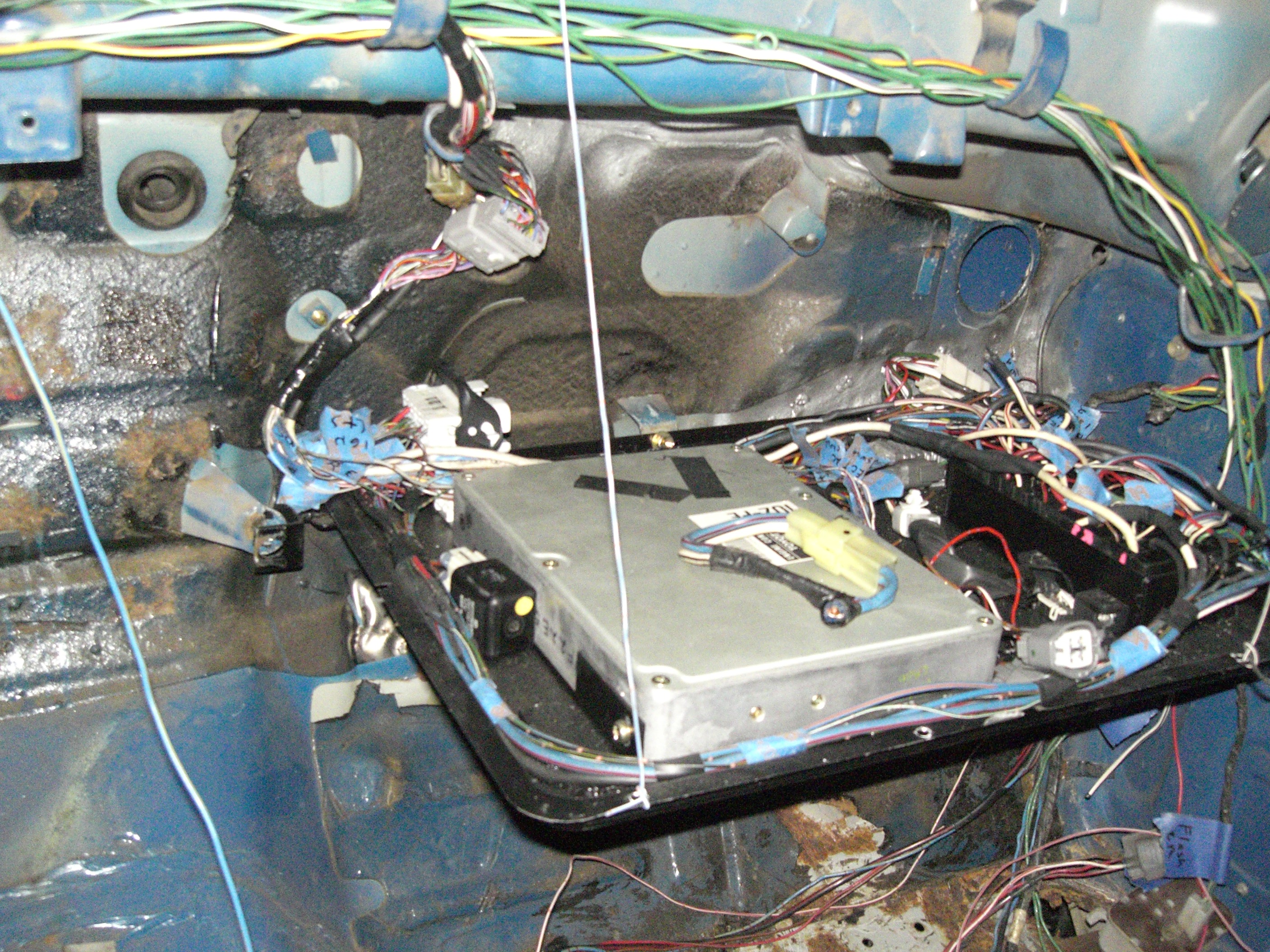

Old Nov 23, 2014 | 10:14 PM
Reynoso's Avatar
Joined: Apr 2010
Posts: 68

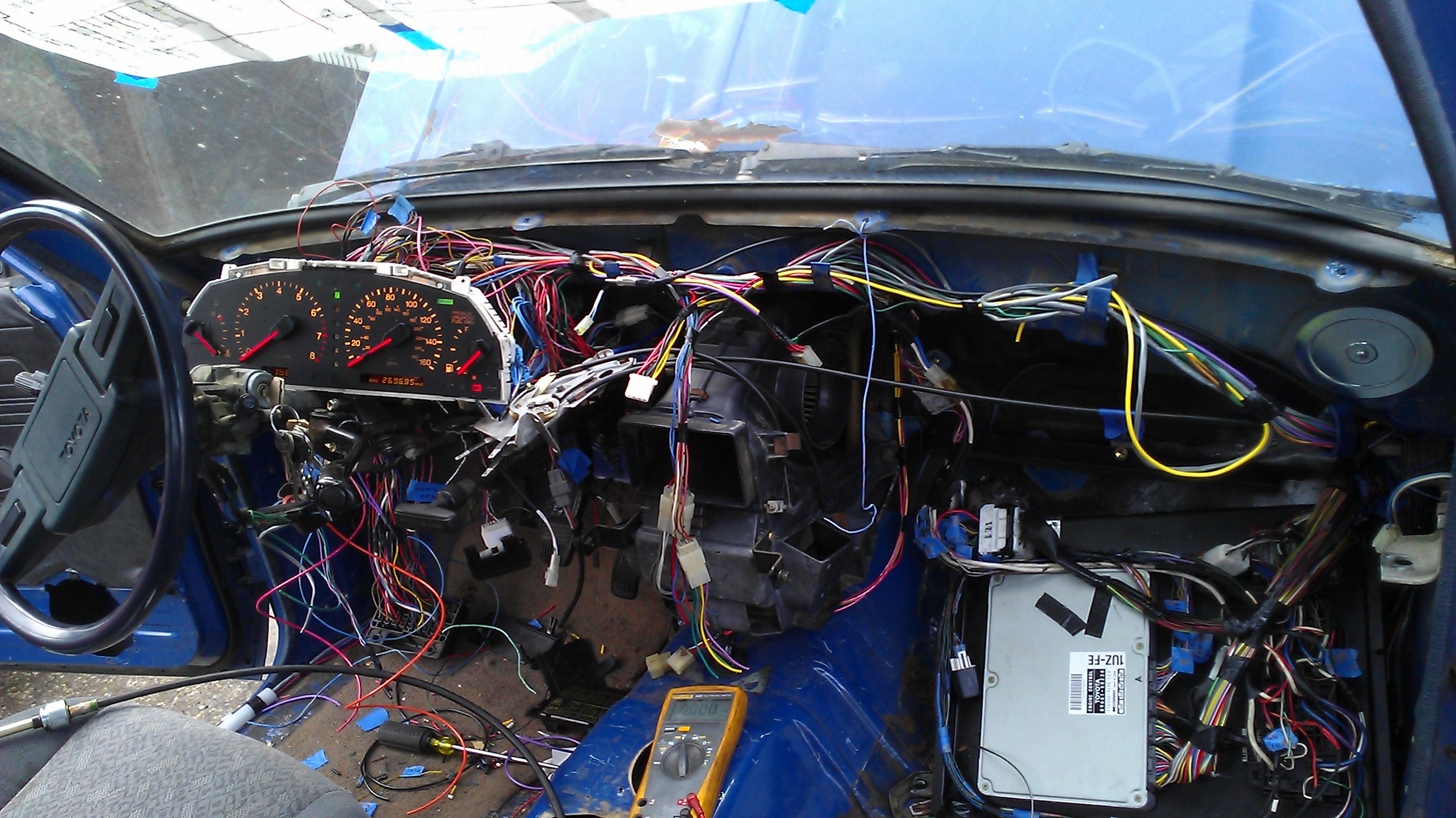

Continue with electrical harness and cleaning the body

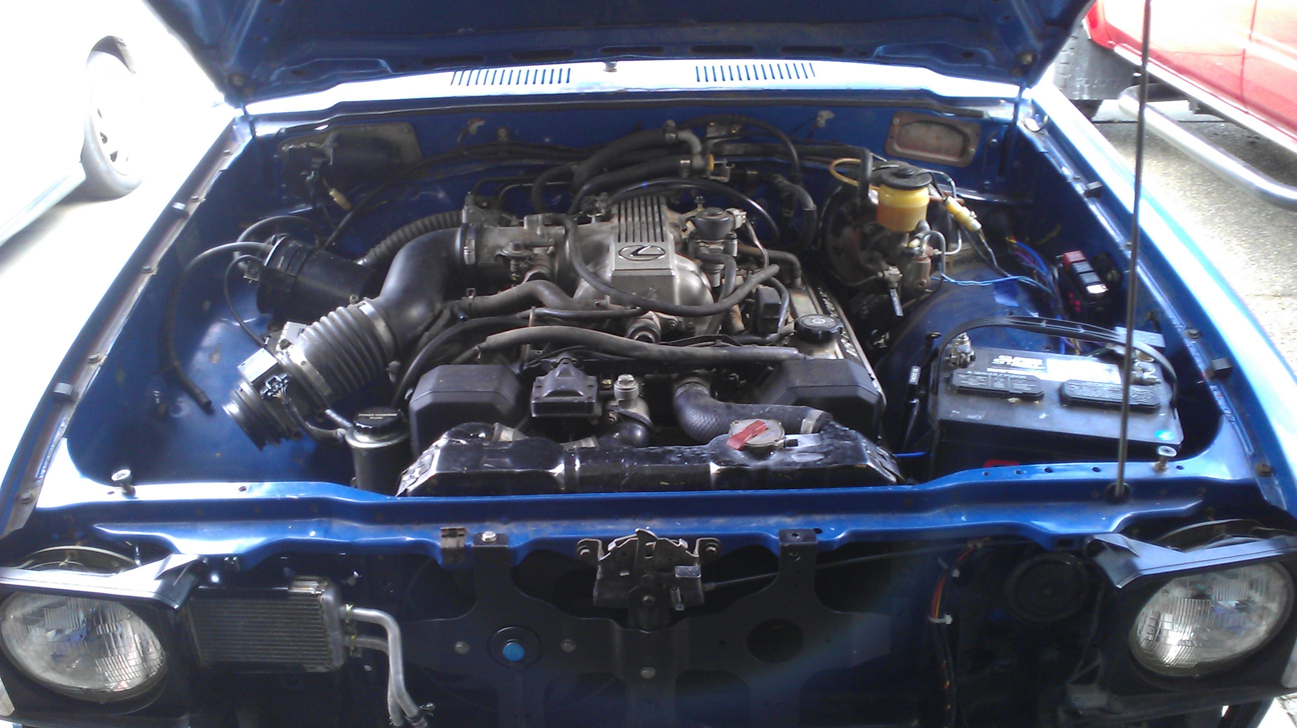

Old Nov 23, 2014 | 10:17 PM
Reynoso's Avatar
Joined: Apr 2010
Posts: 68
Install the engine into the body

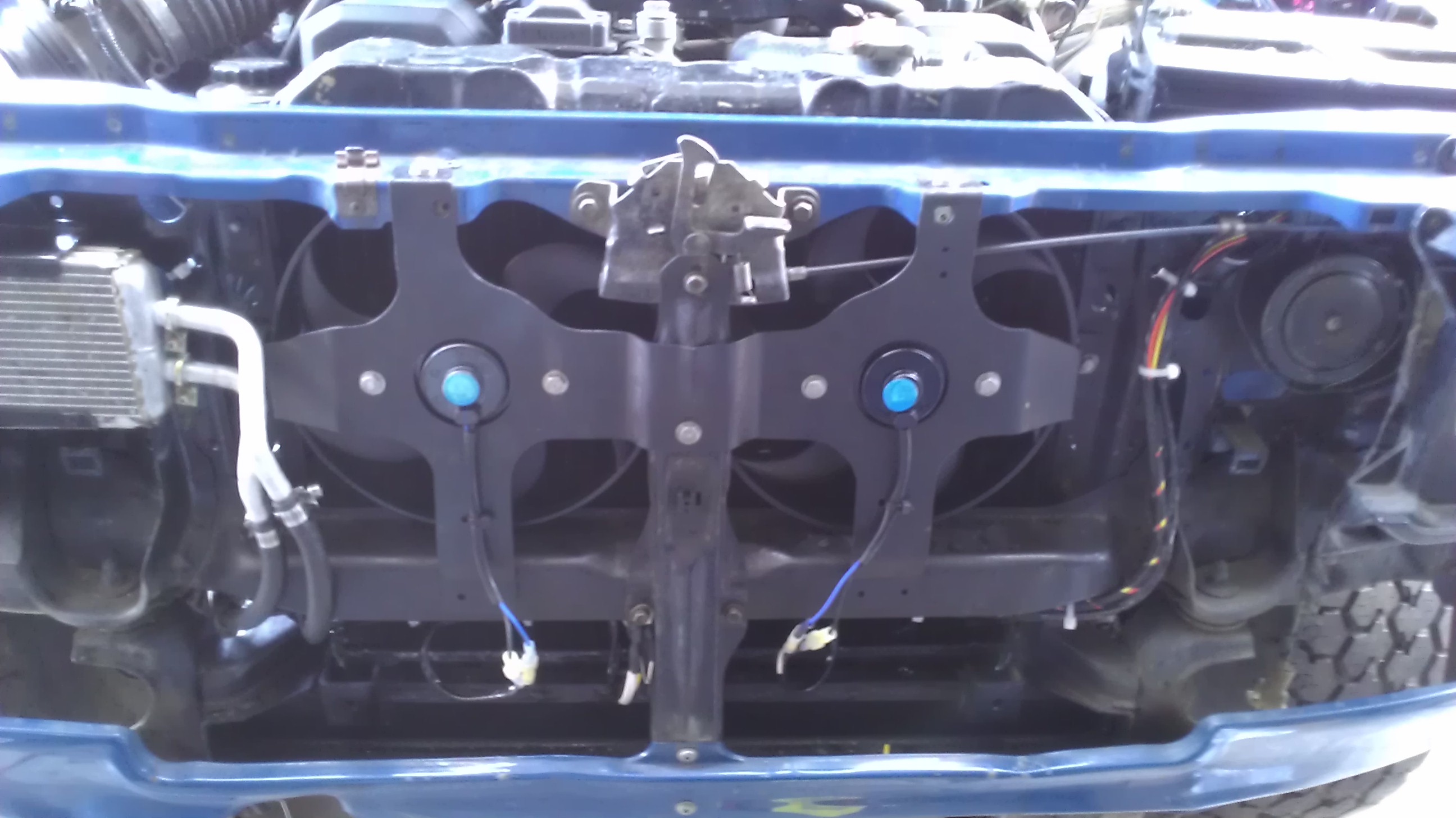

Old Nov 23, 2014 | 10:27 PM
Reynoso's Avatar
Joined: Apr 2010
Posts: 68

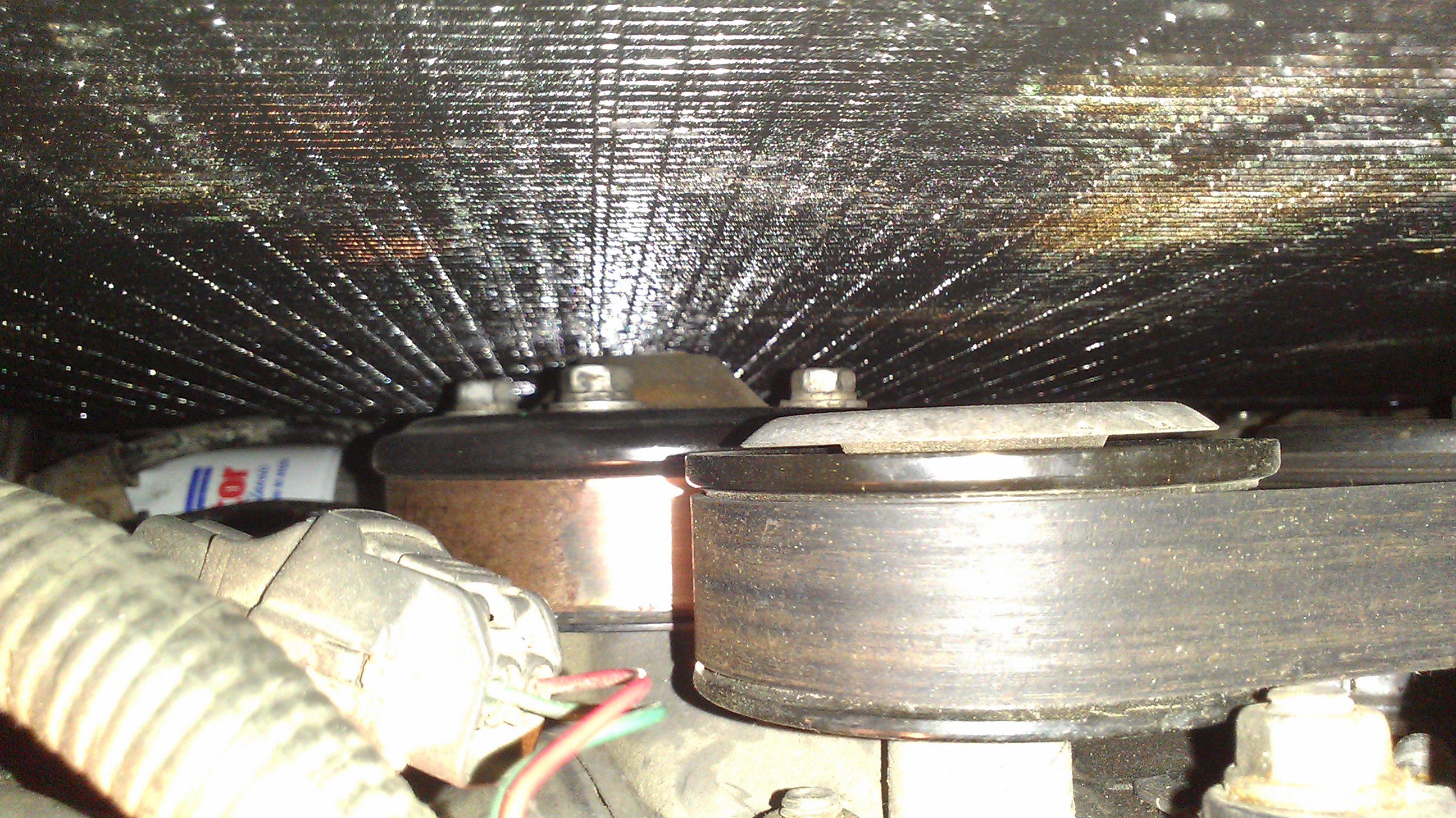

Because the engine and radiator are to close I decide to install the fans in the front 2 10" pushers

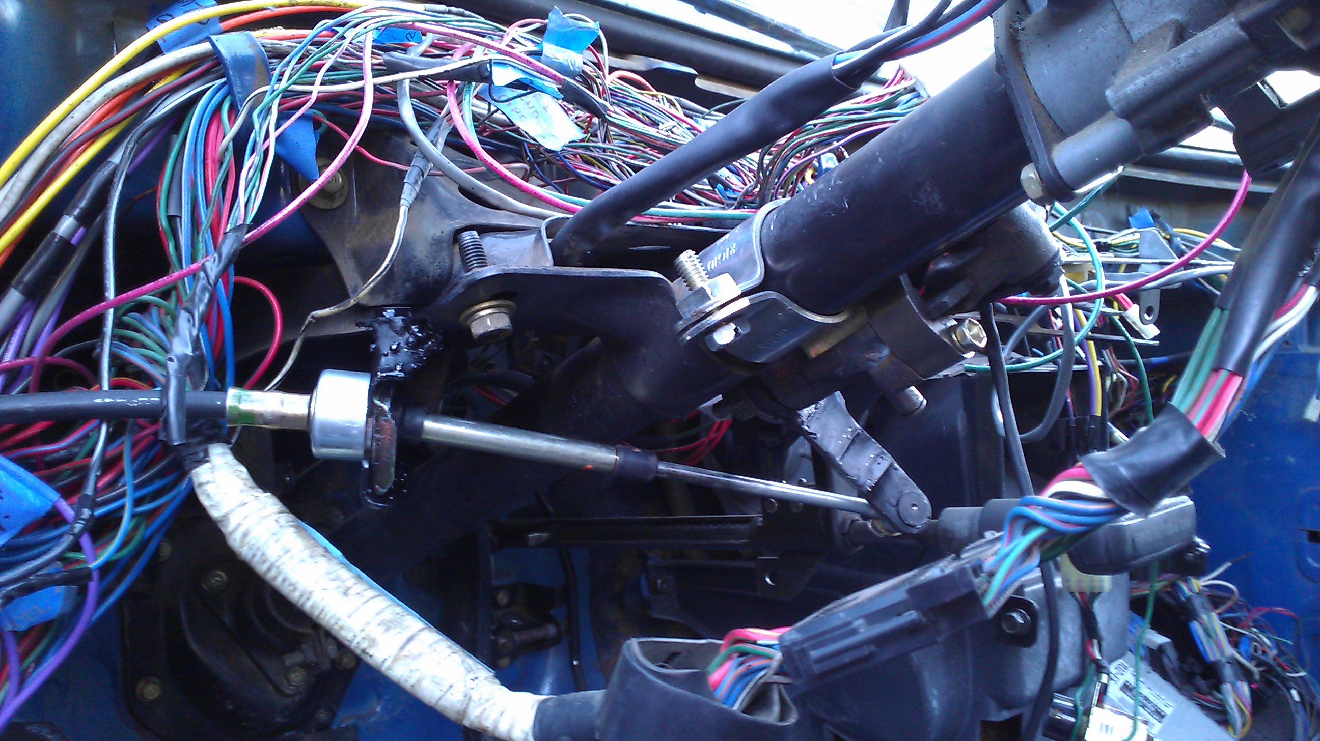

The shifter next to the wiper control switch is my best option off Toyota previa giving good clearance on steering wile .

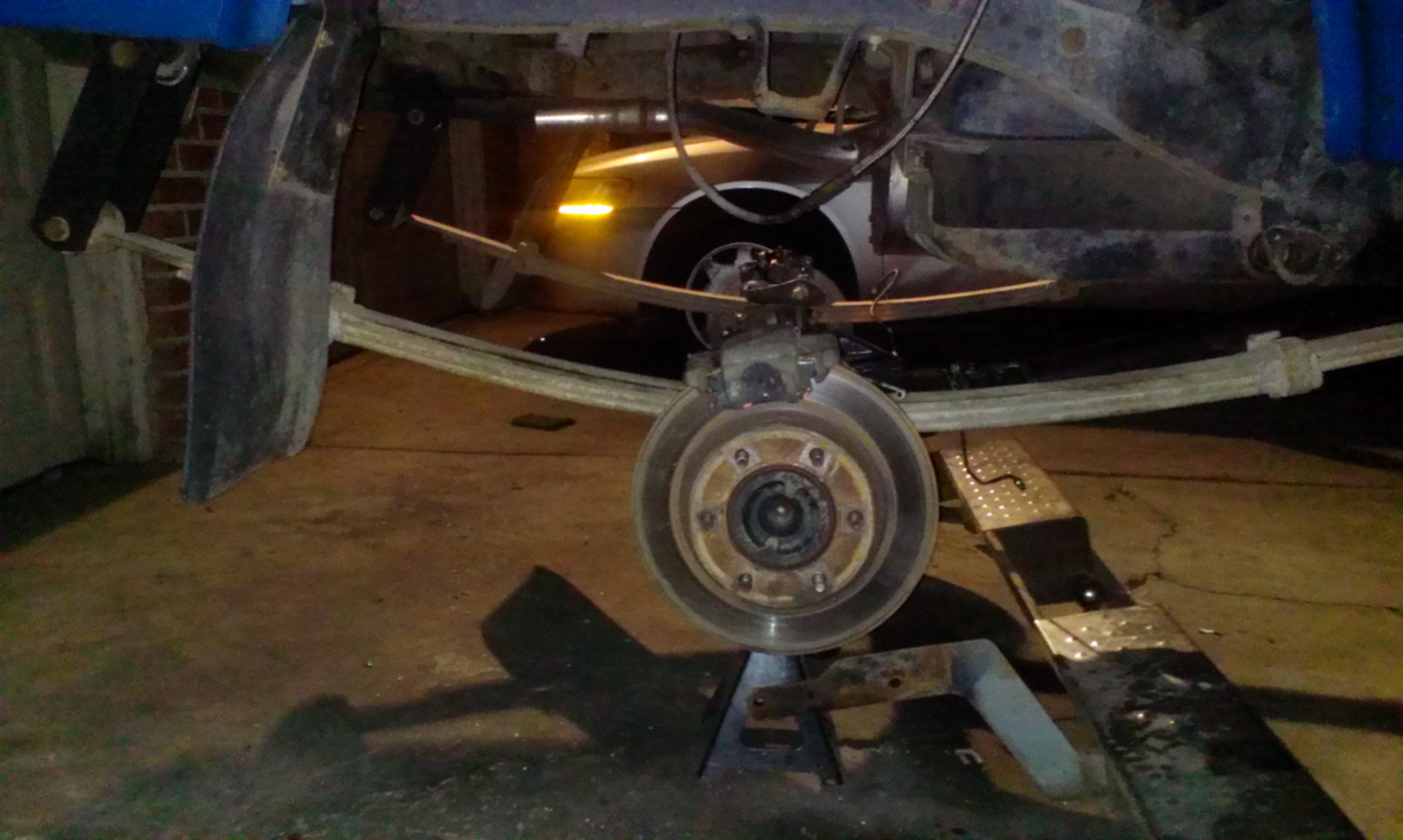

Lifting by Chevy 1500 rear life springs and up grade rear disk braques by Nissan maxima calipers whit e brake by wire works ok

Tnx the wiring dash its complete and I swap the factory cluster for the SC400 ,because is small and easy to install in the opening.https://db.tt/vfzKOndw

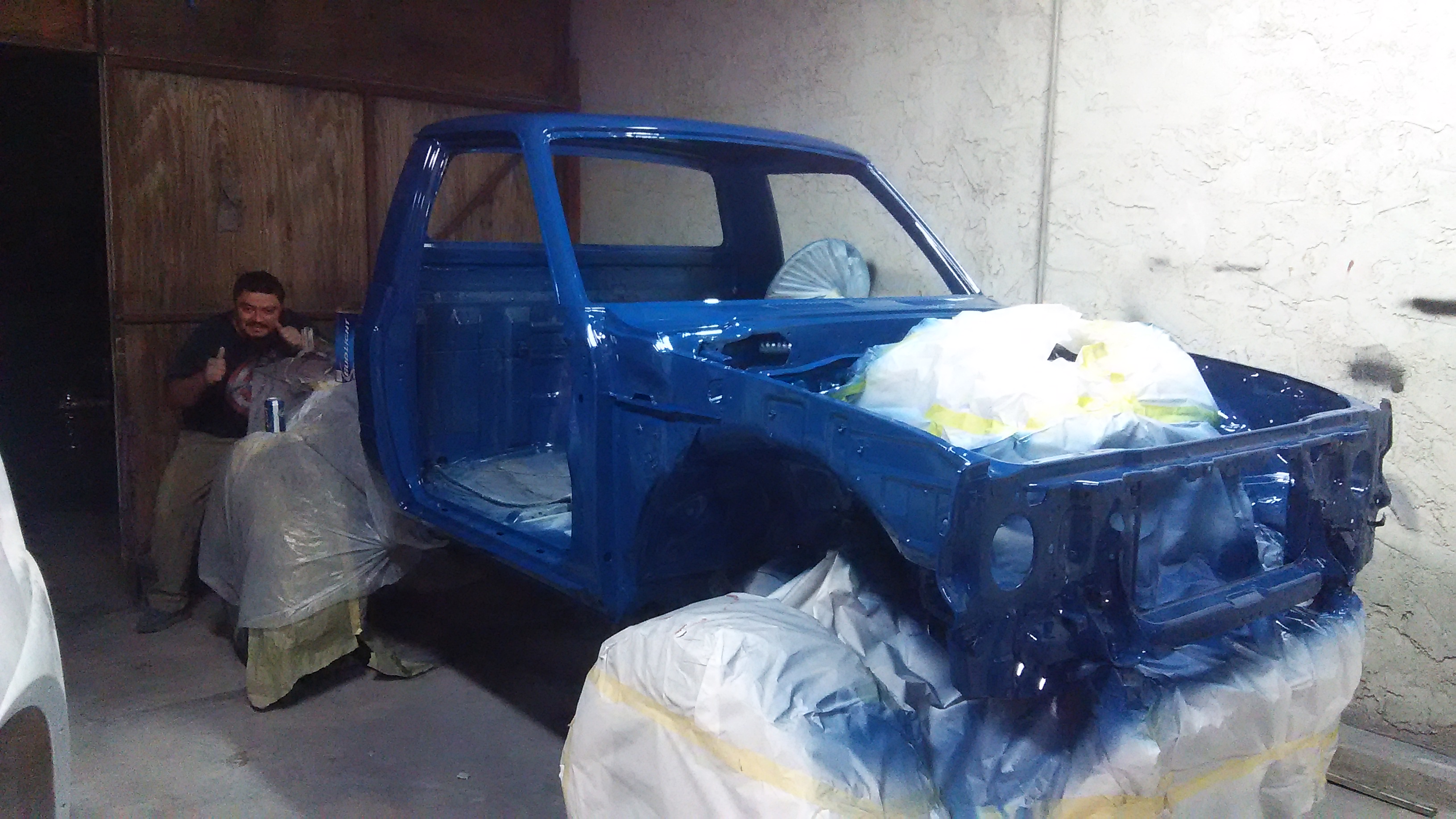

Paint job is complete

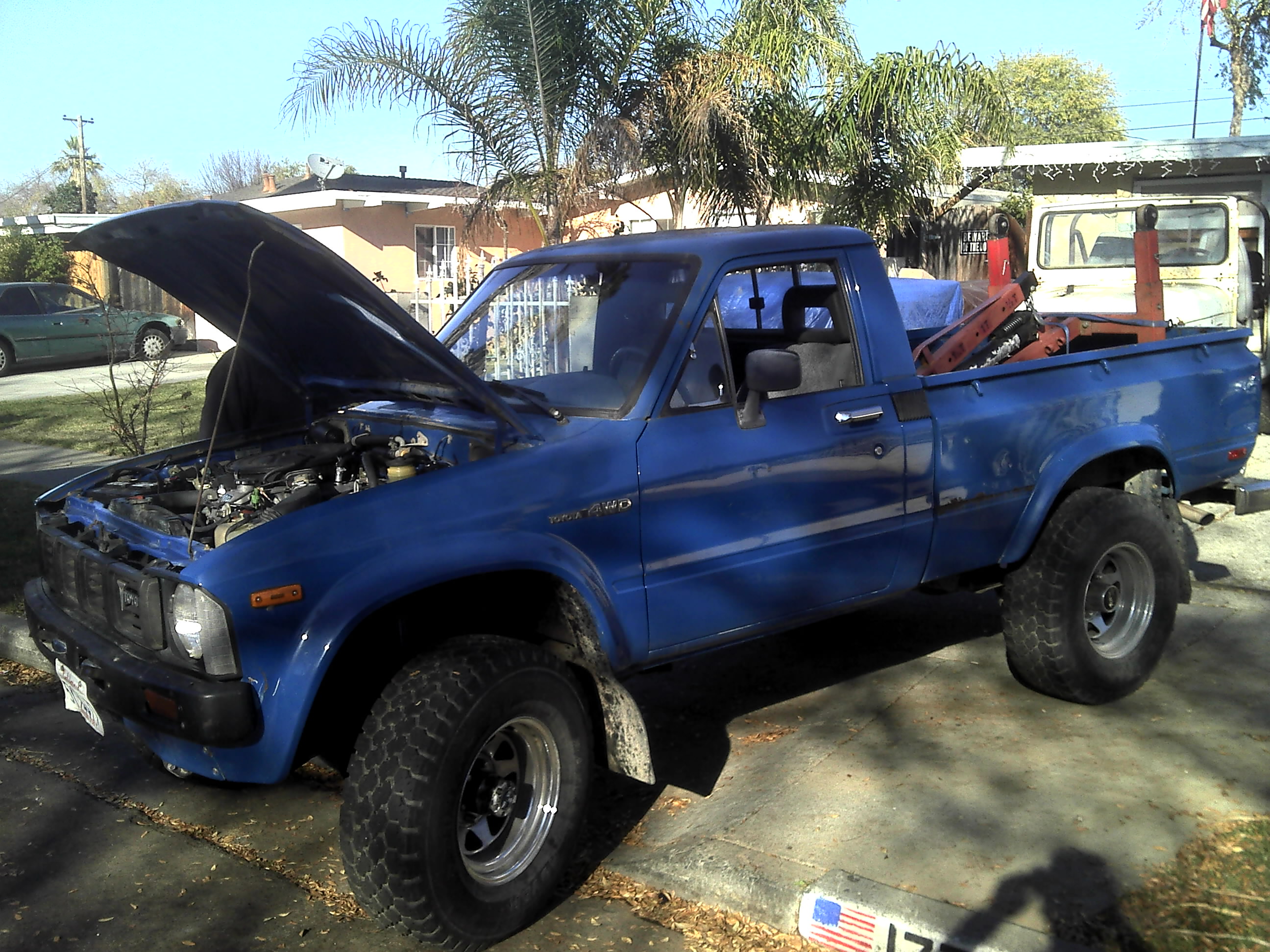

final look
