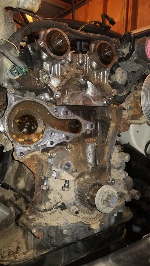

Replaced spark plugs as well. Also put new hardware on the coil pack trays. Driftmotion wanted $3 a screw. I went to local hardware store and picked identical Stainless steel hardware for .40 cents a screw
Went and put a new water pump while it was somewhat easy to do. Cleaned everything under timing belt cover. Actually getting to the water pump takes longer then replacing it. I didn't look far enough ahead to order new timing belt and belt tensioner. Since they only have about 25k on them from when this motor was put in the other 4runner I don't think they'll be an issue for some time. Water pump I order a AISIN pump for a 1993 2jz supra

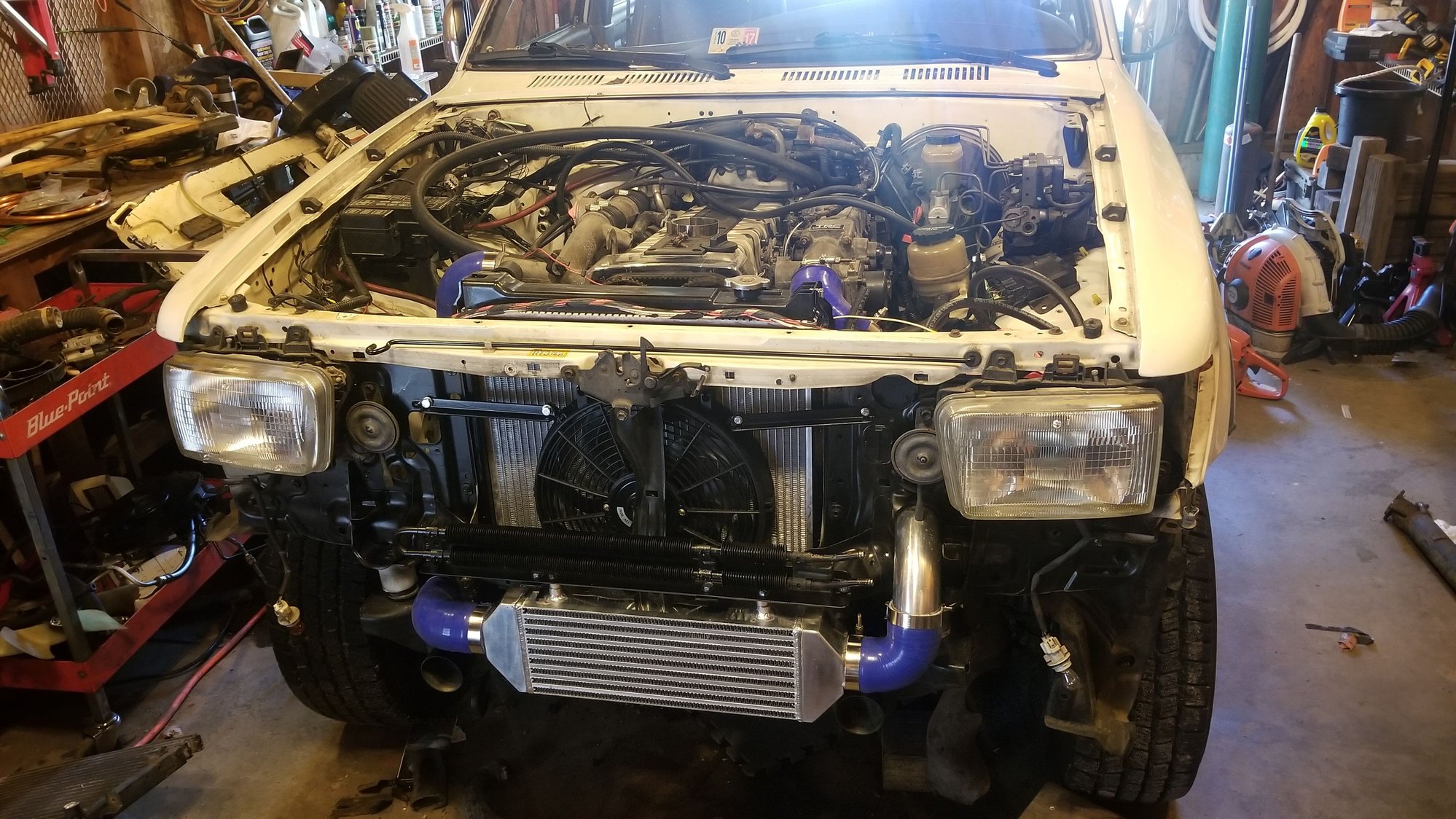

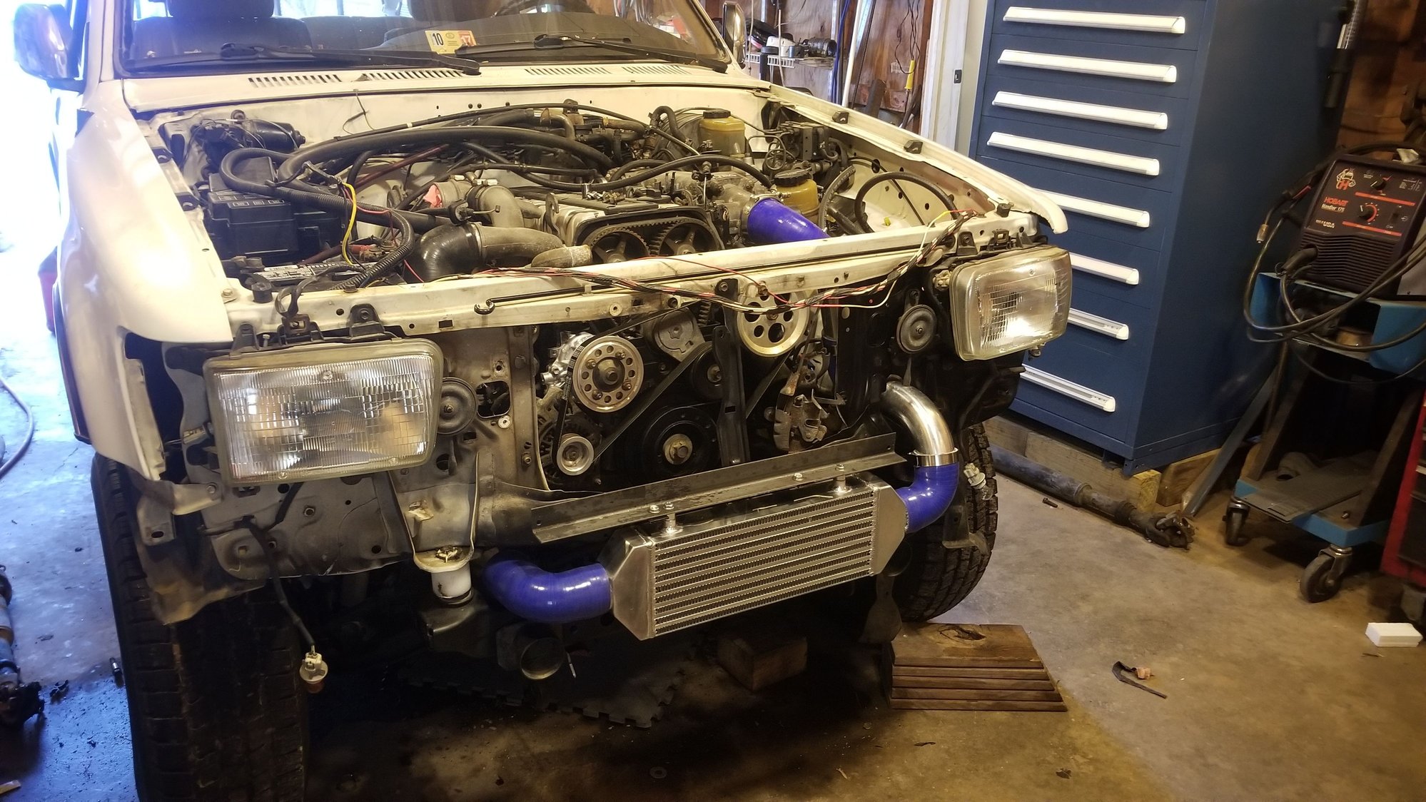

Final hole just barley missed the inner fender well.
The tricky part here was getting the piping yhrough the radiator support without hitting the inner fender well. Measured and layed it out 3 times to be sure before hitting it with the hole saw. Luckily came out perfect without an 1/8" to spare.
So i had an idea on where i wanted the intercooler. Roughly put the front bumper on did some measurements and found this on ebay. Built a quick and easy bracket for it and thier it sits.

Once intercooler was on with bumper and tag over it i didnt like how much of the intercooler was blocked so i orderd the biggest one that would still fit exactly where i wanted. Just a couple inches longer. Every little bit helps
I redid the bracket but changed to a piece of angle as well for my power steering cooler to bolt to

Here you can see power steering cooler bolted up above the intercooler as well as the elctric fan. I really do not like the plastic mounts for the fans that go through the radiator fins and press the fan against it. So i mounted to the core support instead. Physically and cant go anywhere and the bracket helps keep it blowing against the radiator.

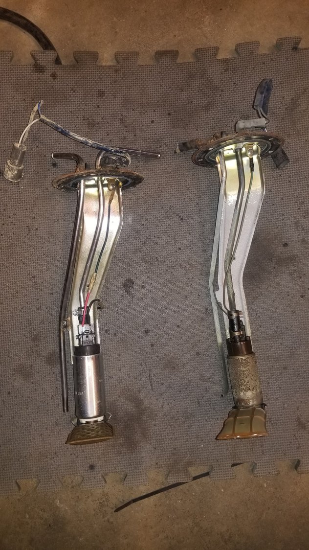

Stock fuel pump on right, walboro on the left
Since everything i do is bymyself crawling around the garage floor i decided i was NOT dropping the gas tank. So i used a 6inch holesaw to get to it instead. Far far eaisier and quicker
Cureently i sealed the metal edge with a hard set epoxy and then weath stripped a piece of aluminum over it. Pull the carpet back and you would never know it was thier

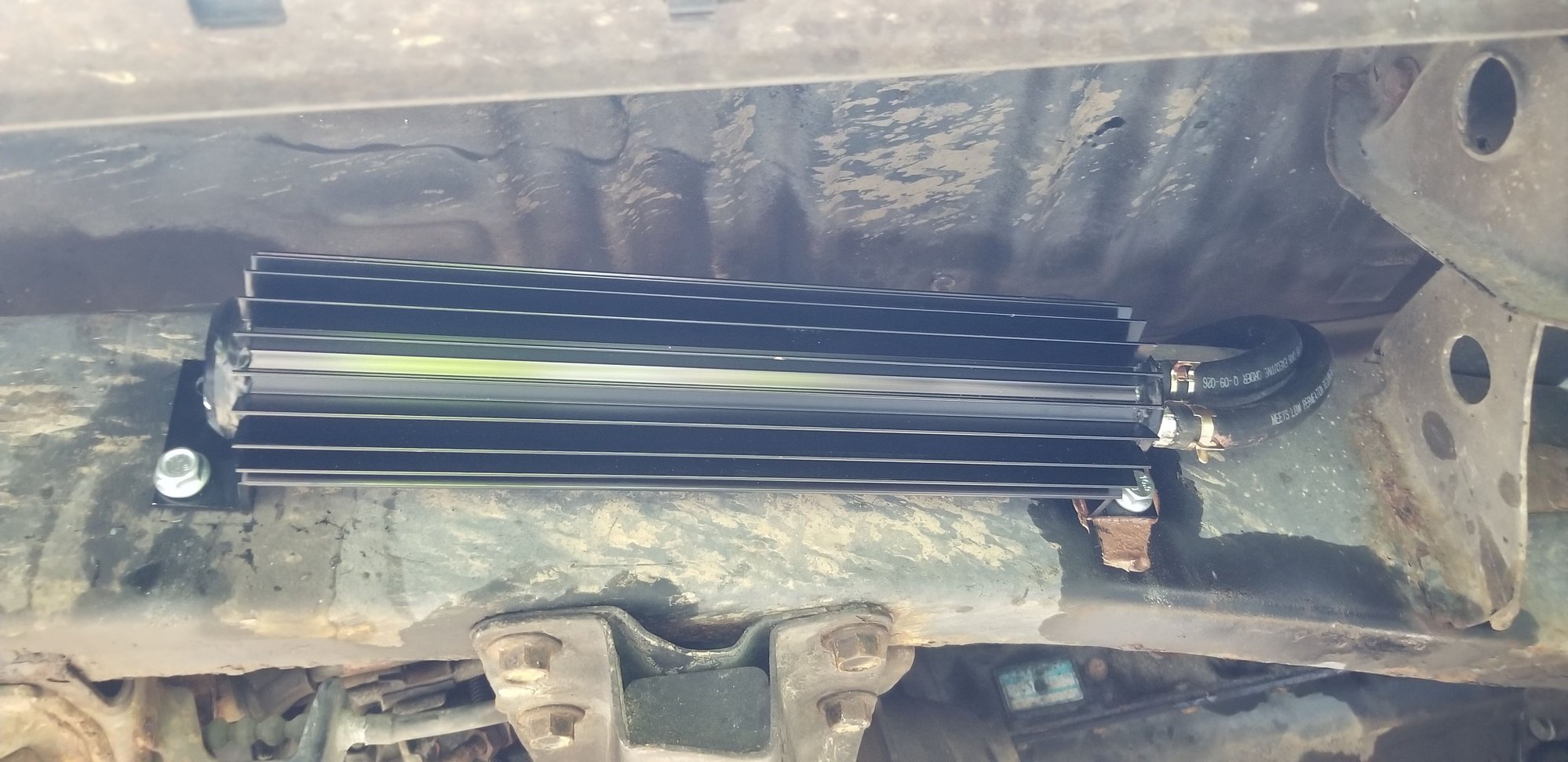

New transfer case cooler. The stock one was directly in route of where my exhaust needs to go and the stock hoses were to short to put it anywhere i liked.
I cut the factory flare fittings off with a cutoff wheel. Sanded and cleaned up the factory tubing before i put the compression fittings on.
Picked these up from hydraulic shop. 10mm compression to 3/8" ID hose barbed fittings
Stock tranfercase cooler

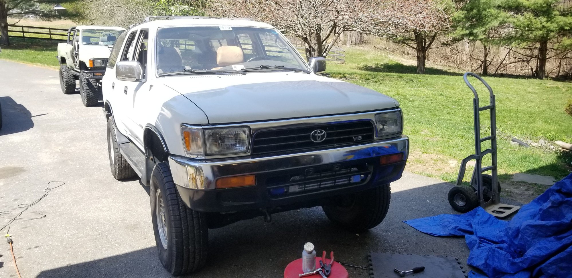

Front end completly assemnled finally.
The lower plastic valance to a good bit of grinding to clear and rubbing spots against the intercooler.

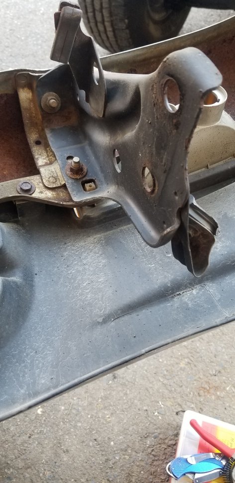

Here are the plates i made to bolt the bumper up. Just a plate with drilled holes to compensate for the body lift. You can notice they are off centerd. I did move the bumper forward just a hair to help with clearence on intercooler.
So the bumper did take slight modifuing to go on. Cause of the intercooler but mainly the body lift. Unfortunately i do not have a after pic of what this bracket looked like whenni was done in order for to go on. But about 1/4" below each hole i drew a straight line and had to cut off a chunk of the bracket in order for it to get to its stock location.

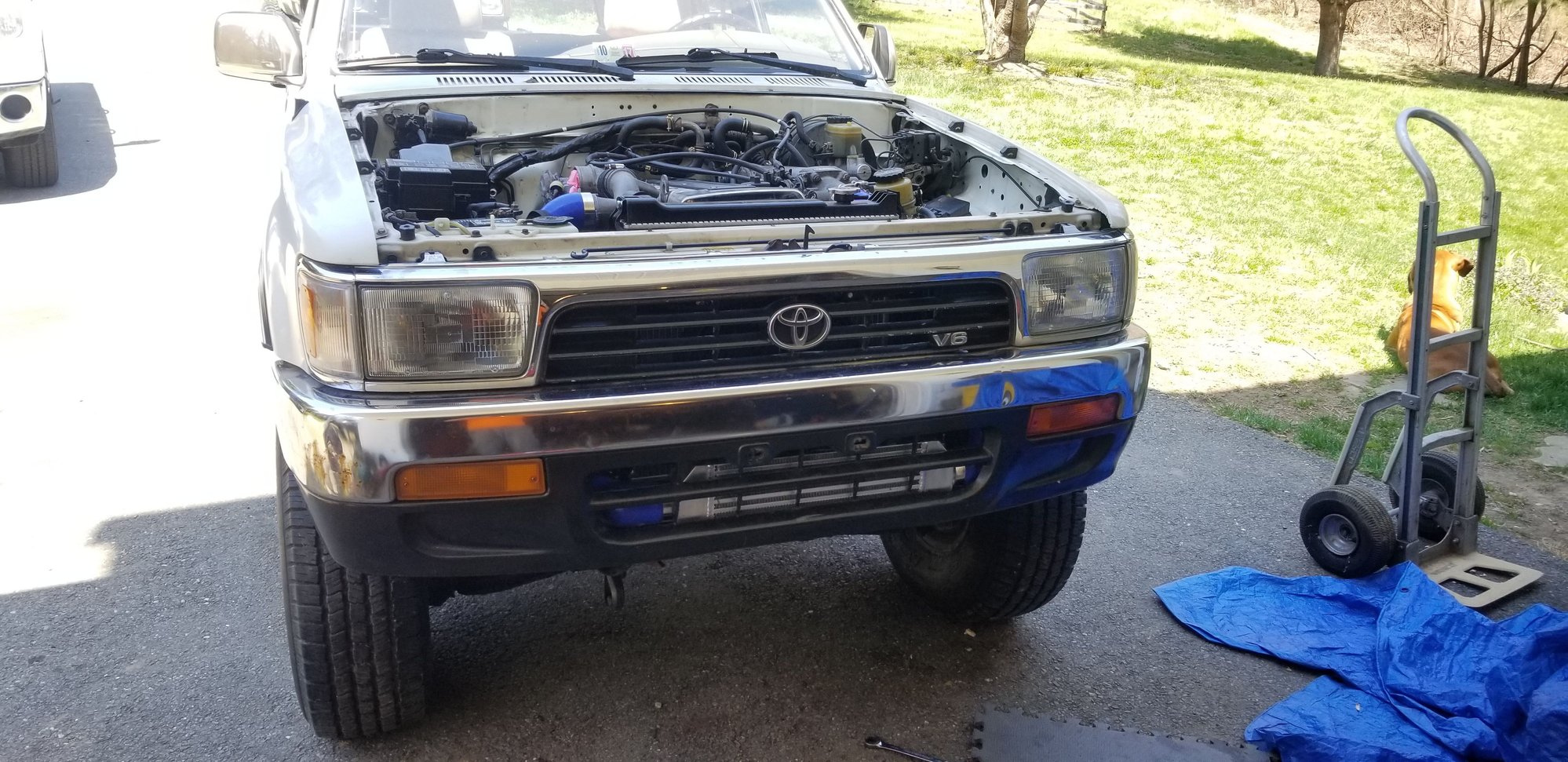

So this is currently as it sits 4/22/18.
Almost done, still have a little tig welding left in order for the top radiator connection to look good. Will have pics up and what was done when i do it. I did run a vacum line from the intake plenum to the stock vacum cannister. Started it and put it in 4wd and it actually actuated and worked lol. One more check off the wiring harness job.

Old Oct 27, 2018 | 09:00 AM
  #38
8784 runner's Avatar
Community Builder
Joined: May 2010
Posts: 415
Likes: 6
From: Anne Arundel,MD
Since i removed the factory transfer case cooler i replaced it with this run. Fits very well against the frame. I was gonna build a small guard for it but i do not intend to whell this through the woods. I don't think the tire will kick anything up enoguh to damage it going down the road
