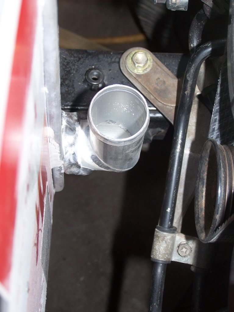

Afco. 2 1" cores. I think those are about the same dimensions. I paid $125 for it from a local race shop. I had the inlet and outlet modified to a 90 degree bend so the rubber hoses aren't and issue.

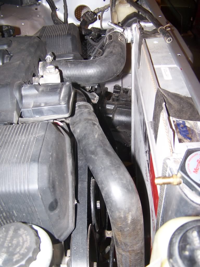

Did a few more things tonight.
The fan comes really close to the front of the engine. This is why careful planning is necessary if you want a puller fan.

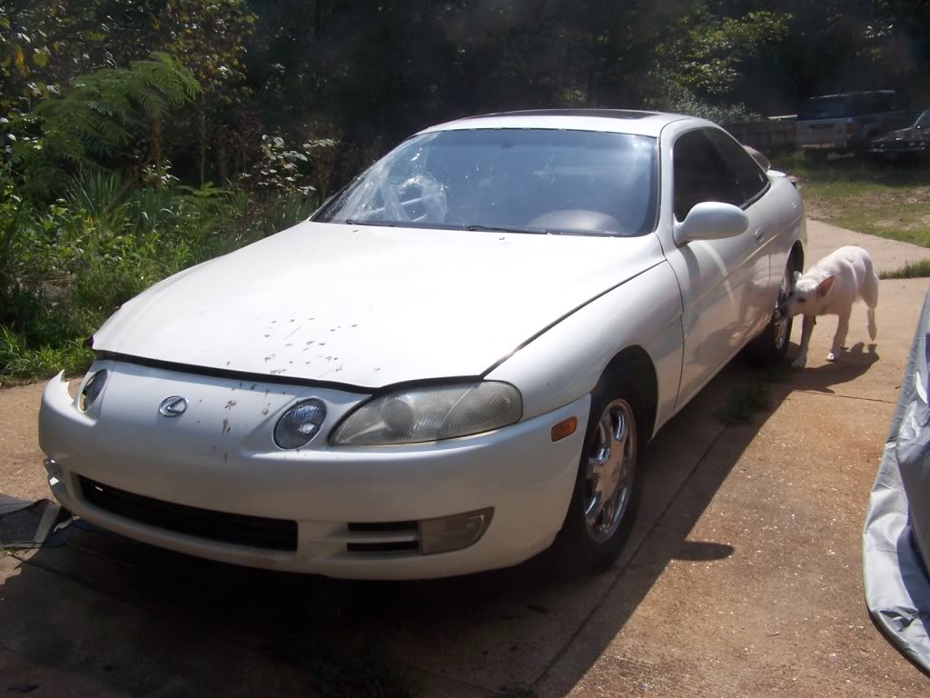

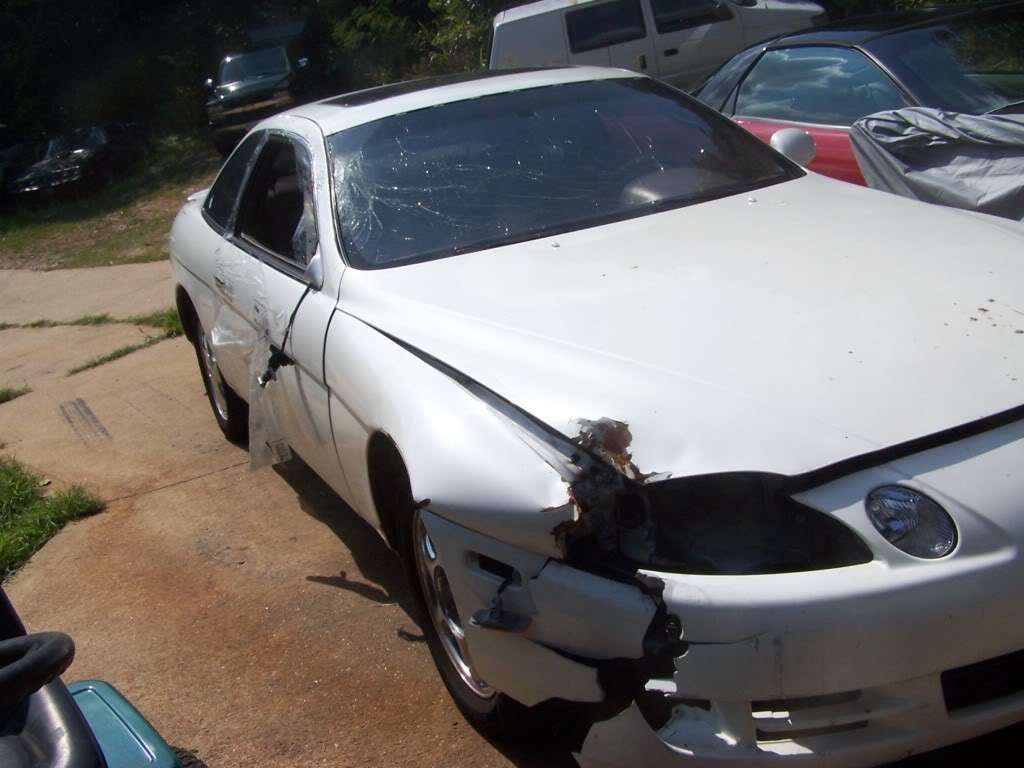

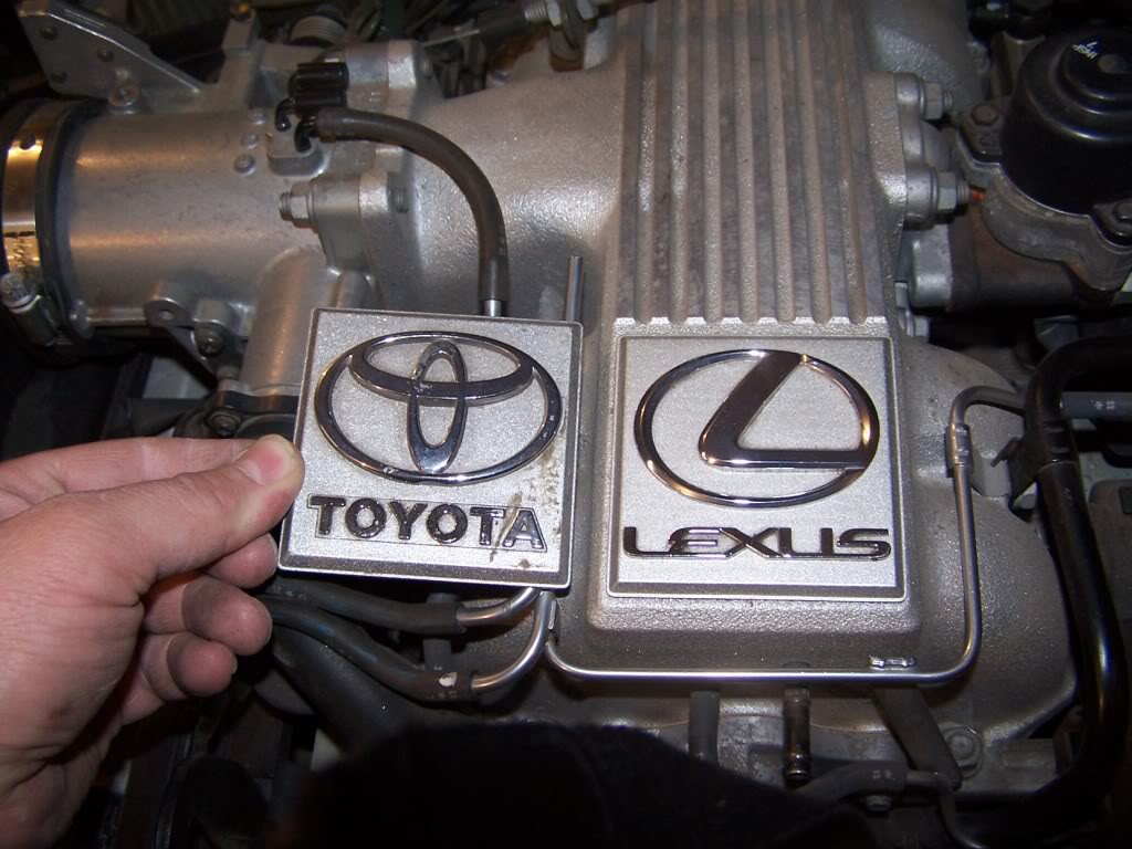

I got a whole upper intake from a JDM Toyota Soarer (Its what the Lexus SC400 is called in Japan). I bought it mainly for the factory EGR bypass stuff the the Japanese engine doesn't use. It also had a Toyota emblem instead of the Lexus one.
Which one do you guy think I should use.

Use the toyota one , if not sell it to me ill buy it .
I wonder if I can get that toyota emblem by itself from toyota

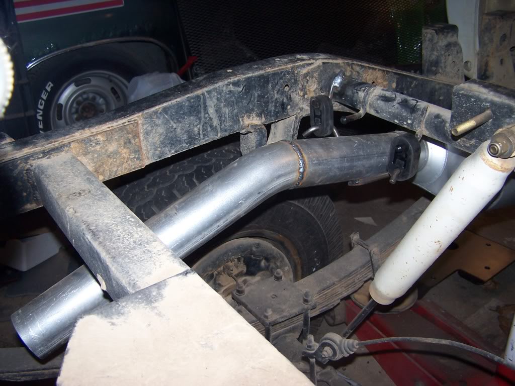

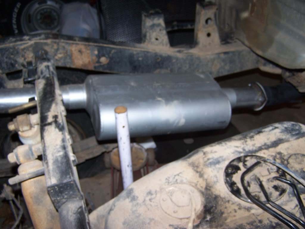

Finished the exhaust. I found a new cheap 40 Series Flowmaster on Craigslist instead of using the Borla I had. The Borla was one of a set and I did't really want to use a high dollar muffler on a trail truck.

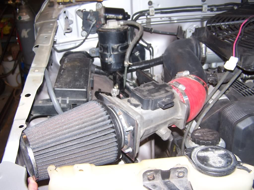

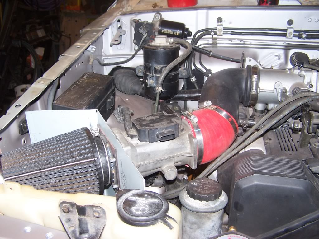

Going with a K&N open filter for now. I'm not a big K&N fan or even an open element fan because I think they allow too much dust to enter the engine but the factory air box was going to be a headache to fit the way I wanted it to. That will be a later project.

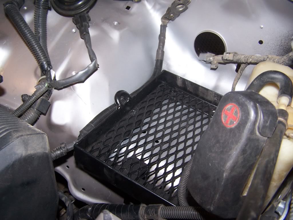

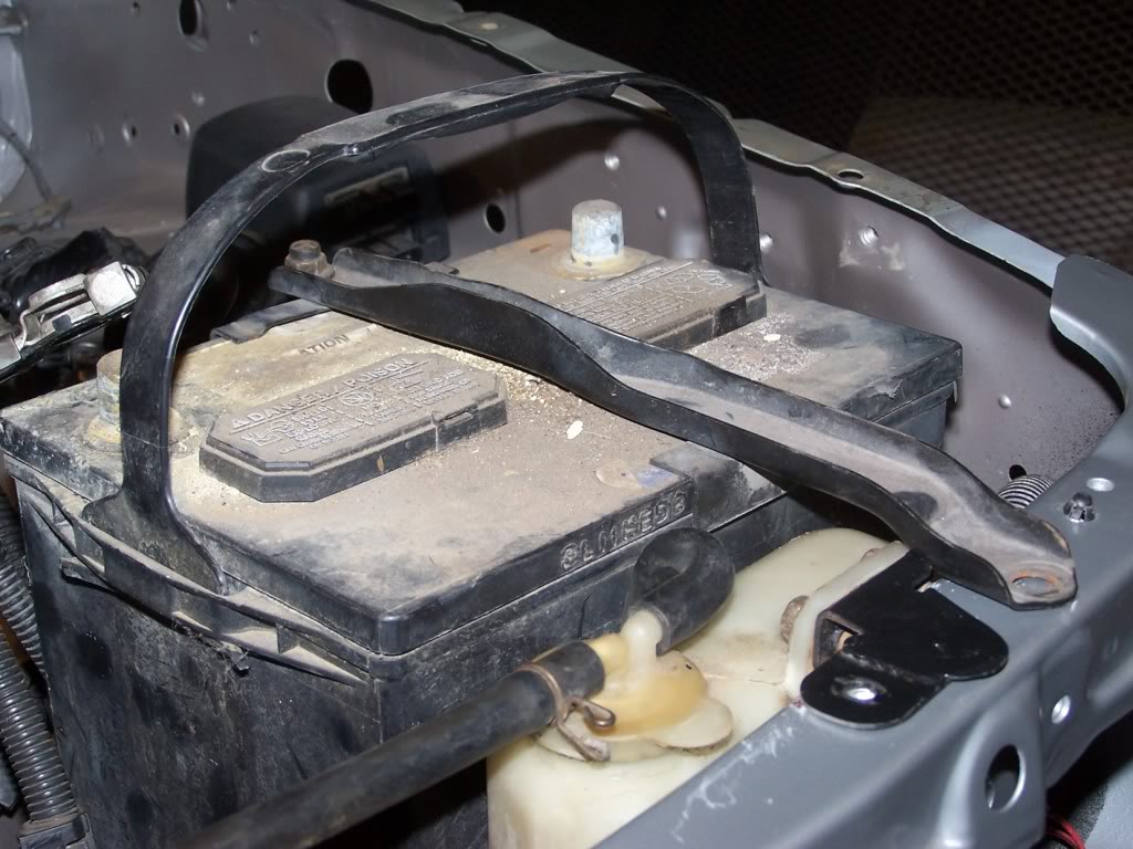

I made a battery tray for the drivers side. I made it so I can use the factory clamp.

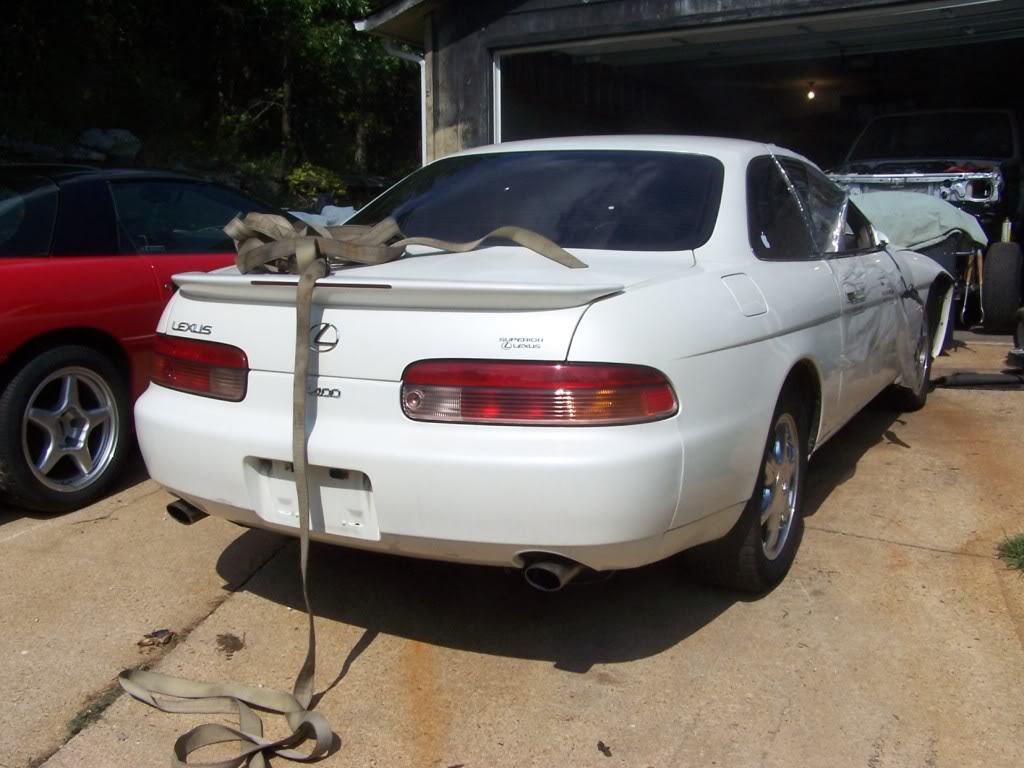

Its been too damn hot to work on my truck lately but I did pick up another donor for my next swap - with a 1988 4Runner.
This one is a 1995 $700.00 - 200k miles but its been the same owner since it had 60k and I feel confident that they took good care of it. It runs great. I'm not really ready to start it yet but the deal was too good to pass up. besides, I know exactly what I need now so I can part it out and get rid of the rest instead of holding on to it.
