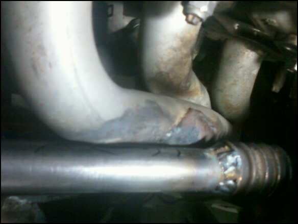

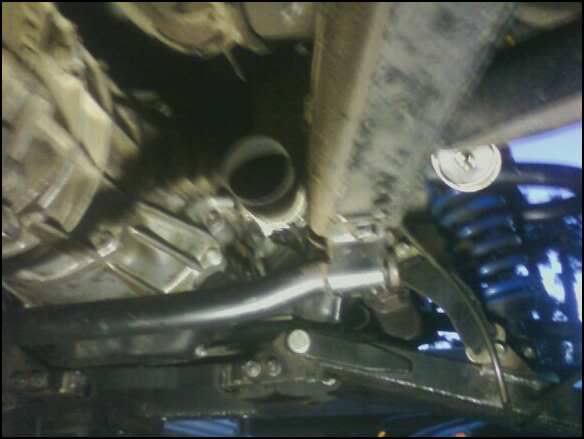

The hardest part of pulling my headers off right now is removing my steering shaft and that's only cause mine is wedged in there from making it about 1/16" too long. Other then that I can pull the headers on and off my truck in nothing flat! I'm guessing the inner wheel well or something is what you guys fight with that makes it so difficult? I don't have that so access to them is a breeze thru the wheel well.
Also, my headers clear the slave and fork on the pass side with no issues. I did wrap them with header wrap to try and keep the heat down around where the rubber boot for the fork is and the boot on the push rod of the slave cylinder though.
Fitment wise, I did cut the outlet on the pass side and rotated it a little to index it away from my frame rail cause stock it rested right against the frame. On the drvr side I had to put a "custom dent" in the forward tube to clear my steering shaft but I think that's cause my truck is built around a 3" body lift so the steering shaft isn't running thru where the stock location would be.
Overall though the headers were by far one of the eaiser parts of the swap... I do still need to take it to the exhaust shop to have a "Y" pipe built to connect the headers to my tail pipe though.
