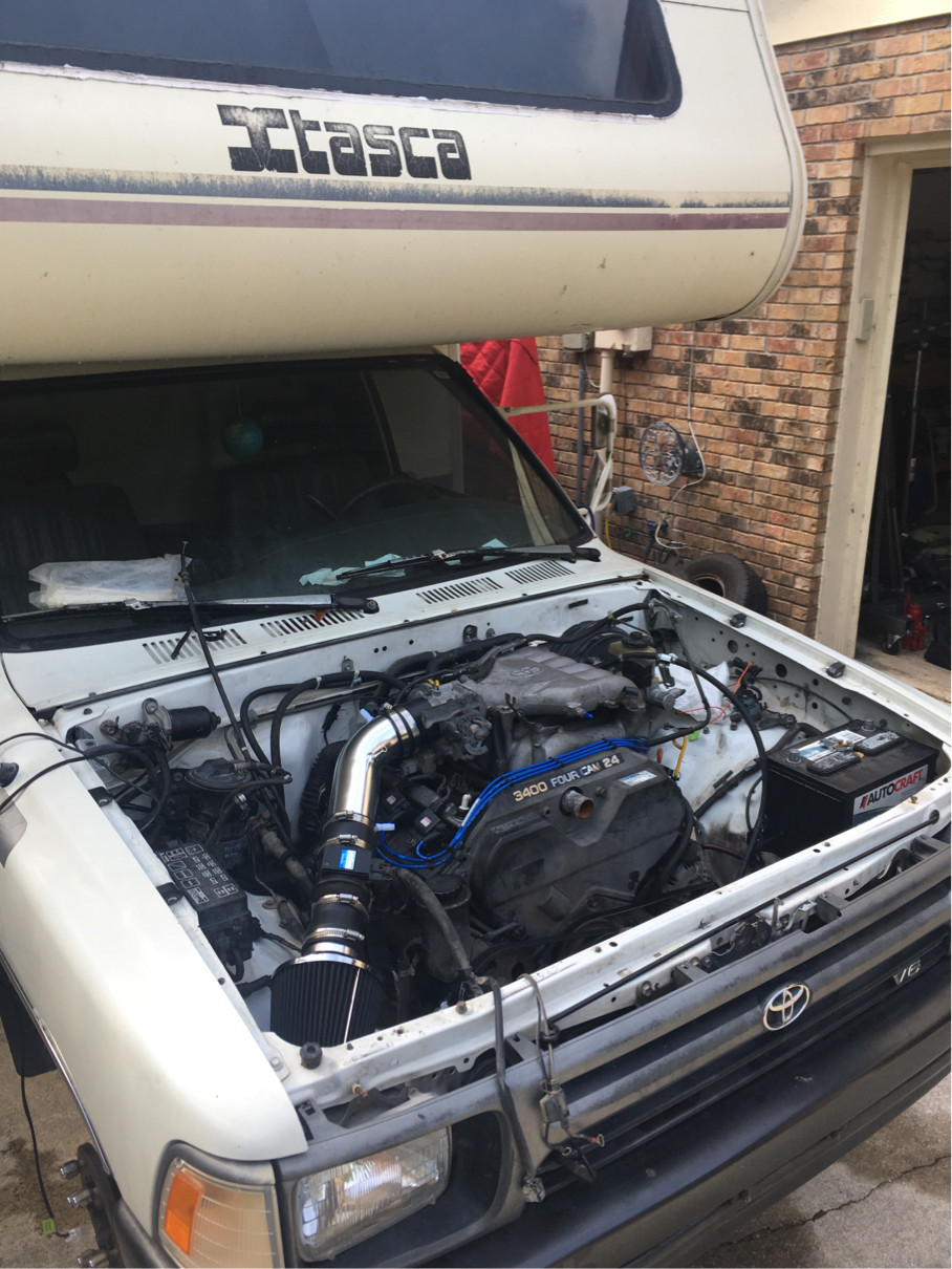

Alright guys, onto the final boss of my 3.4L swap, heres a pic of her sitting my in my 1992 Toyota Itasca, originally had the 3VZE, i yanked it out and put a motor from a 1996 T100 in her place.

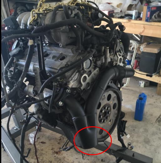

Problem: I used the off-road conversions crossover exhaust pipe, this crossover pipe drops right down on top of our shift linkage on the driver side, so it has to move or we have to re-work the linkage around it. H
Looking closer at it today we've determined if I can get this pipe to bend about 2 inches towards the passenger side we can clear the linkage and drop right into a nice spot to run the rest of the exhaust.
Issue is, how can we bend this 2.5 inch mild steel pipe with it still in the truck? I sure as hell don't want to take the motor back out to do it... heres the part of x-over we need to bend
Talked to a few exhaust places today around town who said they might be able to heat it and bend it but it might crimp a bit, also might be able to chop it off further up and put another pipe on it that could route around the linkage. It's pretty damn tight in there.

Its not that hard to cut the pipe, cut it again at a bit of an angle, weld the two pieces back together without the small slice you just removed, repeat. I had to do that 5 or 6 times to get it right. Each time just tac-weld the pieces together with two little tacs so you can easily undo what you just did, but it needs to be enough to hold it together for mock-up fit. Sometimes, you need to cut the little slice out and rotate, tac back in etc.
Yes, I must have set and removed the engine a/l 7 times getting the x-over pipe mocked up. Once we had it right, we removed it all and then finish welded it.
