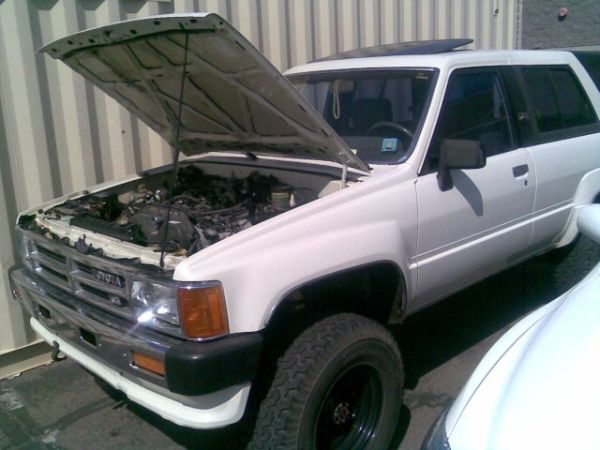

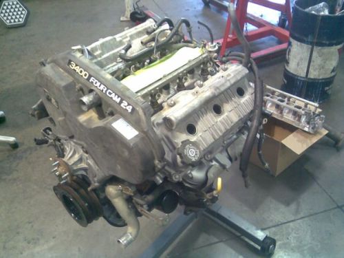

Started my swap last week and thought I might show a few pics. Engine is from a 2000 4runner auto, and the ecu is from a 98 taco m/t. That was fun to re-wire! This engine has only 45k miles, but the sad part is it sat outside for 5 years with no intake manifold. I had to send the heads out, hone the cylinders and clean the rust off the rings. Luckily, the crank was pefect

Looks good so far, what do you have planned for the hood? Hood scoop?

I already installed a 1.5" body lift from 4crawler. Very nice kit. I wasn't sure about a body lift, but I can barely tell a difference with the small lift and the hood closes nicely.
