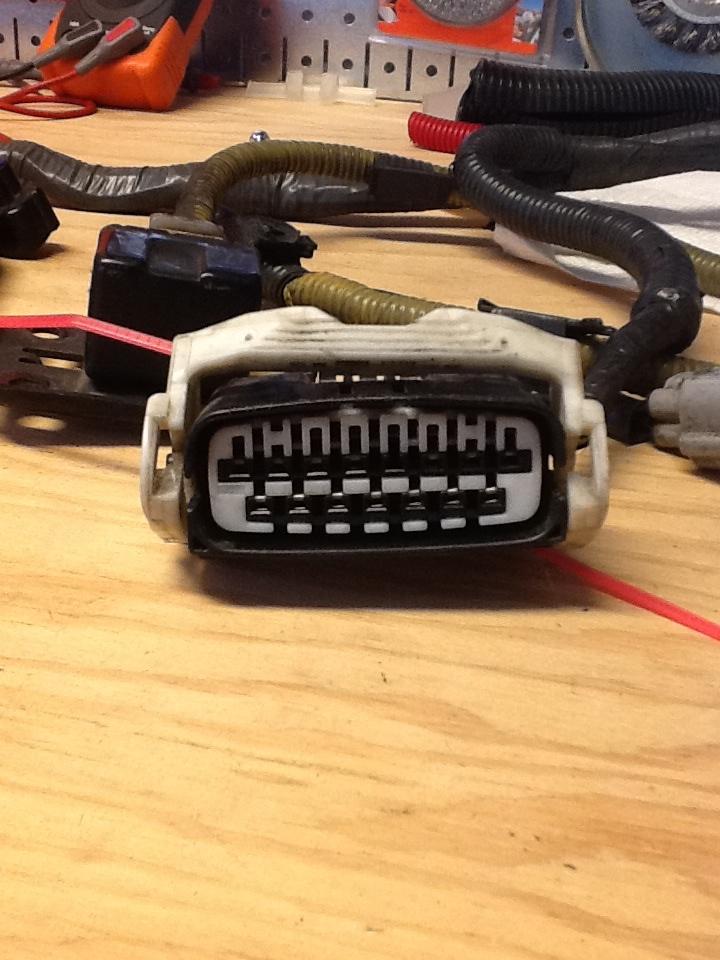

Here's the problem that I need help with from Yotatech. I traced the wires from the donor wiring but, I don't know where this plug goes:
http://s955.photobucket.com/user/Do0...92b65.jpg.html
This plug attaches to a sensor in the engine bay and/or in the trans. I realize it's a shot in the dark that someone will recognize this plug but, I thought I would take a shot. If you don't recognize the plug, can anyone provide a resource for a wiring diagram for a 2000 4 runner?

Fixed the image for you (use the "IMG" tag from Photobucket):

http://techinfo.toyota.com/ will have all the PDFs you should need, but you'll have to spend the $15 for 48 hour access.
Look through the 5VZ Engine Control or 5VZ Electronically Controlled Transmission, at the end of each section they have drawings of all the connectors used in that section with the pins numbered as if you were plugging the connector into your eye, an "X" where there is no wire, and a dot on pins that are populated just not used in that section of the EWD. If you don't find it in either of those 2, look at the Overall diagram in the General folder, then you may have to look through all the individual PDFs (unlikely, but possible).
That said, that kind of looks similar to the A/T connector for my 96 A/T 4Runner donor, I think technically they call it the Park/Neutral Switch, but basically it tells the ECU what gear the transmission shift lever is set to. Although the latch on the top makes it look like thats a harness to harness connector, so really, I have no idea, but hopefully that gives you enough info to find the answer if no one knows off hand.

The number should be on the plug at least the last 5 digits
The first ones are 90980
With the complete number it should tell you what it is

I feel like you could call ORS and they would be happy to help you. That is the large plug that plugs into the top of the newer auto trans. Unsure of it's function, but I wired my NSS to stay open all the time and I never touched that plug. Wether you are running and auto or a manual you can wire the NSS to be "open" all the time. IH1-22 on my (auto to auto swap) is the park side of the NSS. II3-2 is the wire on the 3.4 side that corresponds. I hope something here helps you?

Good information. You are correct. It looks like the connector for the neutral safety switch but, it's not. The connector pictured is at the other end of the harness from after it goes thru the firewall to the interior.

I tried that. I can't find a part number to save my life. All the other connectors have one but, not this one?
