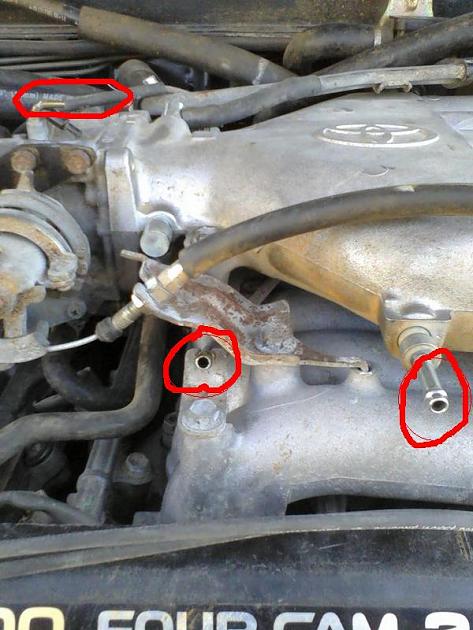

i dont know where the circled things go to plz help

On mine, the top one is capped off with a black cap just like you have on the nipple next to it. The left one goes to the black box hanging off the side of the air inlet hose, and the right one goes to 4x4.

thank you for the help right now i have a high idle with all those blocked off
