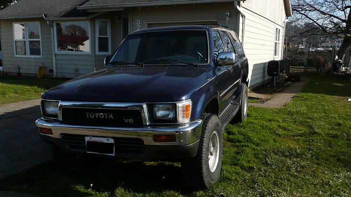

can someone let me know how to attch pics avery time i try to it says uplaod fail
Old Feb 9, 2009 | 01:33 PM
JORunner's Avatar
Joined: Feb 2009
Posts: 11
ecept for that pic
