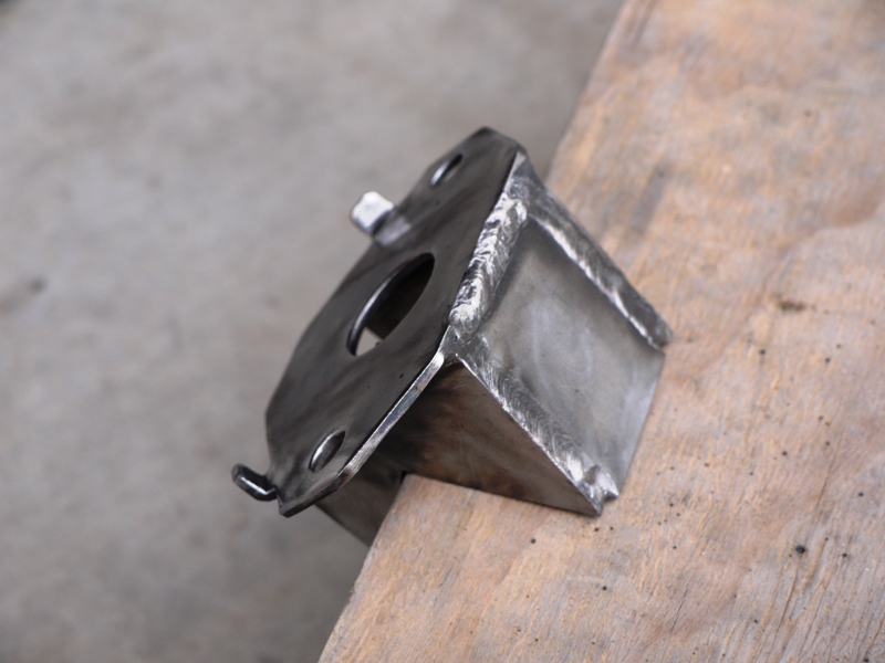

Fabbed my own and used the 3.4 mounts. Could probably had done the same for the 3.0 mounts. I just used what I had.
Attached Thumbnails 22re to 3.4 .......use same mounts??-3.4-swap-motor-mounts-wiring-connectors-001-2-.jpg
