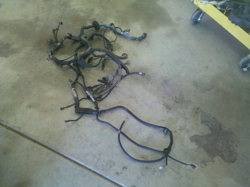

I bought a 3.4 today with 79k miles for $300.00 off of craig list. It came out of a 4wd taco that was wrecked. The oil pan,and timing cover is broke,and it is missing the throttle body. I found another complete engine for $400.00 with a blown head gasket, including the harness and ECU. I'm going to try and pick it up next weekend.
I emailed DR. Tweak from Phoenix tunining and he said he would build me a harness for $600. I dont really have that kind of money ,so i will probably try it myself. (or work some overtime).

The harness really isn't that bad. It was what psyched me out the most, but in the end, all you're really doing is splicing some wires into the body harness to run things like the gauges and stuff.
Go to the Toyota Techinfo website, pay the $15 or so per day, and download every single wiring diagram for both vehicles. Make a chart of the two plugs under your dash and find the same functions on the engine harness. Cross-reference the functions of each wire and badda-bing, you're on your way.

Well I got the doner truck today. It looks a little different than the pictures he sent me, but I still bought it for $1050. I pulled the harness out of my 4runner, and started on the Tundra harness removal. I'm selling the other 3.4 for what I bought it for $300, if anyone wants it.
