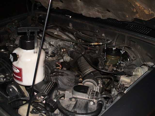

I just repacked the wheel bearings in the Runner. No real issues there. I used moble 1 red synthetic grease. All went well. Got grease all over everything so I used mineral spirits to clean the grease off the rotors.

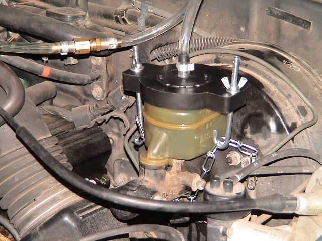

I did my first flush also yesterday with the motive power bleeder . All went good I think. I had to figure out how to attach the adapter to the resovoir on the MC.
That fluid was DIRTY. I started pulling the fluid from the MC with a turkey baster. (Stole it from the kitchen) Got paranoid because the fluid was so black that I pulled the resovior off the MC and cleaned it with a strong water spray and dried it with compressed air. Put it back on and filled it up to the top.
Attaching the adapter was pretty straight forward but I had the J hooks on upside down and could not get a tight enough seal. Once I realized my mistake I got it tight with no problem. I added fluid to the tank in small amounts since I did not know how much to use. I ended up using 2 32oz bottles of Dot3.
Using the bleeder was cool. I pumped about 15 pounds of air in it and went to work on the bleeders. I went out of order but only because I was so excited at being able to finally use this. I went DR, PR, proportioning valve, DF, PF. Once I did that, I went back and did PR, DR, PF, DF to finish off.
Once done I did a test drive. Got worried because at first the brake pedal would hit the stop (the end of the MC I guess. Its always done that...)but the 4 runner was still rolling but slowing down. I tried several times in the driveway but it still acted this way. In reverse it would stop it seemed like. I test drove it around the neighborhood and as I hit the brakes more and more, the pedal got better and braking increased. Then it started pulling hard to the left while braking. Ive felt it do this from time to time over the years. Finally it got more even and today it seems to be pretty even and stops ok. Its no real improvement from before I flushed, but at least its flushed.
What could have caused the bad braking at first? Im sure I got all grease off the rotors and none were on the pads. Maybe the mineral spirits I used to clean the rotors left a film on them and it burnt off when the rotors got hot. Maybe there was air at the MC and it finally moved elsewhere in the system. Any ideas? I think the MC needs replacement anyway. It never has stopped very well but thats another story.
I have some pics of the brake fluid flush if I can figure out how to post them.
