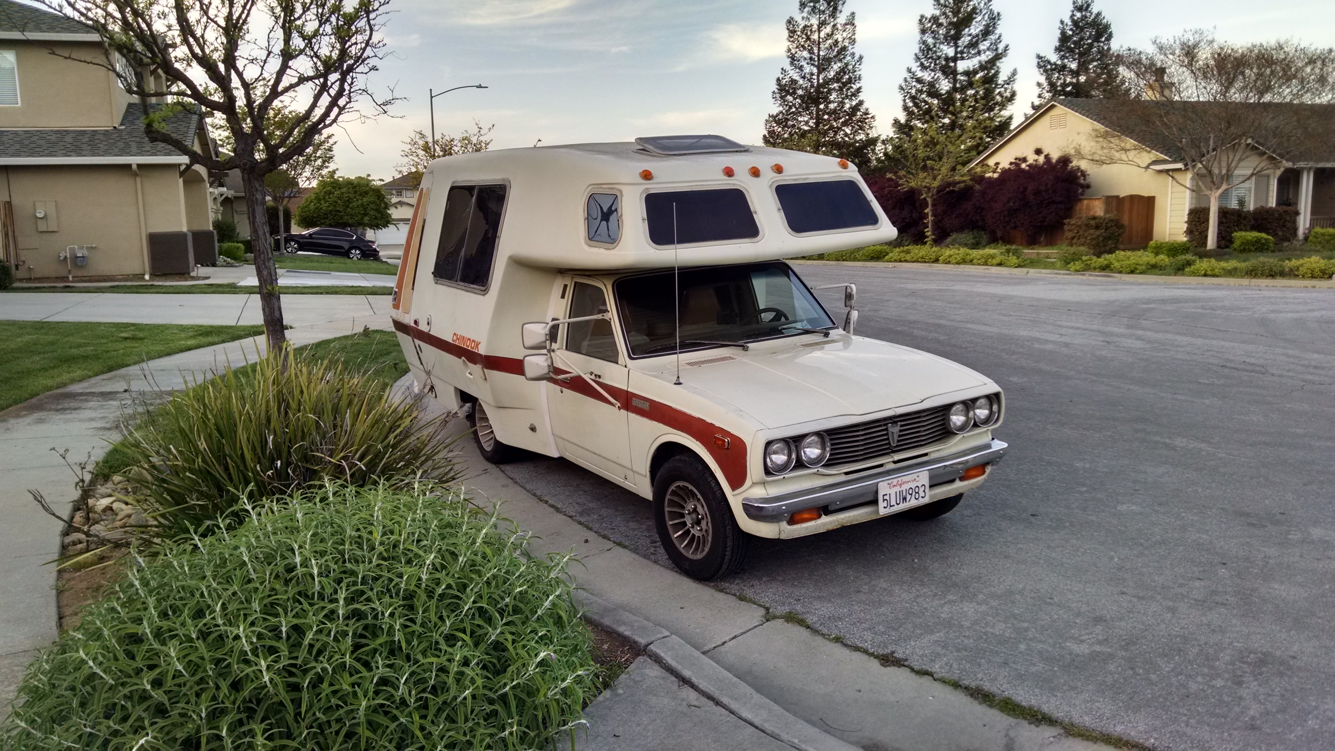

https://www.yotatech.com/attachment....1&d=1463703271
Thought I would toss a picture up.
Attached Thumbnails Suggestions wanted. 1978 Chinook-img_20160326_185710467_hdr.jpg
