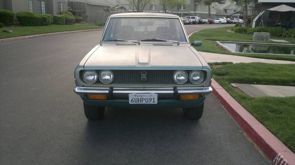

Im looking to swap the current engine of this car to a 22RE and install some turbo into it. What exactly would I need and what would it run me for a decent engine and tranny?
Attached Thumbnails 22re for a 71 Toyota Corona-3ff3i13m45i85g65j5d3v683bdae870271036.jpg

If you're looking for more power than a NA 22RE, a 3RZ-FE will be a cheaper option than a turbo. Perhaps a 4AGZE?

buy a wrecked 2wd tacoma. search craigslist.

Even with forced induction the 22re doesn't make that much power. Its a cost to performance ratio. There are better performing engines out there for less money. If you're going to purchase the complete package, its not really a cost effective choice. If he already had a 22re in there, it would be much more viable.
Just my opinion.

I just want something thats going to be easier to mod/give me more performance and power rather than the stock 8RC.

Certainly, I think a 22re is a pretty decent choice if an NA one is going to satisfy you, but if you want more power than that. A turbo is going to cost you more than a 2RZ or 3RZ and will net you basically the same performance.

Like vital suggested, search craigslist for a wrecked taco and get a complete donor. That'll cost you less in the long run than sourcing all the parts.
