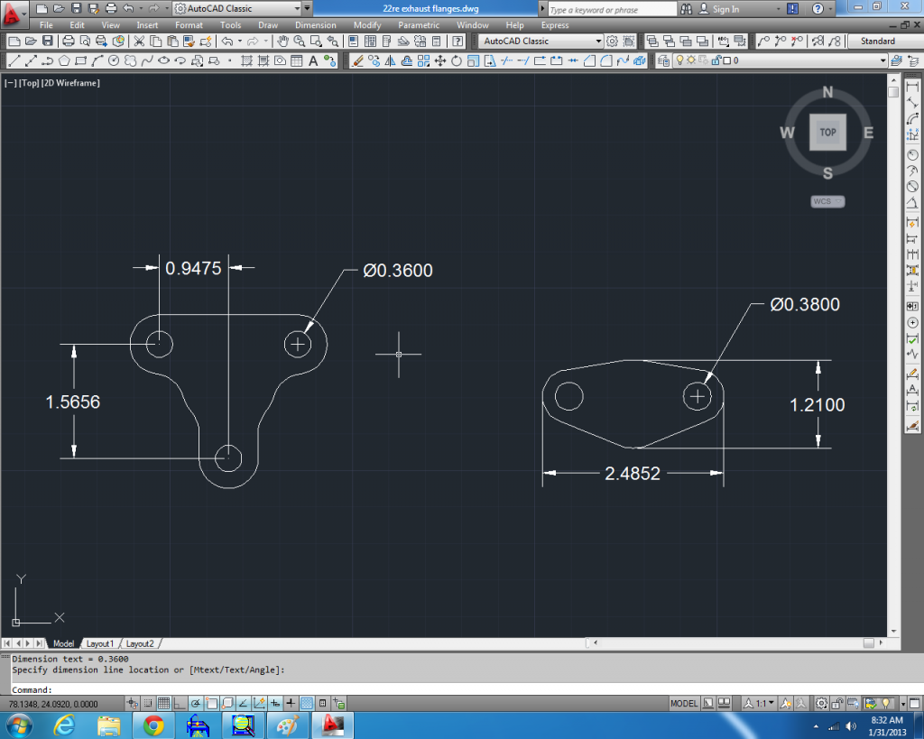

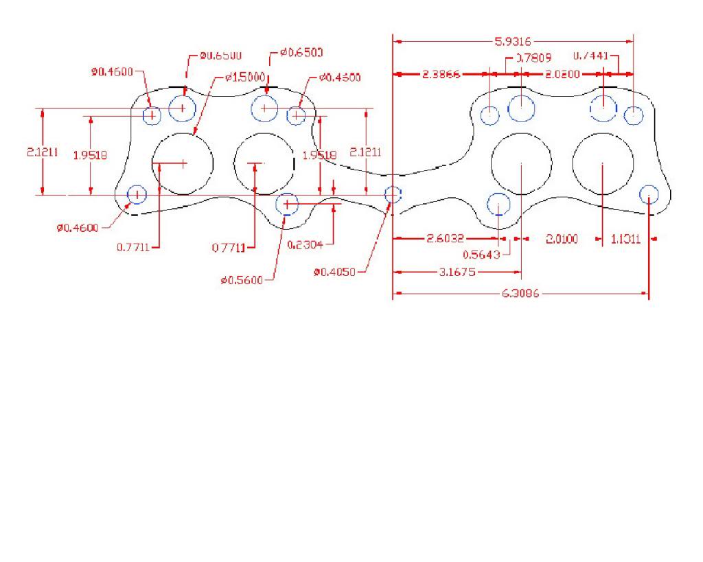

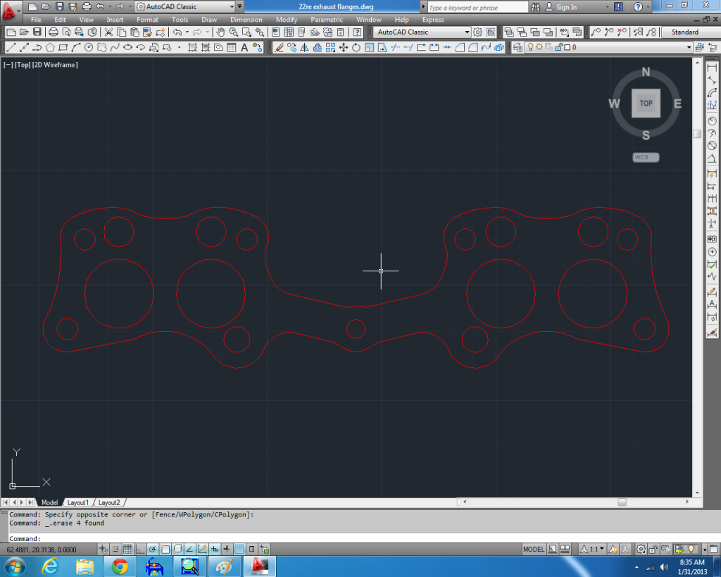

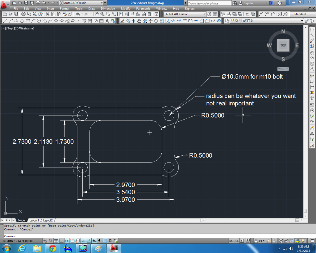

and if anybody cares i drewup some drawings for a egr block off, 22re exhaust manifold flange, and the wmgt flange off the he351ve

that well site is good, the reason i want to stay around 15 is because of boost spike. the holset im using is vgt so its unwastegated and the controller im making is manually controlled based of boost and vacuum so im not sure how fast it will react, when or if it will spike and most of the info i can find on the controllers is for diesels. so this is a fly by the seat of the pants type of deal where when its tuned it should run like a banshee but untill then i have to be carefull as the he351ve is capable of 40 psi easy
here are those flanges i drew up the exhaust one doesnt have any dimentions on it yet but i will post it later

anyways here is the drawing of the 22re exhaust manifold with dimentions
