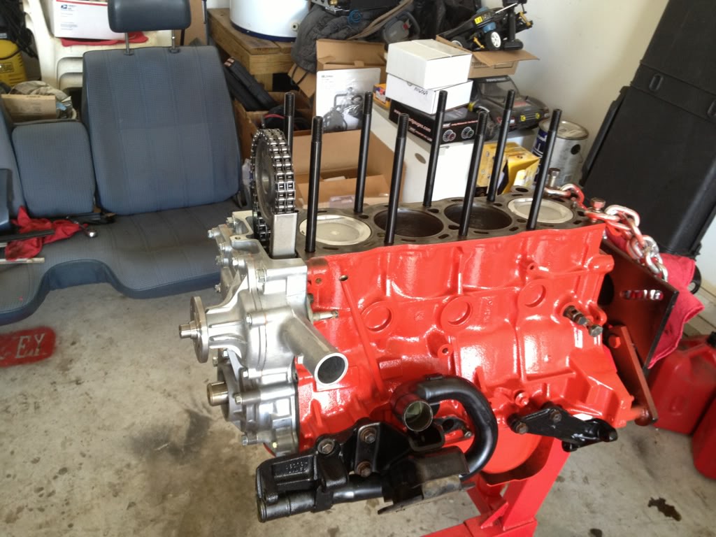

Hey, I'm actually getting pretty familiar with the rte right now, and if you can get underneath the truck and look on the drivers side you should see a little oil drain back hole( probly has a plate on yours) it's jut behind the motor mount and coolant pipe see in my photo here
It's kinda hard to see but it's tucked in there. That's the most sure way I think that you could see if the block is an rte.
