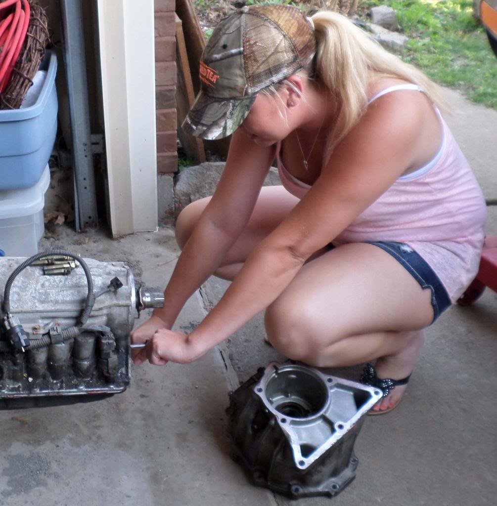

Rear output shaft of the Lexus transmission cut to length,drilled and tapping the additional bolt hole for the T100 transfer case adapter.

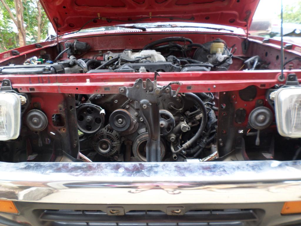

Engine set into place and beginning to wire into 4runner. I am considering using the SC400 air filter box, seeing how everything fits together.

I need to remove the hydraulic fan pump from the engine and replace with a tundra idler pulley.

I believe that the Tundra pulley doesn't have the studs for the fan on it like the LS400 has that attaches the viscous fan as well as the pulley itself.
correct?he studs
edit I stand corrected, the tundra also has the same studs, oh well. just something else to overcome.
I am trying to maximize clearance for the radiator and cooling fan, the studs on the idler pulley have shoulders that wont allow the nuts to tighten down to secure the pulley.
Take the studs out and use bolts. That's what I did.

Just use bolts. I do believe the center threaded part for the fan is taller anyway! But keep up the good work. Mine is stuck from lack of funds.
