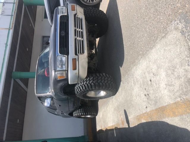

Hey guys, new to all this forum thing need help! I have a 94 4Runner 22RE, thinking of doing a SAS swap. I have a 91 land cruiser that I can use the axles, will that be alright? I was wondering is their a website where I can get a list of stuff I need to complete my build?
